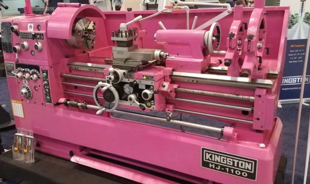

                                2K spray primer/filler works very well, build it up then sand it flush. Time and patience are the final determination of a paint job’s quality.
                                Your local auto paint store can be very helpful, if they are not, find a new one. I was in and out of the store during the priming and filling 3 or 4 times for advice. I used 2 part paint that was meant for equipment, buldozers and the like on my lathe base and my surface grinder and am very happy with the results. The shop can mix up any color you can dream of (not mine)
                                pink
