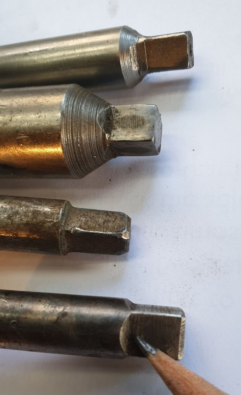

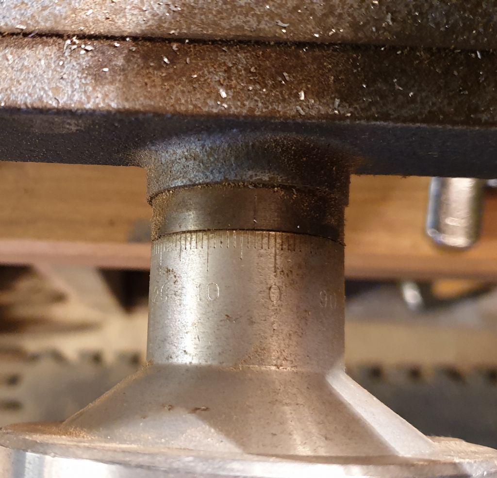

      To help me set my 4 jaw chuck I need to make a couple of chuck keys. Ive barely used my Amolco mill as yet but would like to make them as aesthetically pleasing as the one pictured above indicated by the pencil. I have a square ER32 collet block so if i can find a suitable length of bar to fit it milling the 4 flats should be ok. I was thinking of milling it with the round bar horizontal.
      But its how to add the bevel detail? I could probably make a good mess of it with a file, but was wondering how those with experience would mill the details?
      Mill the flats horizontally then set the collet block at 45 degrees in a vice?
      Mill it all with the bar vertical & then the details at 45 degrees?
      Thanks in advance!

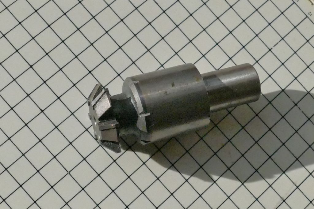

                  The original was probably made with a tool like this. I turned down the shank to Ø20mm to suit smaller collets.
                  Martin C
                  #505115
                    Yes you would need to do a small amount of grinding.
                    I used to work for a building contractors who had Monument Tools (plumbing tools) as a regular client and remember seeing the machine that they had for making keys with various numbers of flats. The work was held like in a lathe and there was a rotating cutter geared to the spindle so it took X number of cuts for each rotation of the blank

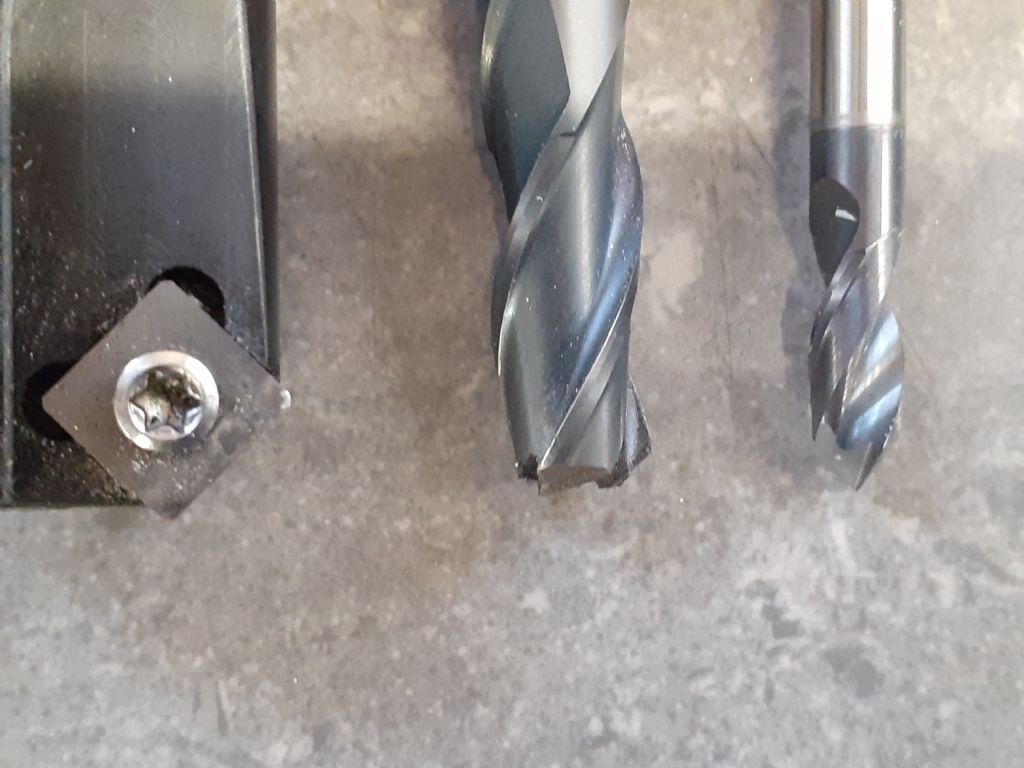

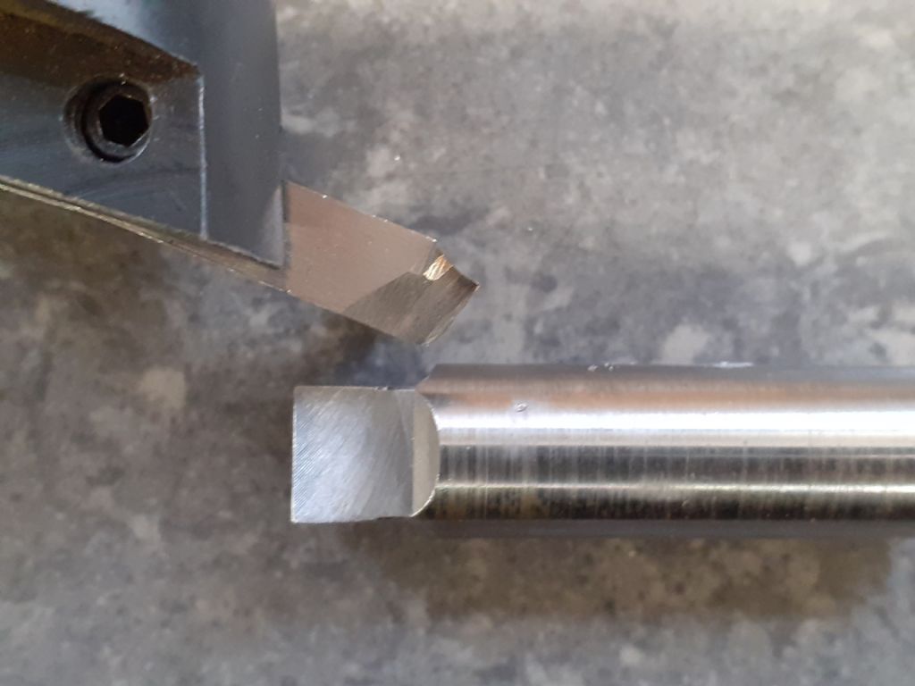

                                This is a Flycut one I just did, found a likely looking toolbit so did not bother to grind anything special.
                                A few other options would be indexable tool, blunt endmill with corners freehand ground to 45deg or a chamfer mill to do the angle after first machining the flats. Last two could also do it with the work vertical and use it to do the flats and chamfer all at one setting as the sides cut as well as the angled end..

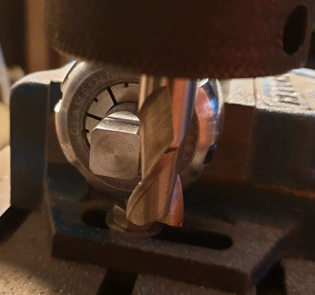

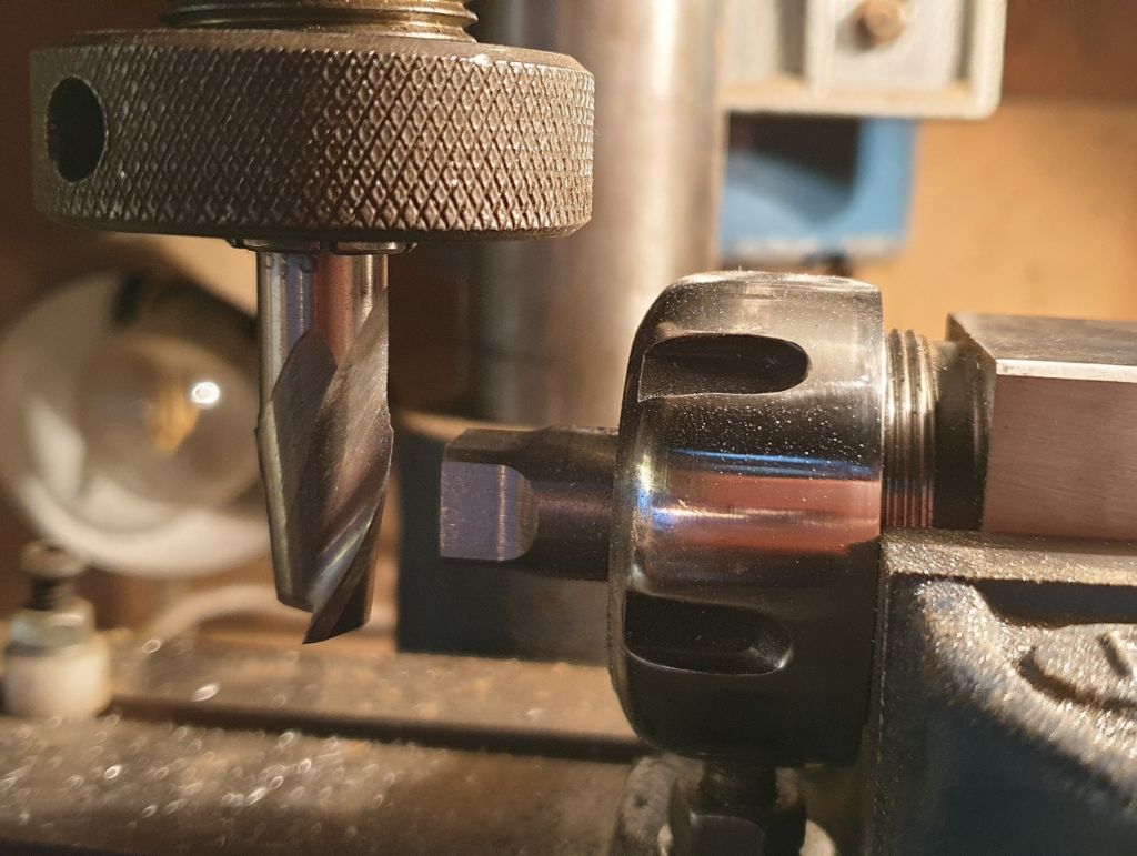

                                            Right then thanks everybody. The photos above show how far I got last night, about 1 hrs worth of milling.
                                            Its a HSS cutter, one I was given, feels sharp but might not be unused. 1600 RPM, as that's what the mill was set at. The material is 16mm dia silver steel, chips are like coarse filings. I was taking off about 8 divisions (8 thou?) at a time. All was going well enough but the further I cut into the bar I'm finding I am having to take finer cuts as the mill seems to protest as I reach the end of my cuts (the radius). On reflection I should have turned the end of the bar down on the lathe to reduce the amount of milling required.
                                            Does the above all look & sound fine?

                                              1600 rpm is way too fast for a 16mm (5/8&quot diameter cutter. It will be losing its cutting edge as you go at that speed, which is why its getting harder going.
                                              BAsic formula for HSS cutter with mild steel material is RPM = 400/diameter in inches. So try more like 600rpm or even a bit slower for silver steel.
                                              You should be able to do it nearly in one cut. Or one roughing cut then a final finishing cut.

                                                  For a start the 2-flure cutter is not ideal for edge profiling work, 4-flute would be much better or even 3-flute as a half way measure.
                                                  Say a moderate 20m/min cutting speed for silver steel with a 12mm cutter 526rpm but you could go up or down from that. Probably opt for your 325rpm as there will be a lot of cutter engagement at the end of the cut which can cause chatter.
                                                  Metric formula is cutting speed divided by diameter ( in meters) x Pi so 20 / ( 0.012 x 3.142)
                                                  I'd go with two passes 1mm each and then as the cut gets longer height wise go for 0.5mm for the last two passes.

                                                      Right I think I should stock up on a few different cutters. I just had another go and boy at 325rpm the mill and I are much happier!
                                                      Another advantage of this simple set up I found is when on the last cut the cutter comes loose in the 2MT collet it didn't ruin the work! Thing is I'm so used to woodwork cutting speeds I'm having to re learn, I shall also periodically check for collet tightness in future!.

                                                      Yes I agree with all that, in the first photo of this thread I showed 4 chuck keys, the top one is new and the worst to look at, thin, not waisted and look at the mess they made of the end! This was the second key I bought for a chuck I have, neither of them fitted either! Hence my determination to at least try and make a better job, inspired by the bottom key shown of the 4.
                                                      My keys will be waisted, what I should have done was turn the end down on the lathe to reduce the amount of milling, that will be more efficient. I will try that on the second one.
