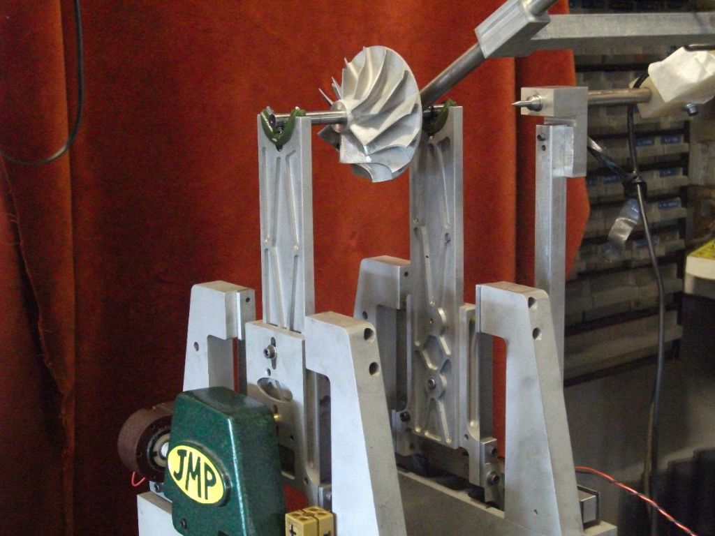

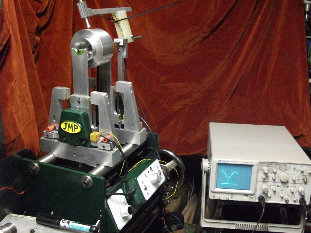

              John P
                @johnp77052
                Posted by
                duncan webster 06/05/2018 11:43:38
                I have read somewhere that the model gas turbine builders have balancing machines.
                All you need (all!) is two bearings set on force transducers and a means of capturing the data.
                Hi Duncan
                Read through your interesting article a few times ,still trying to
                get to grips with it.
                Adding weights to simulate the motion gear and then balancing the
                wheels as a set seems to be what you wish to do.
                The gas turbine balancers are a much more simple thing to do as
                the objective is to reduce the imbalance to a small amount as possible.
                The photo here is my two plane balancer ,the imbalance is displayed as
                a sine wave on an oscilloscope but has no values .Balance is achieved
                by adding weight to the light side (plasticene) and then removing metal from
                the opposite side,You may be able to see some metal scraped off
                the blades of this milled from the solid compressor wheel.
                This wheel needed only a few milligrams off the front plane and a little
                more off the rear to balance.
                The pickup coils are from an old washing machine solinoid valve and
                some neodymium magnets ,the signal is very small using an op amp
                gives a usable signal ,the balancer sits on the table of my mill which weighs
                in at about 500 kg but will pick up normal footsteps on the concrete floor
                in the workshop from 12 feet away.
                Most of these balancers seem to use piezos for the sensing , have
                used them they can be very sensitive and can pick up a lot of unwanted
                signals ,the quality of bearings can have some considerable influence
                on any displayed signal and can mask the information that you need.
                Some useful reading at http://www.universal-balancing.com on this site a balance tolerance calculator and some additional balancing info at http://www.turborebuild.co.uk

                #353107

                    That is truly awesome. Notice I put an exclamation mark after the 'all'. Crying out for a write up in ME. Not clear how you rotate the disc, and is there a readout of angle so you know where the imbalance is rotationally?
                    I suspect what you have is a 'soft' balancer where you let the spindle move and measure the movement, as opposed to a 'hard' balancer where you stop it moving and measure the force it takes. I'd be interested in more details of your motion sensors as well. I've thought of using record player heads before, but never got any further than thinking

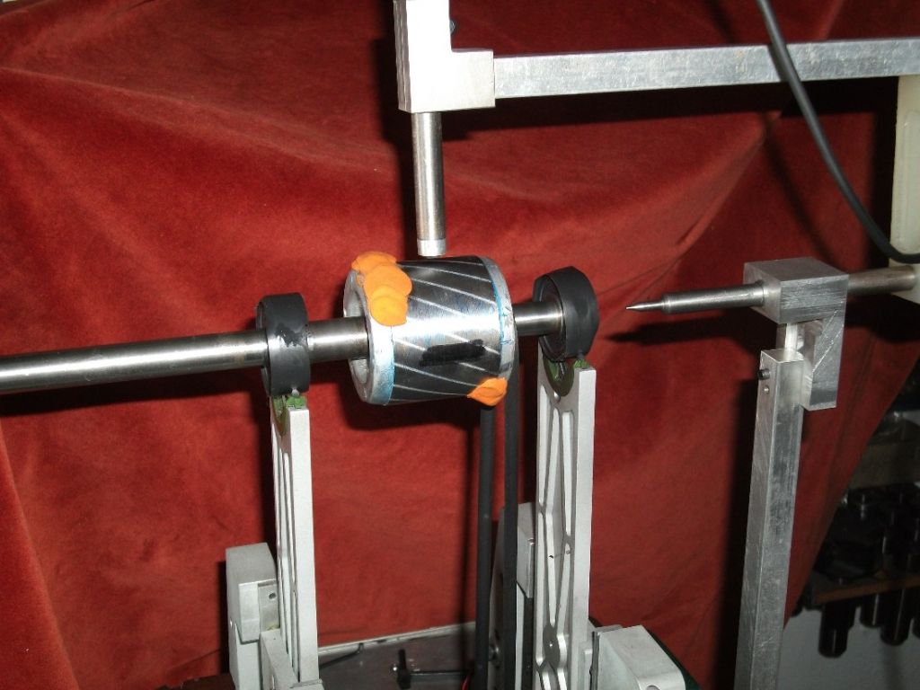

                      Hi Duncan
                      The first photo shows here this arm has a IR sensor which
                      moves in an arc of about 280 deg on the axis of the
                      item being balanced ,a felt tip line on the component
                      shows a pulse on the oscilloscope display.
                      Superimposing this on the sinewave generated by the motion
                      of the spinning component the arm is rotated to co-inside with
                      the peak or trough of the wave.
                      The rotor is driven by a small dc motor and a flat turntable belt,
                      the speed is adjustable .
                      In practice this rotor seen in the second photo would be spinning in
                      an anticlockwise direction ,the motion of the support bearing
                      moves to the right to provide a positive going wave .
                      A small weight is attached and the arm adjusted to the peak
                      of the positive wave.The rotor is stopped and the felt tip
                      mark is aligned with the sensor,if the speed of the rotor
                      is above resonance the weight will be at about the 9 o clock
                      position ,using a pointer to mark this position the weight
                      is removed and the rotor set spinning again ,adjusting the
                      position of the sensor to set the position of the wave the rotor is
                      stopped and the mark aligned again ,the position of the heavy or light
                      spot will be by the pointer depending whether the mark is aligned with
                      the peak or the trough of the wave.
                      Have sent you a PM.
                      This is as you suspected this is a soft balancing machine ,Joseph Noci
                      posted this thread which contains reference to a hard balancing
                      setup which may be more suitable to your application.
                      Joseph Noci 1 02/12/2016 13:47:16
                      A Hi-Speed Sensitive drill press.
