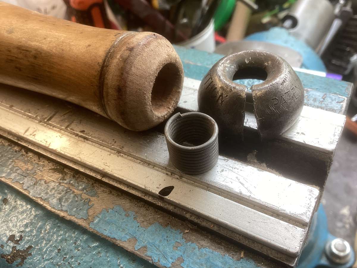

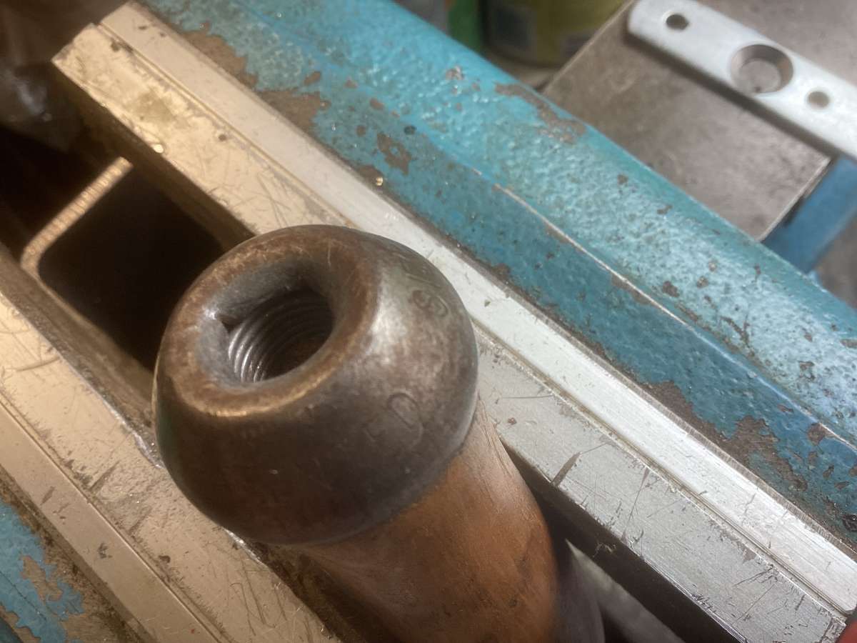

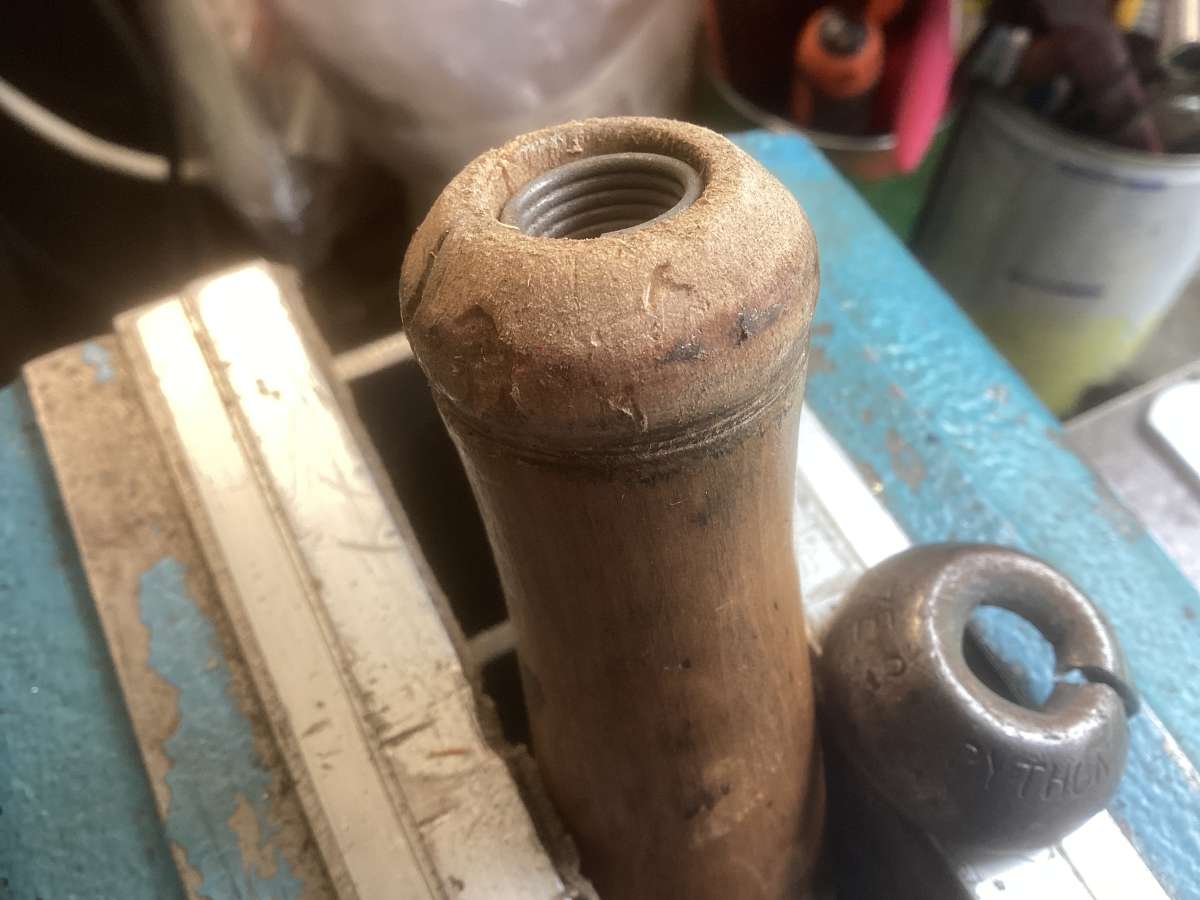

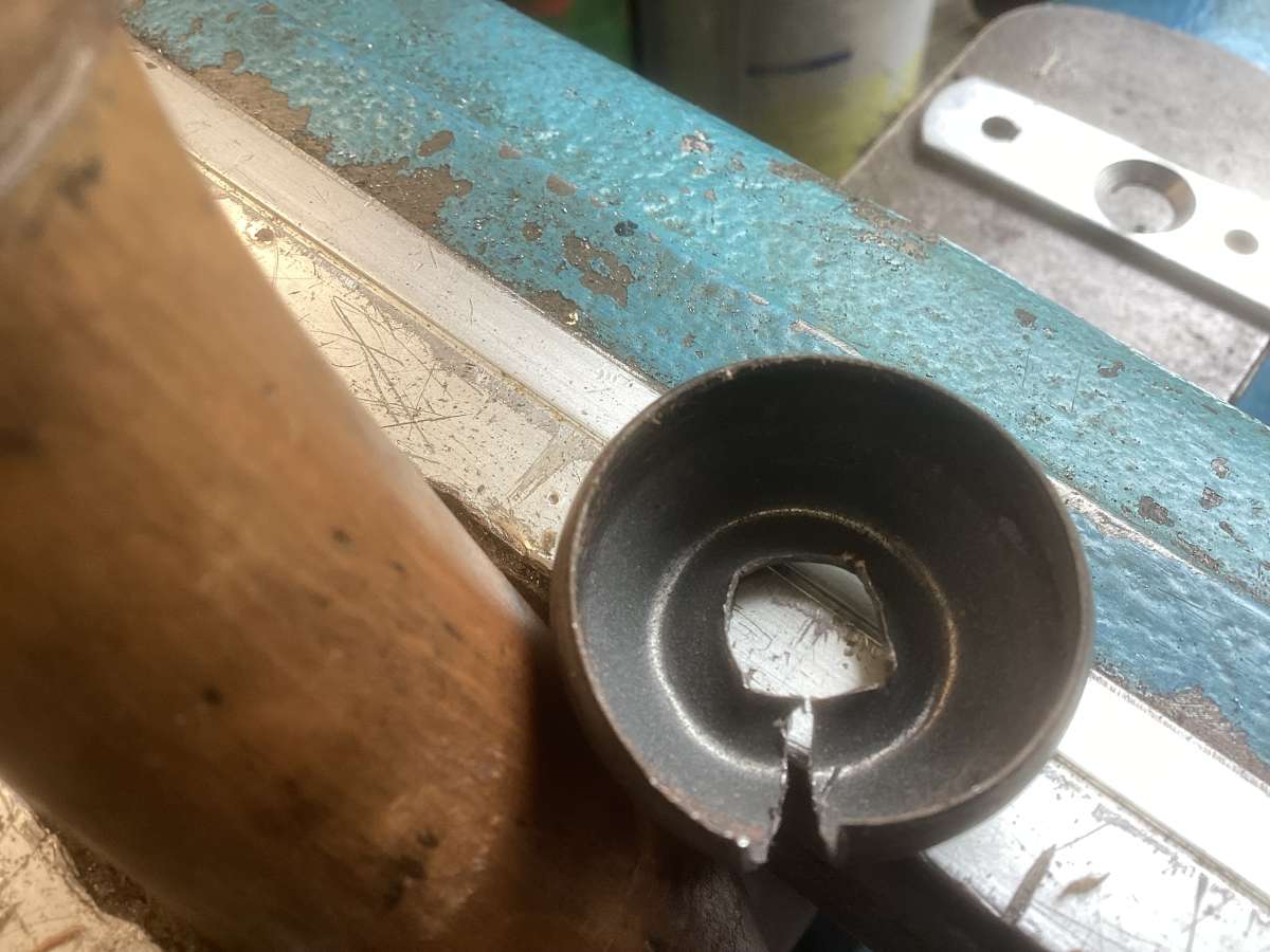

      Anyway, in the name of science I sacrificed a perfectly functional Python no.2.
      If anyone can explain the physics behind the spring in the handle, I’d be fascinated to hear it.
      IMG_0728IMG_0727IMG_0729IMG_0730
      #742544
        Very gallant of you, Sir !
        Let me have first-stab at the Physics
        Inserting the File-tang in the normal way will expand and distort the spring to some extent, and will embed it into the wood … at the same time, the spring will grip tightly onto the corners of the tang.
        #742552
          With such a short spring I would have thought wobble was likely as you are only gripping a short length of the tang

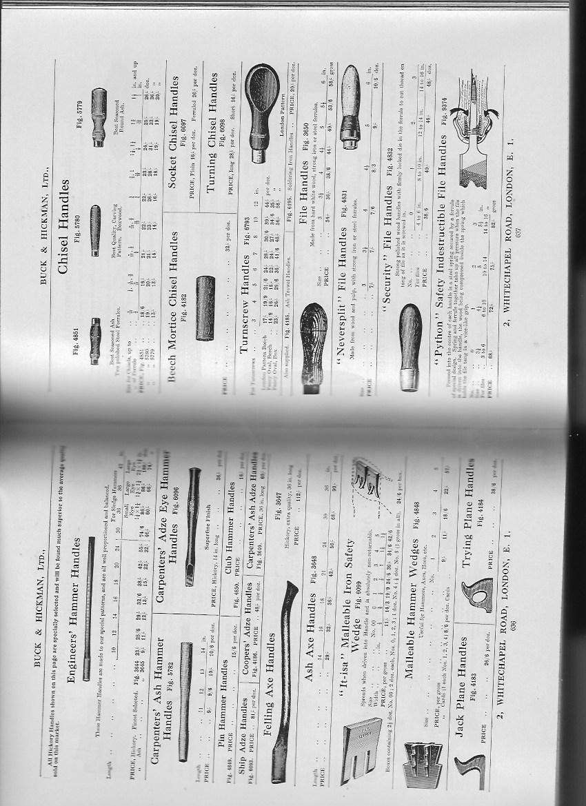

            B & H 1968Scanned Document
            Drawing of Python handle arrangment
            Paul
            #742600
              Nice find, Paul
              … just a little late to save Bill’s specimen

                            Jason
                            The main length of the tang is still a tight fit in the handle so no wobble.
                            All the spring does is grip the front end of the tang tightly enough to prevent pull-out in normal use. If you try to re-use a handle on a file with a tang smaller than the one that came out the file will indeed wobble around because the original tang will have mage the drilling in the handle too large to support the smaller replacement.
                            Even if you swop nominally identical files with same size tangs the replacement goes in touch deeper so the wood has a firm grip. Not much further maybe order of 1/16″ – 1mm (ish) by my recollection.
                            Common practice with plain wooden handles was to burn the file in by heating the tang whilst forcing it into the handle so there resulting hole exactly matched the tang. Effective. I’ve fixed loose handles that were simply driven onto a tang by burning in. Simply driving a tang into a wooden handle gives enough support to prevent wobble but can be inadequate against pull out. Hence the Python spring.
