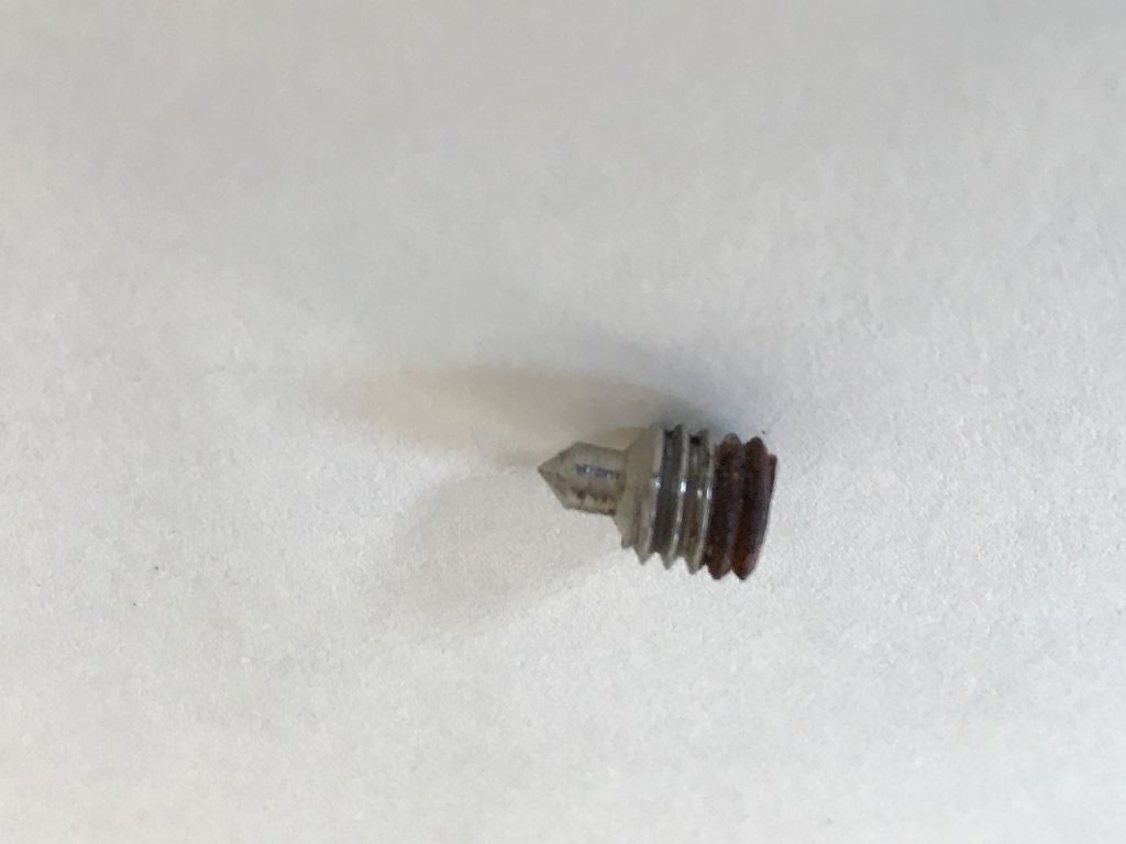

        Has this grub screw got a special name, and any idea where I can get another?
        It's thread size is M6 with a standard 3mm hex Allen socket.

          It looks like it is a special, if you have a lathe I would buy a standard grub screw and turn to match the one you have. Allen screws are not so hard they cannot be turned even with HSS tools. They are rather tough and getting a good finish may be a challenge.

            I have seen similar but with a flat instead of a point but they were made from a standard grub screw just turned held in a holder in a chuck. The holder was taped and had a 4mm hole in the back to put an Allen key through and a shoulder on the outside to give stability and position when putting in to the chuck or collet.

              The flat ended type is called a dog-pointed grub screw. As said , this one looks like a special.

                The flat ended ones come in 2 flavours, known as dog and half dog.

                  Thanks for the confirmation that it's most likely a special.
                  I'll have to machine a standard one.

                      M6 dog point grub screws here. You'd have to sharpen the point!

                        Probably a special. A transfer screw normally has the pointy end machined onto a hexagon to facilitate insertion.
                        As here **LINK**

                            There may be commercial sources for some sizes.
                            Back in the day at RARDE / DERA / DRA we used similar screws for adjustment / alignment purposes on internal workshop built lab, demo and prototype kit. These were fully blacked suggesting commercial made and there was a box or two of the supplied sizes keep in the section workshop so replacements were immediately available should one get dropped or lost.
