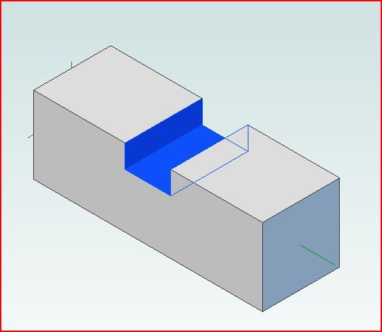

        OK I can see lots of ways of doing this – for this example a slot full width 50mm across and 30mm wide.
        The question is about speed of getting it done and tool sparing.
        So first option might be to plunge cut nibbles of say 3mm with a 12mm endmill and then tidy up sides and depth compared to slow side cutting with an endmill – would take lots of coolant and a v slow feed or say turning the part on it's side and chain drilling where one can and hand cutting the rest before endmill tidying. We'll ignore having some massive punch handy but I assume one could chisel it?
        or how about modifying the grind on a fly cutter to be a bit more like a boring bar and progressively cut with that?
        Doubtless there's other ways too.. but the question is best for tool economy (a fly cutter re grind easy enough or even ordinary twist dril sharpenings.. but endmills not so easy without jigs) and speed…..

                        Is it full depth eg 15mm thick material or a 50x 30 pocket that is open on one side or two?
                        How big is the overall part?
                        Square or rounded internal; corners.
                        Best put a drawing on teh forum as unless we know better what you are trying to do then we could all be suggesting things that won't work. Also an idea of your equipment would help. Just a simple pencil sketch and take a photo will do.
                        Edited By JasonB on 25/02/2015 11:18:45

                          Jason,
                          It is a theoretical question.. just a slot fully across a piece of mild steel bar stock, say 30 to40 mm thick, then 50mm wide and obviously longer than the 30mm slot width.
                          I happen to have a chester lux mill.. no power feed. From my own experience I know that tryign to mill such a slot with anything much wider than a 12-14mm endmill makes my machine shake. Equally a slow enough lateral feed full depth with a cheapo endmill generates more friction heat and is slower than plung cutting nibbles away. I have no experience of say a roughing end mill compared to a cheap chinese HSS one.

                                  Well if it were me I'd pop in a 12mm 4 flute cutter (though a 16mm should be OK on your bigger Lux.)
                                  Set the cutter so it is just inside one edge of tehe 30mm width and cut right across 3mm deep, repeat 4 more times until you get to just short of the 15mm depth. Move over 9mm and take another five 3mm deep cuts, move over just under 9mm and take another five 3mm cuts which will have left you just short of your finished width and depth.
                                  Now set the cutter to 15mm depth and bring one sid eof teh slot to your finished position taking 0.25mm cuts so should only need a couple to get to the line, move over 9mm to skim the bottom level and then start full depth on the other side with 0.25mm cuts until you reach your 30mm width.
                                  If size is not critical you can start on the line as a small amount of tool deflection won't be worth compensating for.
                                  If it was a bit of 15mm bar you wanted to take a notch 30×50 out of the side then I would stitch drill and then go back with a mill to tidy up
                                  Job as I understand it say 50×50 steel bar, cut 30mm wide x 15mm deep right across the 50mm width

                                          Jason's drawing is correct.
                                          Using mild steel cutting speed 100sfpm for a 12mm endmill would be 800 rpm .. nearest speed bands were either 560 or 980.. so 560rpm selected. I found that more than 0.25mm cutting depth even on a new 12mm cutter (ither 2 or 4 flute) gave rumbles and judder i didn't like although, yes, if I had to i can force it at anything to full depth. Plunge milling to 1mm short of full depth with 1mm increments to 0.2mm of the edges and then milling to final size in small increments gave me a good finish but the last cut each row again I get a lot of bounce/chatter between the stock remnants and have to peck them away. That put me off the idea of using ordinary drills to remove the majority because the remnants are going to cause lots of chatter cleaning up.
                                          To spare edmills I;ve been squaring up this sort of stock with a flycutter and taught myself to grind them so the finish is as good as an endmill – and cheap. But again more than about 0.25mm depth of cut on a 30mm approx sweep flycutter and the chips start coming off blue and quickly leads to a regrind.
                                          I did think about using my bandsaw but at 50mm thickness and the need to cut again to get the angle for the 'turn' at the bottom was going to be a really slow process for me.
                                          Cross drilling the width I did think about but didn't try.
                                          How about hogging out with an angle grinder or would that cause heat distortion?
