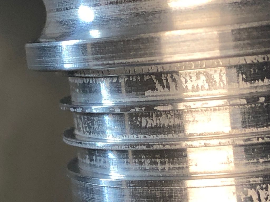

      hello all, im looking for some help,
      i just got a cnc lathe, but having trouble with turning aluminium, we did have some troubles with the machine and had to have a company come out and regrind the bed because there was some problems with it, but still cant get the ali looking any good
      anyone know what is going wrong?

          Looks like a cutting issue can you give some more info:
          Type of tool and type of insert if not HSS
          Speed
          Feed
          DOC
          Dry or what type of lubricant and how is it applied
          Grade of aluminium

                Are you using inserts designed for aluminium? Grooving inserts seem to be elusive in the sharp grades. Some type of lubricant is required for aluminium, or it tends to stick to the cutters. Some alloys machine much better than others, pure soft aluminium is terrible to work with.

                  the ali is 6082 and we always use coolant,
                  i cant get the rest of the info you need until tomorrow, but i'll get a full list of tip feed speeds etc
                  its a brand new cnc, but it did come with issues we have had to address, its far better than it was but we are still getting a finish thats no good for what we need the items for.
                  kind regards john

                    It's clearly tearing, suggests build up on the tool tip. Are you using suds or neat cutting oil?
                    I'm used to getting a near mirror finish on 6082 with inserts and just hand applied neat oil.
                    I have struggled to find ground and polished grooving/parting inserts but I would guess they would help.

                                      Hmmm, 6082 ought to be easy-peasy.
                                      The finish is poor everywhere; looks like tearing, but could possibly be chatter? First are we really sure that the material is 6082? And where did it come from, commercial stockholder or other?
                                      Insert tooling or HSS? You can turn 6082 with CCMT inserts, but CCGT insert are way better and give a better finish. I use aluminium specific inserts for parting off, although they're not polished in the same way as a CCGT insert. However, parting inserts need to have a continuous feed, preferably greater than 4 thou per rev, otherwise they can chatter quite badly. For accurate (manual lathe) grooving I use HSS tooling.
                                      I generally turn 6082 dry, except for parting off, and still get a good finish. The biggest problem with 6082 is birdsnesting of the swarf, which then dulls the finish. Note it dulls the finish, it doesn't produce the results seen.
                                      Summary: given the poor finish everywhere look for a common factor, which is likely to be the material or machine.

                                        I've contacted the material supplier, weve brought about 20m if it.
                                        We have tried machining from 500rpm to 2500 rpm using css and also fixed spindle speeds
                                        dia turning has been done at 0.25mm/rev with a 0.06 dia finishing cut at 0.05 feed
                                        All the tools are 25×25 shank WNT tools ali tips and using CCGT120404 inserts
                                        the "o" ring tool is a 2mm wide grooving insert firmly gripped in a grooving holder
                                        the radius grooves (5mm) are machined with a 3mm rad tip. roughed out and then finished with a profile program
                                        we have brought aluminium specific polished tips for all the tools
                                        we flood the material with coolant while cutting
                                        parting is terrible, material goes snotty very easily,

                                          I'm no cnc expert but it doesn't look like you are doing anything wrong to me.
                                          I would try some material from a different supplier. That way you will know one way or another if its a bad batch of aluminium.

                                            My view is your depth of finishing cut off the diameter ( 0.06mm – 2.3 thou)is too small for a carbide cutter.

                                              Rpm does not really tell us much as diameter of work is unknown. M/min would give us a better chance. Your insert maker should have speeds in m/min and DOC data
                                              Also what temper is your 6082. T6 is usual but if you have a lower number that is softer and not as nice to maching

                                                6082/HE30 alloy should be easy to get a finish on but it can age harden over the years and then you can get problems with mottled looking finishes and tearing , as said I would try material from a different supplier and hope it's not been lying around the warehouse for too long. also generating the width of the grooves with a narrower tool rather than plunging in with a full width tool will usually give a better finish under most circumstances.

                                                  the diameter is 45mm 1 3/4" its supposed to be T6 grade
                                                  just machined a previous sample (machined outside) finish is completely different and quality is excellent,
                                                  so i'm now drawn to the material as being the issue
                                                  thanks for all your help.
                                                  thought I was going mad

                                                    If the grooves are 5mm wide then the part is on the order of 70mm diameter. Speeds and feeds seem ok. What is the nose radius on the CCGT inserts? The CCGT inserts are much less sensitive to small DOC and fine feeds than CCMT inserts.
                                                    I'm with Hollowpoint, my bet is on the material, or rather less likely contaminated coolant.
