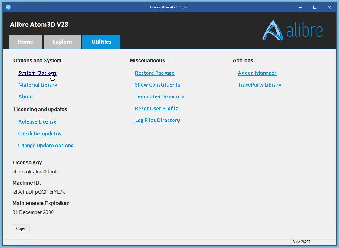

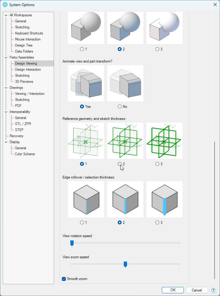

      1: Changing the interface settings to make the interface easier to read:
      To get into the settings go to the ‘Utilities’ tab, then click on ‘System Options’

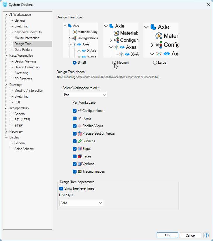

      1A: Increasing the size of the design explorer: This is under ‘All Workspaces’ (you may need to click arrow to expand all the options), ‘Design Tree’. The default settings is Small, change this to Medium or Large to scale the text and icons in the design tree up. This is especially helpful on laptops with high DPI displays.

      1B: Increase the thickness of the reference planes: The settings for reference plane thickness is located under the ‘Parts / Assemblies’ – ‘Design Viewing’ section of the options menu (note you will need to scroll down to find the setting). The default is set to 1, change this to 2 or 3 to make the reference planes stand out more.

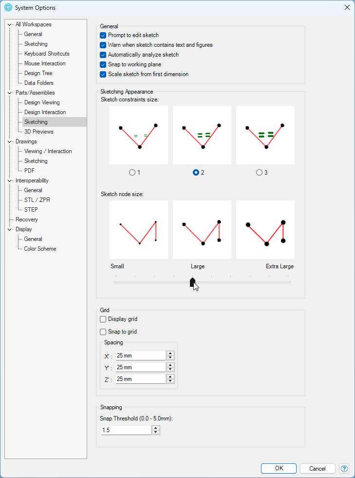

      1C: Changing the size of nodes and constraints in the sketch environment. These can be found under ‘Parts / Assemblies’ – ‘Sketching’. The node size is controlled by a slider, whilst the constraints have 3 options like reference planes.

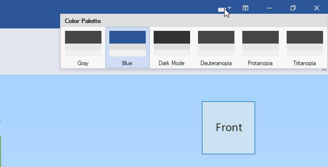

      2: Updating colour settings to make things more readable for people with Red / Green colour blindness:
      The colours for all elements in the main 3D workspace can be updated through ‘Color Scheme’ section of the ‘Display’ section of the system options menu. The default scheme Alibre uses includes red and green elements which might be problematic. The ‘Default 2016’ scheme mainly used shades of blue so could be an improvement (this can be found under the ‘Scheme’ drop down). It is also possible through this section of the menu to customise any element of the interface as needed:
      Alibre_Design_vKzmddIuuk
      The only thing the color scheme settings don’t control is the main ribbon interface. From within any workspace (i.e. start a new part, assembly or drawing), the ribbon colour settings can be found under a drop down located at the very top right of the window:
      Alibre_Design_iro9eUSz8f
      Click on the drop down then select one of the options and the ribbon colour scheme will update immediately. The ‘Dark Mode’ scheme might provide better contrast.

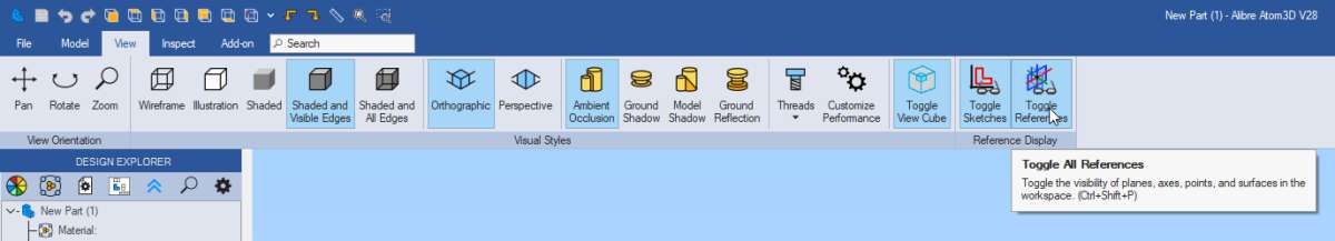

      3: The reference planes aren’t visible: This appears to be an issue with the latest build of Alibre Atom (Build 28227) that on first launch the reference planes aren’t visible. If you encounter this problem, enter the part workspace, click on the ‘View’ tab, then turn the reference planes off and then on again using the ‘Toggle References’ button located to the right hand end of the toolbar. Planes should be visible from then on:

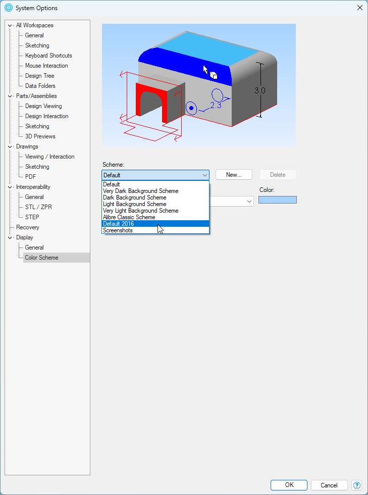

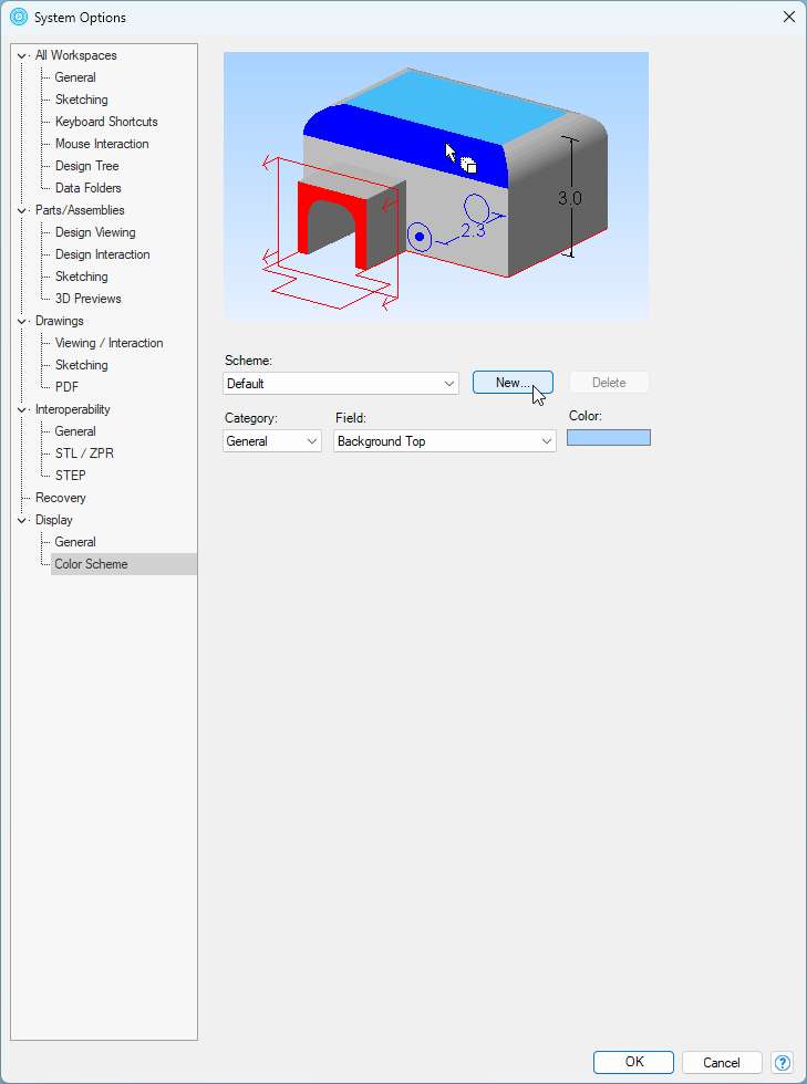

        Based on further feedback, I’ve put together some instructions on how to modify the colour scheme to make it more readable for conditions such as red / green colour blindness:
        To define a custom colour scheme, navigate to the Display – Color Scheme section of the System Options menu.

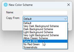

        Click on the ‘New’ button:
        Alibre_Design_sz38AV5oWD
        Choose one of the existing scheme to copy from (for example the ‘Default 2016’ scheme):
        Alibre_Design_gC52cNtZRV
        Then type a name for the new scheme and click OK:
        Alibre_Design_eJcinOyiOr

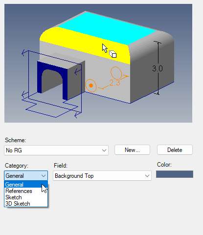

        To make changes to the colours, first select the Category you need to edit on the left drop down:
        Alibre_Design_B17nH2Jb9p

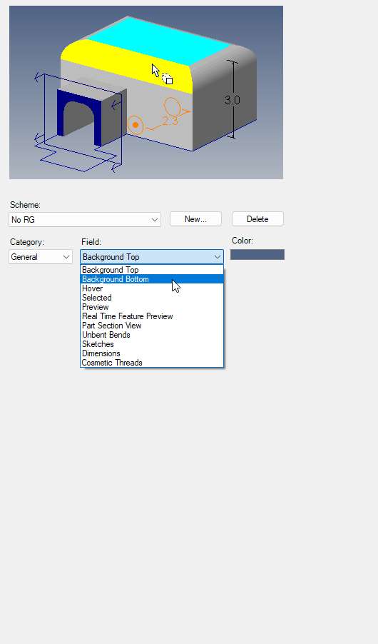

        Next choose the element of the UI you wish to change the colour of by selecting it from the Field drop down:
        Alibre_Design_c13iL4CT8K

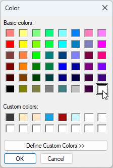

        Next click on the Color swatch to bring up the color picker, then choose a new color and click OK:
        (Note: You can choose more colours and set specific values for Reg, Green and Blue by clicking on the ‘Define Custom Colors >>’ button)
        Alibre_Design_2KuY6TJGVf

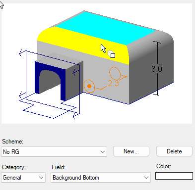

        Below is an example where I have changed the Background Top and Background Bottom colours to white (making both the same removes the gradient effect which can help make the interface more readable):
        Alibre_Design_WOF7BKrsfm
        For Red Greed colour blind users I suggest starting with the ‘Default 2016’ scheme and then making the following changes:
        Category – General:
        Fields:
        Background Top – White
        Background Bottom – White
        Preview – Medium Blue (Red 0, Green 128, Blue 192)
        Cosmetic Threads (Alibre Pro / Expert) – Black
        Category – References:
        Fields:
        Planes / Axes / Points – Medium Grey (Red 128, Green 128, Blue 128)
        Surfaces (Alibre Pro / Expert) – Light Blue (Red 201, Green 247, Blue 252)
        Category – Sketch:
        Fields:
        Fully Defined Figures – Black
        Magnitude-Defined Figures – Blue (Red 0, Green 0, Blue 255)
        Non Magnitude-Defined Figures – Light Grey (Red 192, Green 192, Blue 192)
        Inference Lines – Yellow (Red 255, Green 255, Blue 0)
        Category – 3D Sketch (Alibre Pro / Expert only):
        Field:
        Elevation Guidelines – Cyan (Red 0, Green 255, Blue 255)
        If anyone finds better colour options that these please feel free to add them to this thread. We are currently talking with Alibre to hopefully get a red / green friendly colour scheme added to the default options for future releases.
