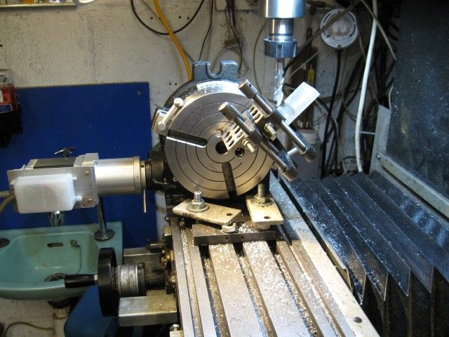

                  Hi Mike,
                  The table works very well and is much more convenient than the original table. The only modification I made was to add a magnetic catch to hold it in the position for using the bandsaw normally. I went a little OTT machining the radius on the edge of the plate.
                  Milling a radius on the edge of a 6mm plate
                  Note the tailstock supported the end of the plate while machining but was removed to take the picture.

                    Neat use of the drilled block for workholding, I like it!
