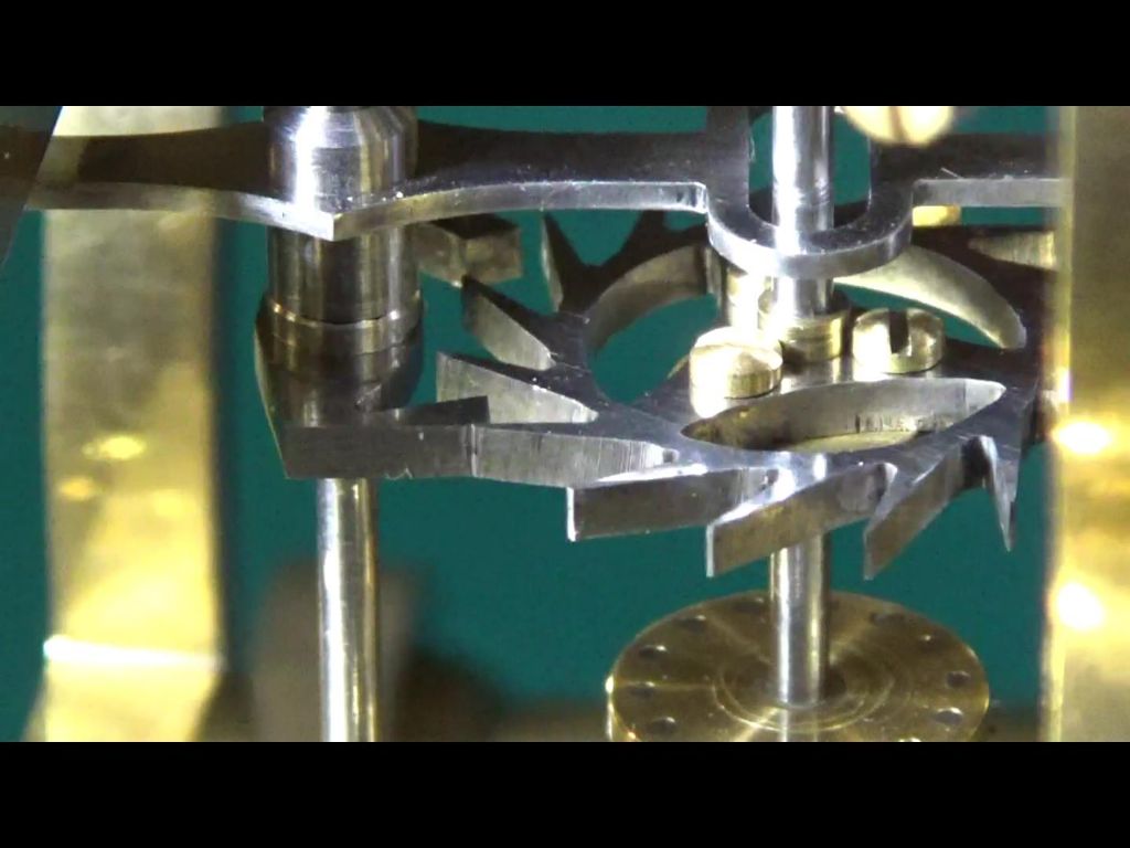

          Since there was a (2nd page) thread glitch, I’ve only just found your latest and very absorbing post. Some of this is leaving me behind and I’m tending to lose sight of what I’d like – i.e. some good close up video without spending too much.
          My earlier attempts to get close to the skeleton clock’s escapement was through the Sony 405 Handycam. It boasts a 60x magnification although that turns out to be a combination of optical (30x) and the rest digital zoom. See this single frame (Snapshot) image from the Handycam.
          I feel sure that the Legria can be adapted to take better shots.
          I’m pleased to note that (as you remark), it’s not very wise to hang a heavy lens onto the front of another, especially if the front end moves when focussing.
          As it happens, the exposed section of the lens of the Legria HF G40 is quite rigid, and would probably support the weight in a nose-nose (lens reversal) arrangement. I still think it’s a good point to make for us with less knowledge.
          Since I don’t (yet) have a 58mm male-male reversing ring, none of my test shots were taken with the lens fixed to the camera.
          It doesn’t look as if I’m finished yet.
