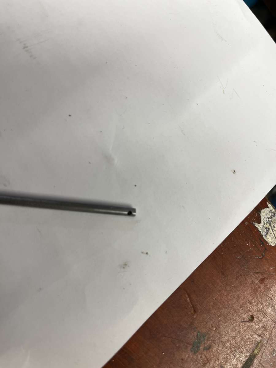

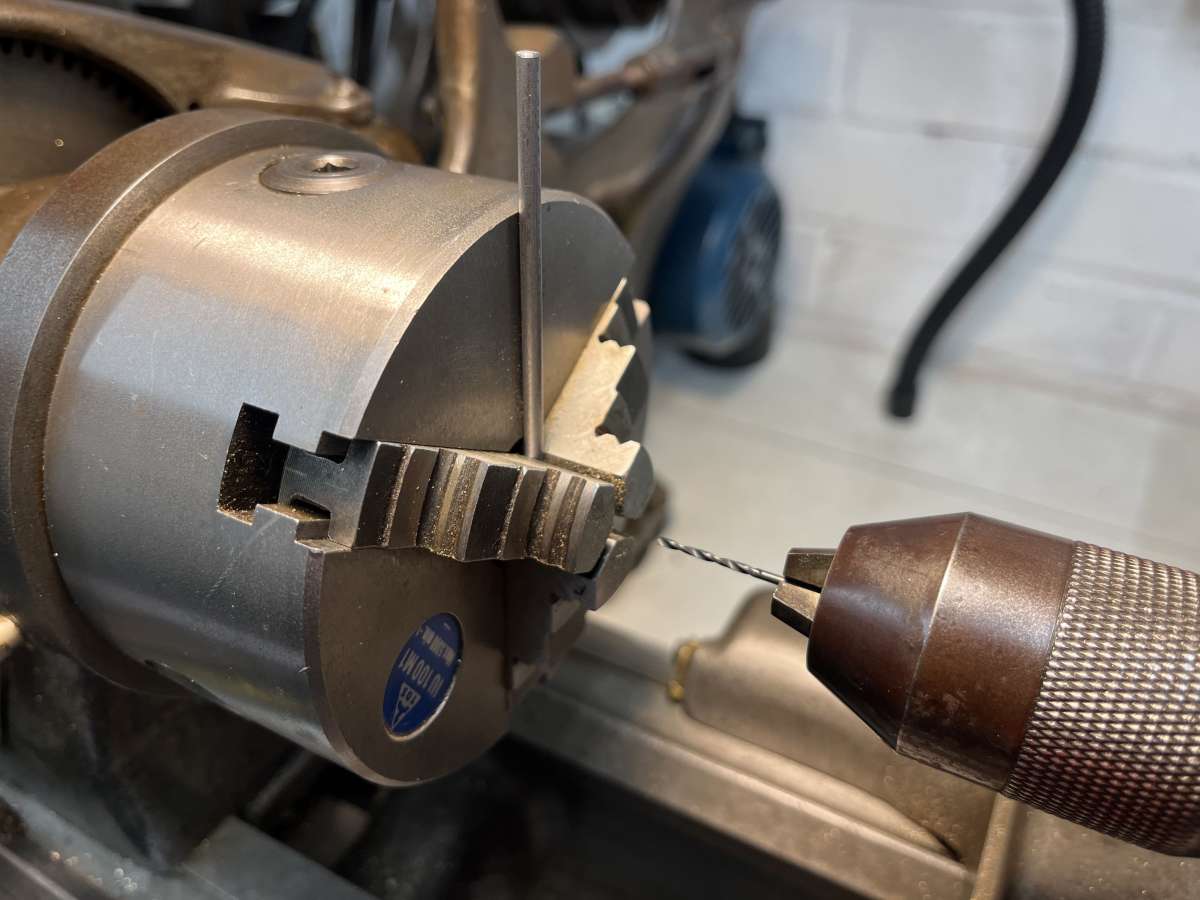

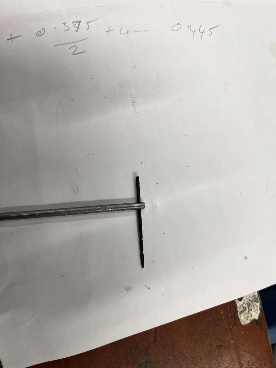

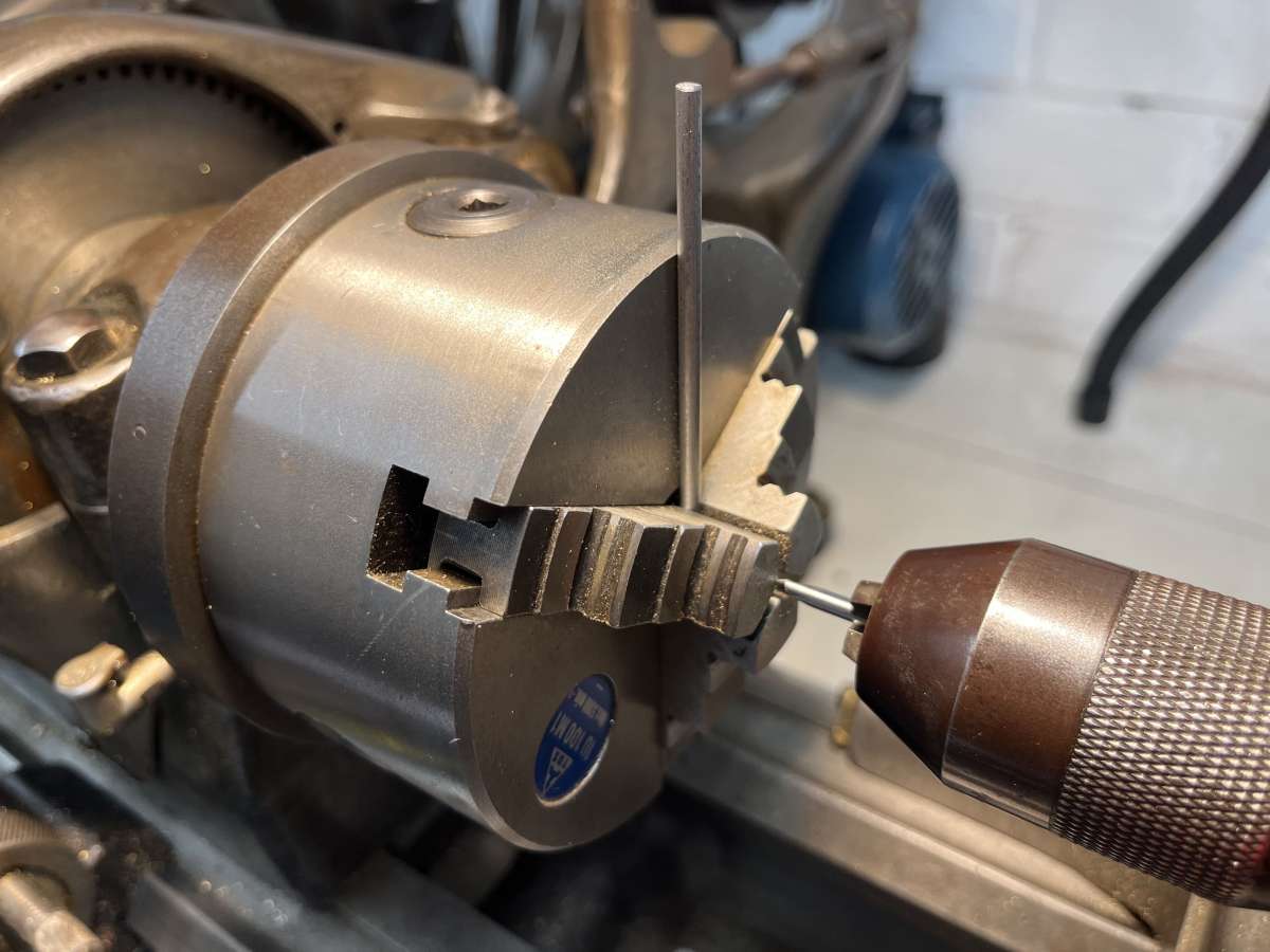

            Bob Sillitoe
              @bobsillitoe83708
              Cross hole successfully drilled. I decided to have a go using my lathe and holding the workpiece cross wise in the chuck. A technique I have used before but not with such a small diameter bar. Here are a few pictures, you can see that I had just enough room to get a centre drill down between  the jaws of the chuck, then drilled with a 1/16″ drill.
              It is quite a good technique but you have no control over the axial position of the cross hole, so really only suitable if you need the hole near the end of the bar. IMG_2618IMG_2619IMG_2620IMG_2621
