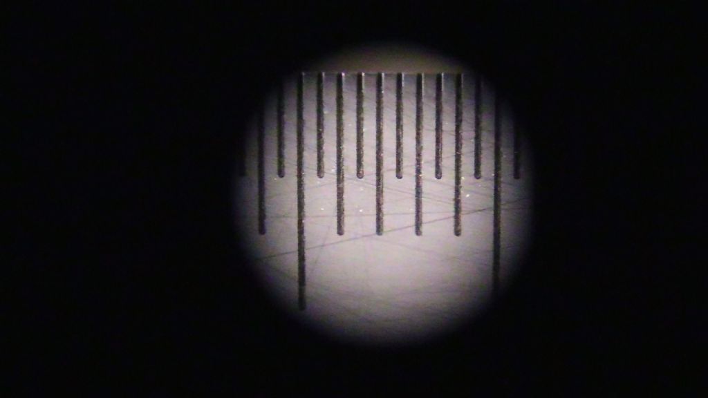

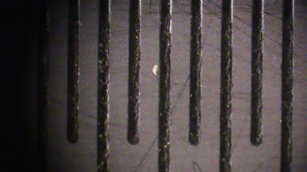

                                    #248590
                                    Sam Stones
                                      @samstones42903
                                      Here are my attempts using a standard lens back to back with the camcorder lens, as highlighted by Neil earlier.
                                      The vignetting might come in useful when I'm feeling a bit arty.
                                      Holding the lens against the camcorder by hand, leaves a lot to be desired from a camera-shake point of view.
                                      Can't say the focus is all that brilliant either.
                                      All this is looking good, so I might bite the bullet and get me a two-element diopter CU-lens/filter/achromatic/supplementary/…
                                      No promises!
                                      Regards,
                                      Sam

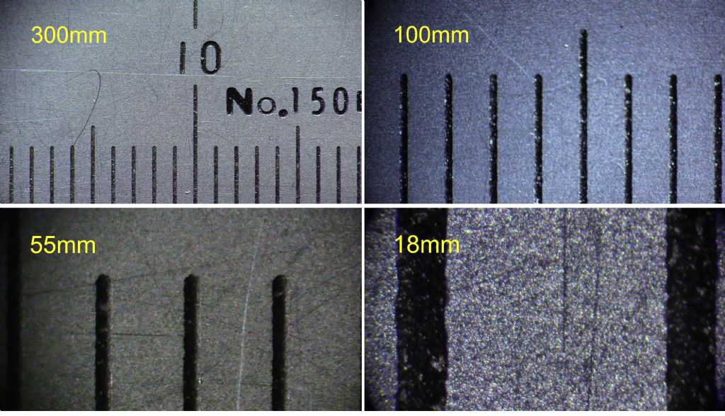

                                          #249355
                                          Sam Stones
                                            @samstones42903
                                            Thanks for that Howard.
                                            My brief lash-up this morning (without a reversing ring), shows the effects of using two different zoom lenses. They were a 100-300mm and the standard (18-55mm) lens fitted to my stills camera. These were reversed and `snugged up to' the Legria. This camera was zoomed to full telephoto (equivalent to 73.4mm [35mm]).
                                            With such minimal DoF it is extremely unlikely that I'll ever find a (video) use for all but the 300mm . I'm still in favour of a popping on a supplementary CU lens/filter.
                                            An interesting journey so far, so thanks for your help and interest.
                                            Sam
                                            PS – I forgot to insert the composite picture and risk losing this note. I'll be back!!!
                                            Oh! I almost forgot – the graduations are millimetres.
                                            Edited By Sam Stones on 04/08/2016 00:47:06
                                            #249363
                                              Sam,
                                              Those are astonishingly good results … Well Done, Sir !!
                                              Canon has produced an amazing, 20x zoom, lens; and yet you have clearly demonstrated that it's capable of adaptation.
                                              I cannot find an optical diagram of the lens, but I do know that it has twelve elements … Such beasts are usually optimised by the manufacture, to work within a specific 'envelope'; but performance drops dramatically outside that range. …

                                              Ajohnw
                                                @ajohnw51620
                                                This wiki page quotes the rather simple sum for the magnification this set up gives
                                                **LINK**
                                                There are a couple of complications in using sums like this. It might be called real magnification onto the sensor. In other words the size the object will be on the sensor. The sensor may not be big enough. The other one is that cameras sometimes have 35mm equivalent focal lengths on them, not their real focal length.
                                                To save you looking the magnification is focal length of lens on camera / focal length of the attached lens. These need to be the actual focal lengths.
                                                The general idea of reversing a lens is that the back end is optimised for working at short distances. The front for working at a distance. So in this case both lenses ideally need to be focused at infinity. If not the magnification will be different and the corrections built into the lens less appropriate. In the other case when a lens is reversed and mounted on extension tubes the lens focus is used to focus the image on the sensor. Both are really set ups for achieving rather high magnifications. When a lens is mounted directly on extension tubes there comes a point as the magnification is increased where better results will be obtained with it reversed. Both set ups are for very short working distances really and magnifications over 1:1. I'd guess that Sam's camera uses a rather small sensor so 1:1 or anything like it is probably completely unsuitable.
