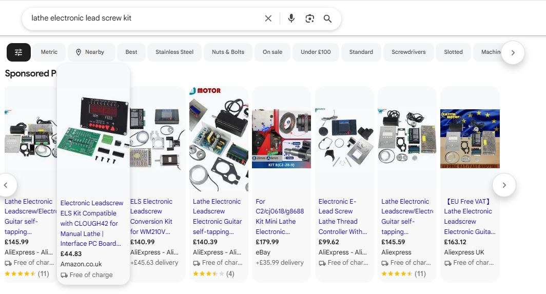

                      On 3 October 2026 at 18:26 JasonB Said:
                      Plenty of bolt on kits are available too for many of the Chinese lathes with all the brackets, pulleys, belts, motor, drive etc for less than the offerings above plus other parts needed..
                      Could you link to some?  Might be useful and I’d be interested too?
                      #867848
                        One only needs enter something like lathe ELS or ELS for lathe into google and many will come up from ebay or the likes of Aliexpress, amazon, etc
                        els
                        #867955
                        southernchap
                          @southernchap
                          #867962
                          southernchap
                            @southernchap
                            Ah, okay.  I didn’t know they were so prevalent these days. Might have a look for my 9×20. Cheers
