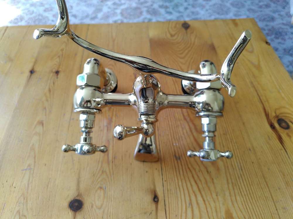

      Not so familier with these style of ‘telephone’ shower / bath taps. I bought a used gold plated Samuel Heath set divertor lever & flangetap body showing shuttletelephone style bath shower mixerwhich leeked from every possible point.
      I have rectified all but one leek which comes form the divertor handle through the stem. The orings have been replaced and more or less hold in the shower and bath function.
      I have tried ptfe tape around the outside between the flange nut, connecting stem and handle which hasnt stopped the leek. I have also tried wrapping ptfe tape on the other side of the flange nut and handle, this has had some success but not elliminated the problem.
      Can anyone recommend another solution eg soft jointing compound that is friendly to orings? I have though about jetblue but have heard it doesnt work well with rubber although perhaps small traces wont harm the rubber.
      I also considered plumbers mate but this doesn’t seem to hold as well when wet and from experience.

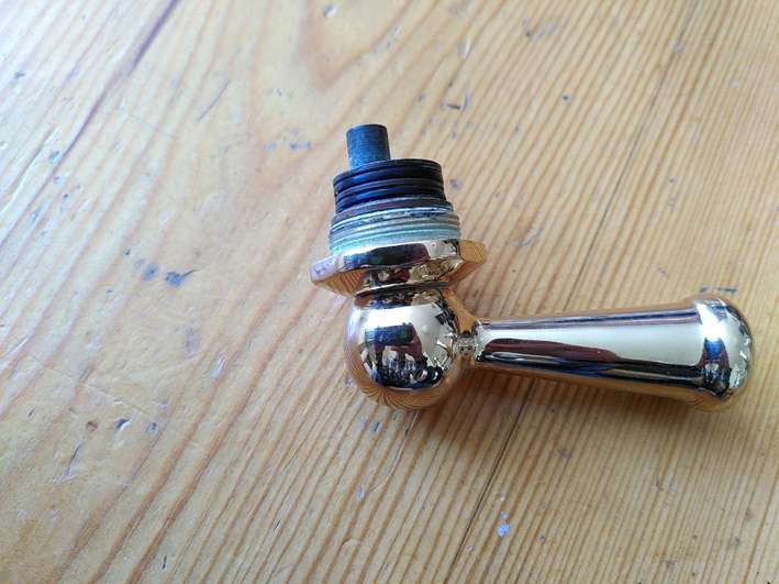

          I think the orings are just for friction so the divertor value holds in the shower or bath mode. Below the orings is grooved cylinder just like a honey scoop.
          My best guess is the water is getting behind the grooved cylinder where it joins the spindle. Then travelling up the spindle of the flanged nut.
          See sketch, water entering into arrowed gap.
          I have tried putting ptfe in this gap which has reduced the water dribbling out but not completely.
          Hence my though of using some sort of soft jointing compound like jetblue…..divertor lever scetch

              A picture may be worth a thousand words BUT the 2 Orings look a little small on OD and may not be sealing on the outer casing or the seating for the Orings is not smooth. Measure the section of the Oring and the OD and get new ones or try a alternative section,eg swap imperial BS for slightly larger metric. Is it all brass or is some of it die cast ali/mazac ? A flexible sealer is unlikely to work on moving parts. Noel.

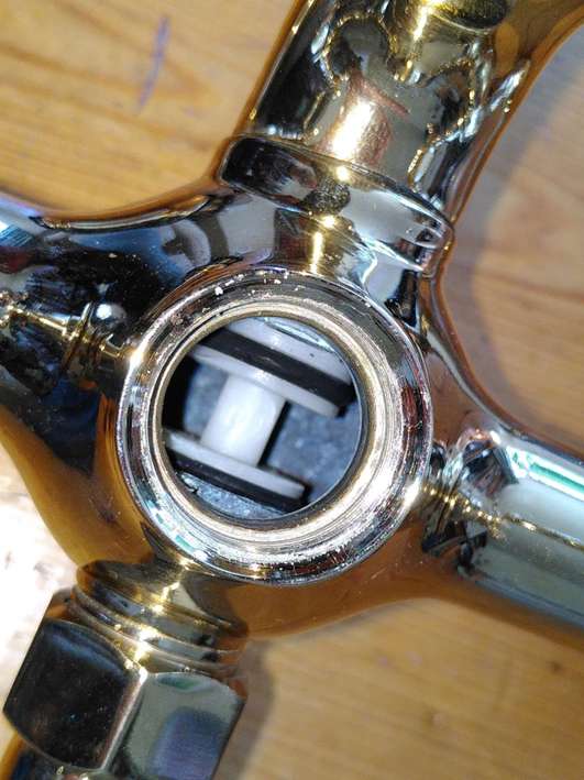

                    Might be getting this all backwards as usual, but as I see it, the issue isn’t with the o-rings on the white nylon part, is it? That is moved by the eccentric on the lever, so the leak is coming from where the handle goes through to that eccentric. So, the question is, can that “honey-scoop” part be separated from the external handle so that the seal on the shaft can be seen, and replaced? Isn’t graphited string the usual stuff used in that position on taps and valves? Is there some sort of gland nut that might be able to be tightened?

                      Rob the white nylon part called the shuttle is only for the shower and bath selection which works reasonably well.

                        O rings work best with a small amount of compression only, and accurate and well finished surfaces.
                        One thing to avoid is two O rings in series – if the annular gap fills up with water, the self actuating sealing is spoiled. If everything else is correct, try removing one.

                            If the water is getting to the gap then the Orings are not working. The eccentric is solid and seals via the Orings, if water is leaking down the shaft of the handle/hex nut then the Orings need attention. For the figures being mentioned, get 2 boxes of assorted O rings, one BS and the other metric, you will have a lifetime supply from 6mm to about 40mm. Good luck.  Noel.

                                The O ring grooves, and the bore of the housing where the O rings contact, must be clean.   If there has been leakage, there may well be some limescale present which could prevent a good seal.
                                Also clean the screw threads to make sure they don’t try to align the parts when assembling.  A little silicone grease on the O rings should help avoid pinching during re-assembly.
                                O rings don’t make wonderful rotary seals, they will need to be changed from time to time.
