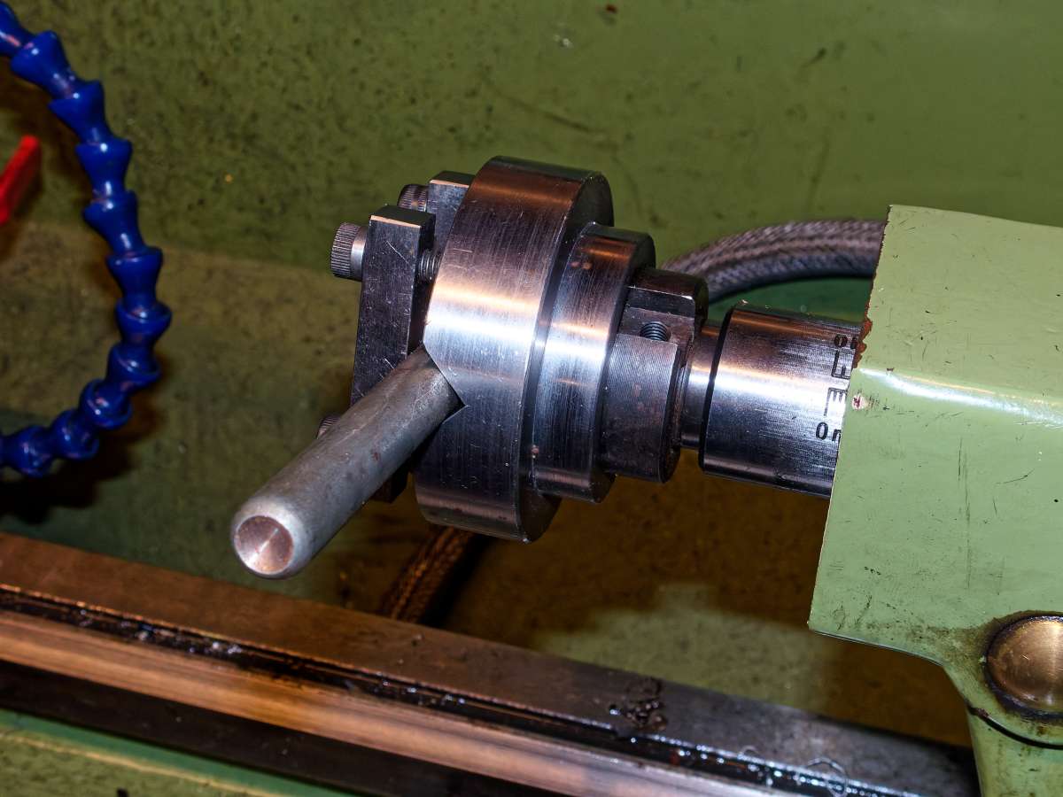

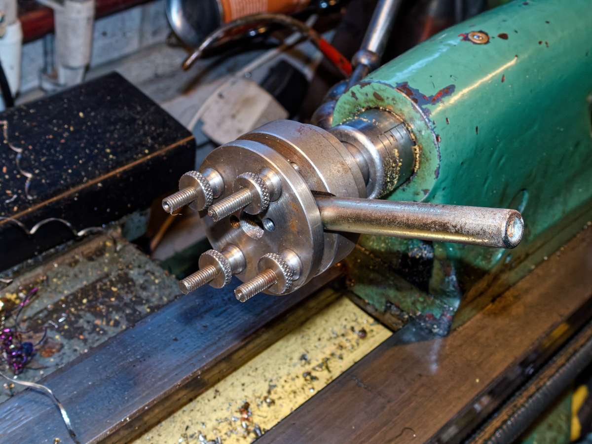

      I was originally going to add these photos to a different thread, but thought they might be better on their own for future reference and searches.
      These are a couple of examples of tailstock cross drilling jigs; they both appear to be home workshop made, and were bought second hand by me some time ago.
      I’ve never seen any commercial ones in the UK, though there are a few designs floating around; I believe someone does sell them; I think in Australia.
      An MT2 one in the Warco 720 (Myford S7B clone)
      SA030017_DxO-Small
      And its larger MT3 cousin inn the Warco GH1330
      SA030016_DxO-Small
      Their use is largely self explanatory.

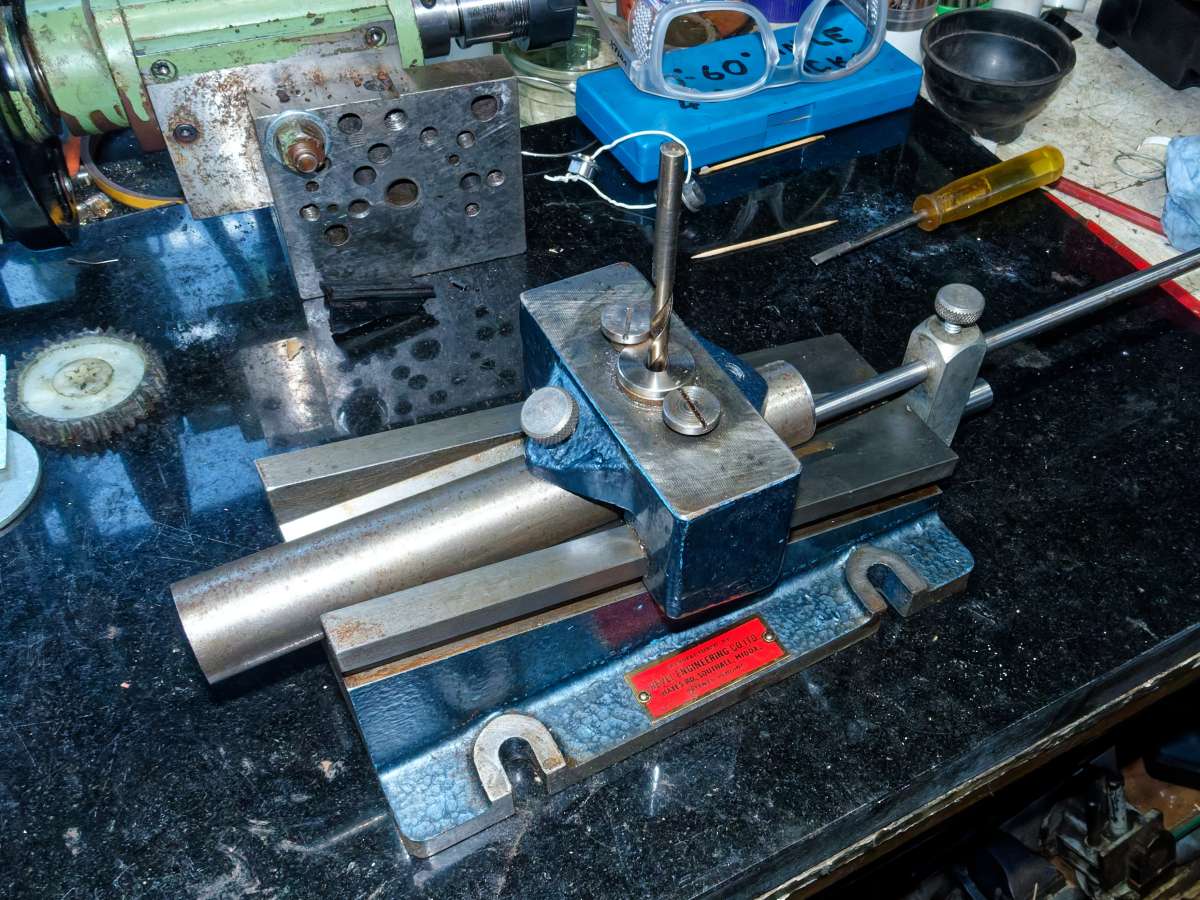

      This one is a bit more oddball, and very nicely made.
      I’ve never seen one similar.
      SA030020_DxO-Small
      The rising saddle holds a guide bush and also clamps the workpiece down; there’s a hidden thumbscrew on the back side to clamp the saddle onto the base.

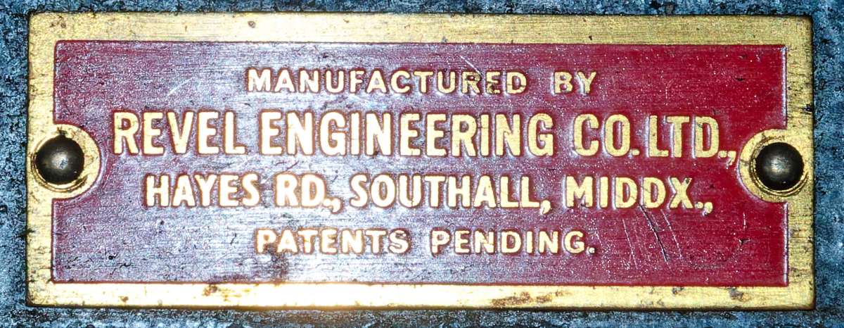

      with a nameplate on the jig
      SA030021_DxO-Small

        I wouldn’t know about the UK or even the rest of the world Bill. But there were a few North American lathe brands who offered them as tail stock accessories, and at least a few tool manufacturer’s who commercially manufactured what seem to be called Crotch Centers for cross drilling shafts here in North America. South Bend I know for sure were offering them. I may have not noticed, but any old catalog engravings or pictures I’ve seen didn’t seem to have any method of clamping the shaft as your first and second pictures show. An error in design ? For all I know, those Crotch Centers may still even be available somewhere.
        That Revel Engineering jig is not one I’ve ever seen. I’m suitably envious. 🙂

          The Canadian version of Mr Revel’s patent is nicely formatted for legibility.
          https://worldwide.espacenet.com/patent/search?q=pn%3DCA661633A

                A few things that have put me off such tailstock jigs, maybe those who use them can show how their jig will do the things that put me off.
                1. Drilling holes in short small diameter items, lets say 1/2″ long x 1/8″ dia though I often have a need for 1/4 long”
                2. How do you position the hole a set distance from the end or even see to locate as scribed mark on th eclampe equiped ones, again on small items but could apply to large.
                3. What do you do with the tailstock ones if you need more than one hole as the work is likely to rotate as you reposition it after drilling the first.
                4 Related to the first these short items often take the form of a headed pin so won’t lay in a Vee.
                With so many more people having mills these days I see less need for them than maybe 50yrs ago when the lathe may have been the only machine in the workshop.
                    Not easily, and I have the same reservations; that’s why I didn’t spend much on them, and certainly not on the second one.
                    The first I picked up before I had a mill, or even a decent pillar drill.
                    That said, often a little forethought in the production process helps; for short pins, such as in your photos, drill the cross holes first, and machine the rest around them.
                    More than one hole in a bar is a pain, but you could fix a toolmakers clamp to the nascent workpiece, and slide it along some flat surface. either the saddle, or just a bar across the lathe bed.
                    I now have various other equipment available, and even a conventional wobbler/edgefinder.
                    Alternatively, for smaller items, drop the workpiece below the top of the milling chuck and centre on the inside of the jaws, rather than the round bar.
                    Effectively Joe Pie’s method for centring square stock in a 4 jaw lathe chuck.
                    For quick jobs where accuracy isn’t vital, before mounting the drill, I have a length of pointed bar in the drill chuck.
                    Trap a length of stiff feeler gauge twixt that and the workpiece, and when it sits level, it’s close enough.
                    Bill.

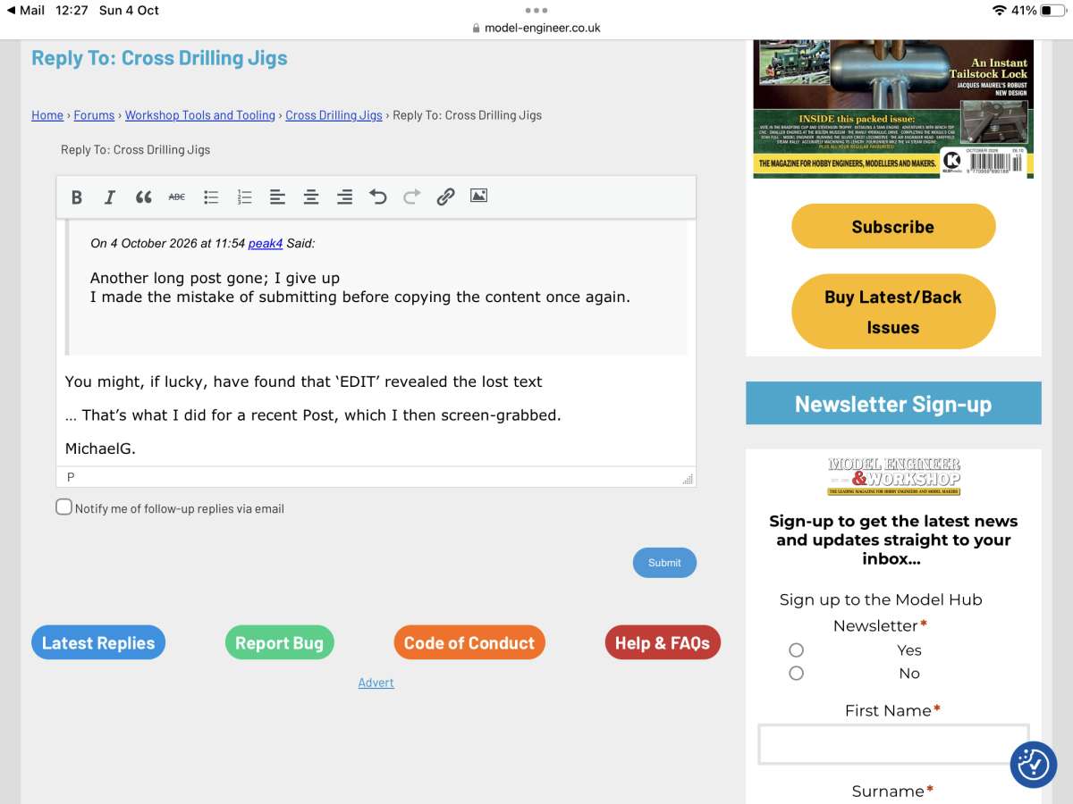

                          On peak4 Said:
                          Another long post gone; I give up
                          I made the mistake of submitting before copying the content once again.
                          You might, if lucky, have found that ‘EDIT’ revealed the lost text
                          … That’s what I did for a recent Post, which I then screen-grabbed.

                                      Re. the tailstock drilling jigs, both came second hand to me. Yes I agree they are less than ideal, so I didn’t pay a great deal.
                                      The MT2 one was bought when I had just the Myford and a bench drill with a wobbly quill, plus a dodgy machine vice, so it fulfilled a need. This would have been mid/late 1980’s
                                      The MT3 one came much more recently and does get used occasionally in the larger GH1330; It was only £3 I think.
                                      Cross drilling for split pins just needs a different approach, start with the cross drilled hole on the end of a piece of bar, and complete the rest of the machining operations using that as the datum.
                                      Two holes in a bar is a bit more of a faff.
                                      I only needed to do it once using that MT2 jig many years ago.
                                      Essentially set up the workpiece horizontal, and attach a toolmakers clamp to it. Let one of the clamp’s screws run along a bar placed across the lathe bed, which will preserve the orientation of the workpiece as you slide it through the jig.
                                      I now have a couple of mills (Centec & DW) and real machine vices; one of my drills also has a cheap two axis cross vice.
                                      For rough and ready jobs I have a pointed bar in place of the drill bit; trap a length of stiff feeler gauge strip twixt the point and the workpiece; when it sits level, the work is centred.
                                      For more accurate work, either use a wobbler/edge-finder and centre the work that way, which is easy for larger jobs.
                                      Alternatively sit the workpiece low in the vice jaws, and centre on the insides of the jaws, in a similar manner to the Joe Pie video where sets a square bar in a 4 jaw lathe chuck; in our case use the indicator in place of the drill bit.
                                      Other ways I use include using a floating machine vice, not keyed to the machine’s table.
                                      Hold a length of bar in the drill chuck, the same diameter as the workpiece, grip that bar in the machine vice, so the jaws are now centred under the drills axis of rotation, and then fasten the vice down.
                                      That’s quite quick for me, as my bench drill(s) both have round magnetic tables on them, and is probably the quickest method.

                                        I would like to get my hands on one of those Revel adjustable stands. But for most angled drilling, I have found one of those little digital levels or dipmeters plenty good enough being able to resolve 6 minutes of arc.
                                        #868022
                                        peak4
                                          @peak4
                                          Its footprint is  210 x 120mm  and it will hold work between about 15 – 38mm, with ideal mid range about 28mm.
                                          Also it’s for cross drilling perpendicular to the bar only; for angles, one would need a tilting table, sine plate or similar.
