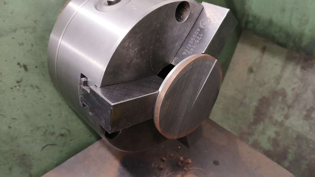

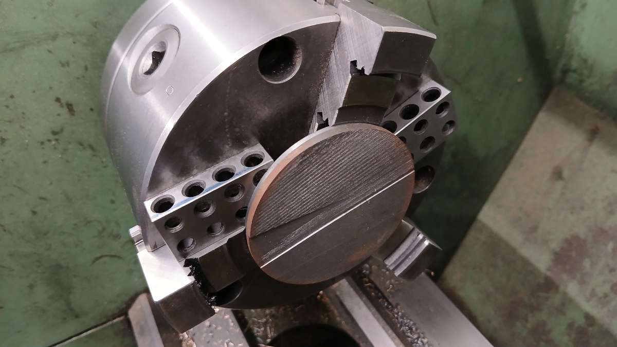

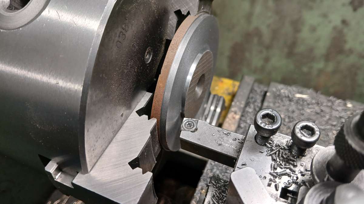

                        #814331
                          On Steve Huckins Said:
                          The lower steps can hold the part but it means it doesn’t stick out for access to do the turning.
                          Steve

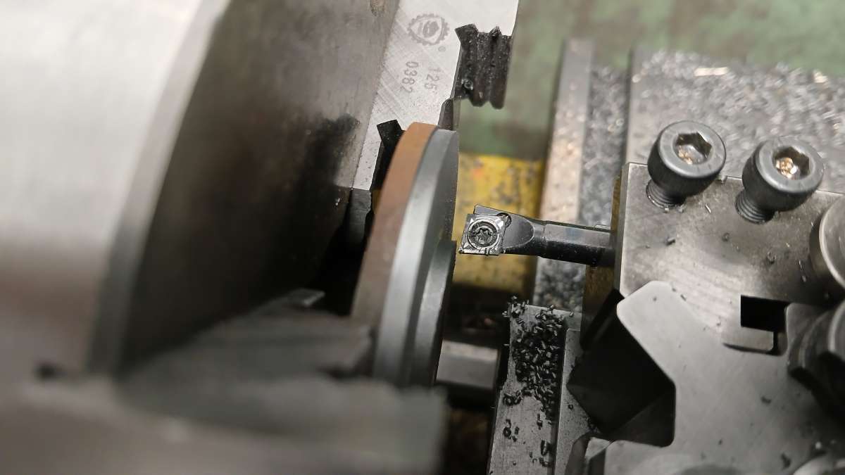

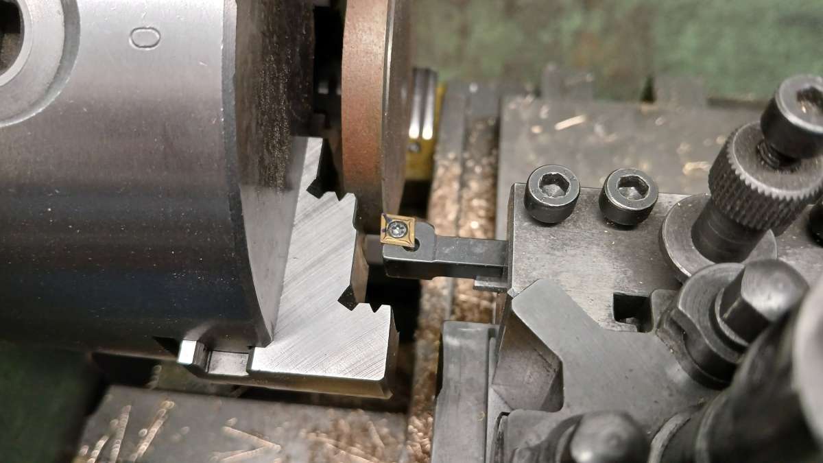

                          A few pictures to show how something like a cylinder cover can be held and turned with the right tools or methods. I have used carbide for the photos but the same would apply if using HSS.
                          You seem to describe a problem where the tool can’t reach the work as the outer step of the jaws gets in the way. With a right hand tool as shown then they will indeed get in the way.
                          20250829_084531

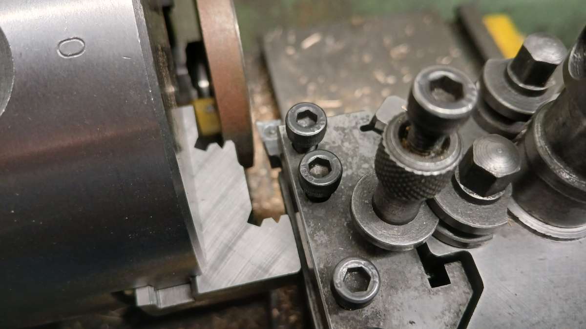

                          Changing to a left hand tool will allow for both facing and turning the OD as well as any chucking spigot if provided. You may need a little more tool stickout. A more pointed tool can also work if the toolpost and therefore shank is angled to clear the outer jaw.
                          20250829_084622
                          Another form of Left Hand tool will do the facing but not the OD
                          20250829_085243
                          If you do not have a left hand tool then all is not lost with the far eastern lathes. As the chuck bolts on you can happily run the spindle in reverse and bring the tool in from the back. That way you can use a right hand tool or even a boring bar.
                          20250829_085410
                          20250829_085511

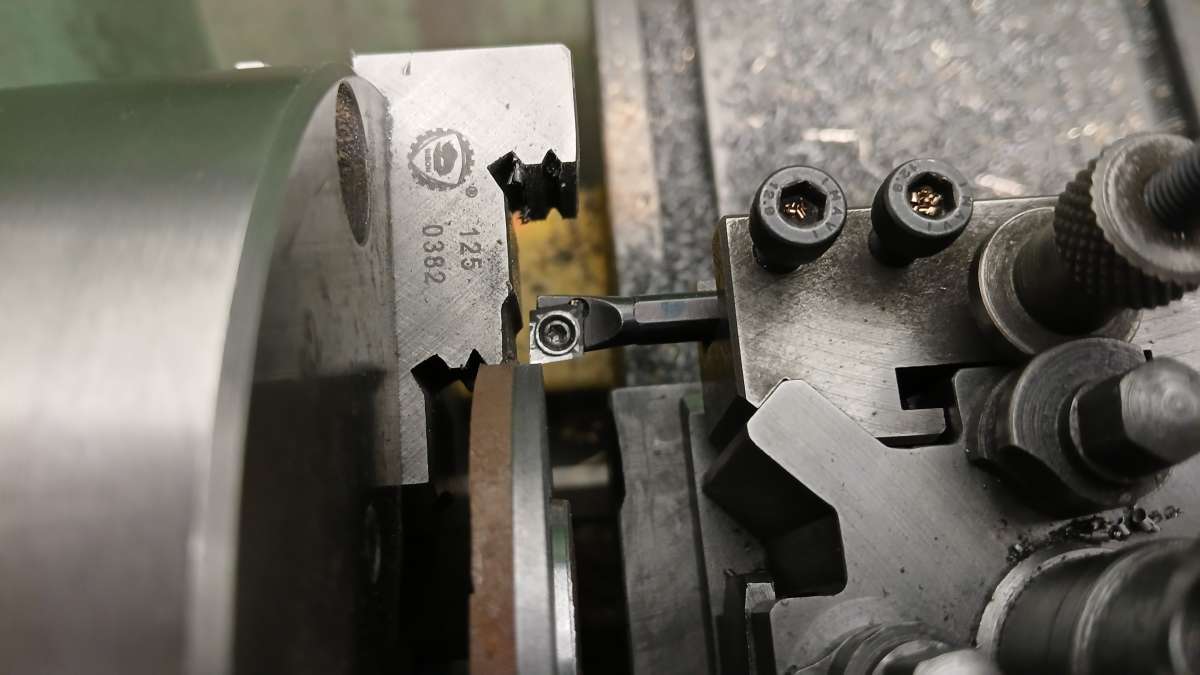

                          When it come sto machining the other side you can hold in th esame way but to make sure the thin part does not wobble use some packing behind to get the unmachined face proud of the jaws. REMOVE before switching on.
                          20250829_085635
                          This is where I like my soft jaws as the shallow recesses do the job of the packers without dropping into th eswarf tray as well as giving clear access for tools.
                          20250829_085821

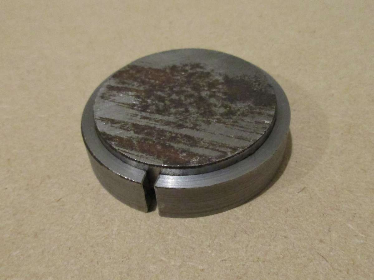

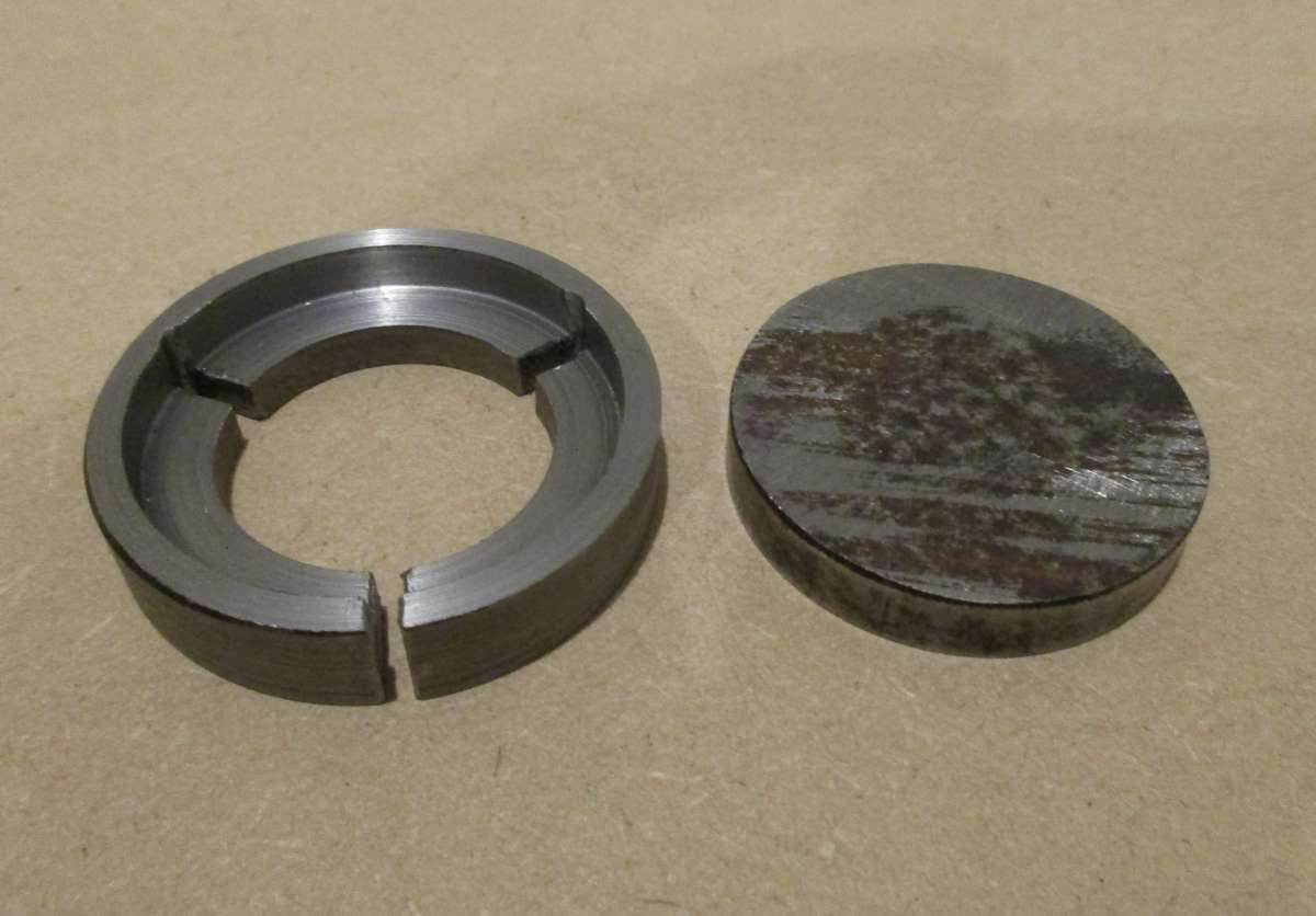

                              Nicholas Farr
                                @nicholasfarr14254

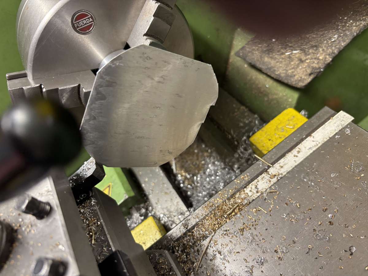

                                Hi Steve, you can always make one of these, which I did to face a few blanks, I used a slice of BMS that would fit in the outside jaws. Just turn the ring up with the recess in it, before cutting the slots.
                                001
                                002
                                Regards Nick.

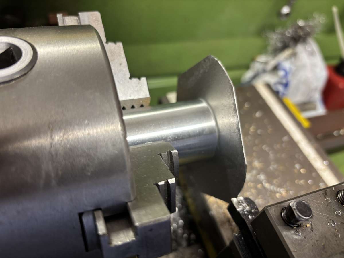

                                #814346

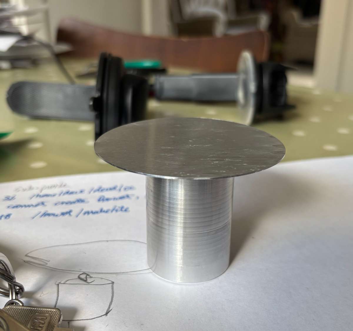

                                  By coincidence I made a pillar/platform to hold my daughter’s car entertainment system.  Normally supported by a sucker gantry thingy attached to the windscreen, but her car’s curves made this impossible.  I made it with a stub-mandrel and super-glue.
                                  Superglue is strong provided the joint is made properly – smooth clean surfaces, new glue, and kept firmly pressed in place for about 15 minutes whilst the glue sets. The method is ancient and much used by clockmakers except they use Shellac rather than super-glue.  The super-glue bond is most easily broken by heat: boil in water, oven bake, or gentle blowlamp.  Most superglues fail at about 100°C, others good up to 140°C.    Clean with Acetone.  Shellac is easier to set up and dismantle than super-glue but not so strong.IMG_0431
                                  IMG_0432
                                  IMG_0433
                                  Not quite so solid, is a friction grip.  Light cuts only!  The item is forced against the mandrel or faceplate by a flat live-centre:
                                  Photo of a friction gripped saucepan to follow when my camera has recharged!
