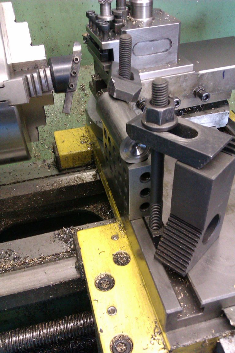

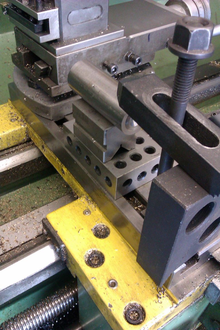

                            Clamping will depend a lot on what you have available. Pack to bring the work upto the lateh ctr height
                            This is not ideal as there is a risk of the bar moving, use two clamps not just the one as shown.
                            A Vee block would be better but use a small flycutter to avoid hitting it, again use two clamps
                            Stood on end is another possibility, two clamps again
                            Or hold in 3 jaw

                                  Thats known as a 1-2-3 block, parallels tend to be longet and thinner typically 3mm x 150 x various heights but anything to hand will do.
                                  I think I have only used that 3 jaw method with flat stock whick means mor emetal in contact with teh jaws, it can also be done with your 4-jaw and should allow all jaws to contact and would be a better bet than the 3 jaw.
                                  If you do o with the 3-jaw just take light cuts and only take enough off until you can get it in the 4-jaw.
                                  OI would think your 6mm tee slot applies to the thread M6 with the slot being 8-10mm to take the neck of the tee nut.

                                                You could actually saw down the length of your bar to make it "D" shaped and then the other two jaws may grip.
                                                A Bazyle and I said anything will do to start off with, although I now have 123 blocks, parallels, vee blocks etc I still often reach for the two 3" lengths of 1"x1/2" that have served me well for years.
                                                Your 4 way toolpost stood on its side will make a rough and ready Vee block.
