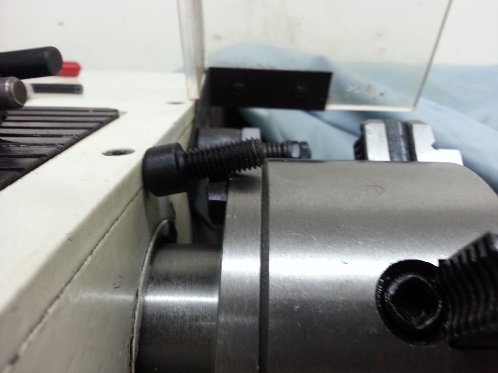

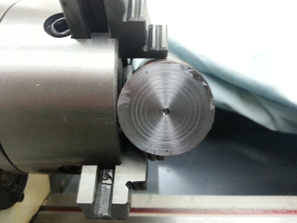

      Looks like I will be OK? If I take it slow, once one side is done it will sit a bit further into the chuck perhaps? Feels pretty solid, I guess when it flies past my ear I will know how solid…
      The image below shows the cap screw supplied with the 4 jaw, and a bolt fitted from the 3 jaw. The difference between the two is 4mm, but my logic is if the shorter bolts (16mm) are OK for the 3 jaw they will be OK for the 4 jaw – and there are 4 bolts not 3 as well
      Thanks for all the help and advice everyone
      Chris

        That looks like a pretty iffy setup to me Chris, judging by how much the jaws are hanging out of the chuck and by how little of the jaws overlap the bar.
        Martin.

          I agree with Martin – I think your set up looks very iffy.
          It might not fly past your ear but instead hit you in the face and take your eye out – I really advise you not to proceed like this.

            Chris that does not look secure. It is hopefully an optical illusion but your jaws do not appear to be past the centre of the workpiece, and they need to be on the round bar you are using. Should that be the case you stand a very serious risk of the component launching itself when you start machining it.

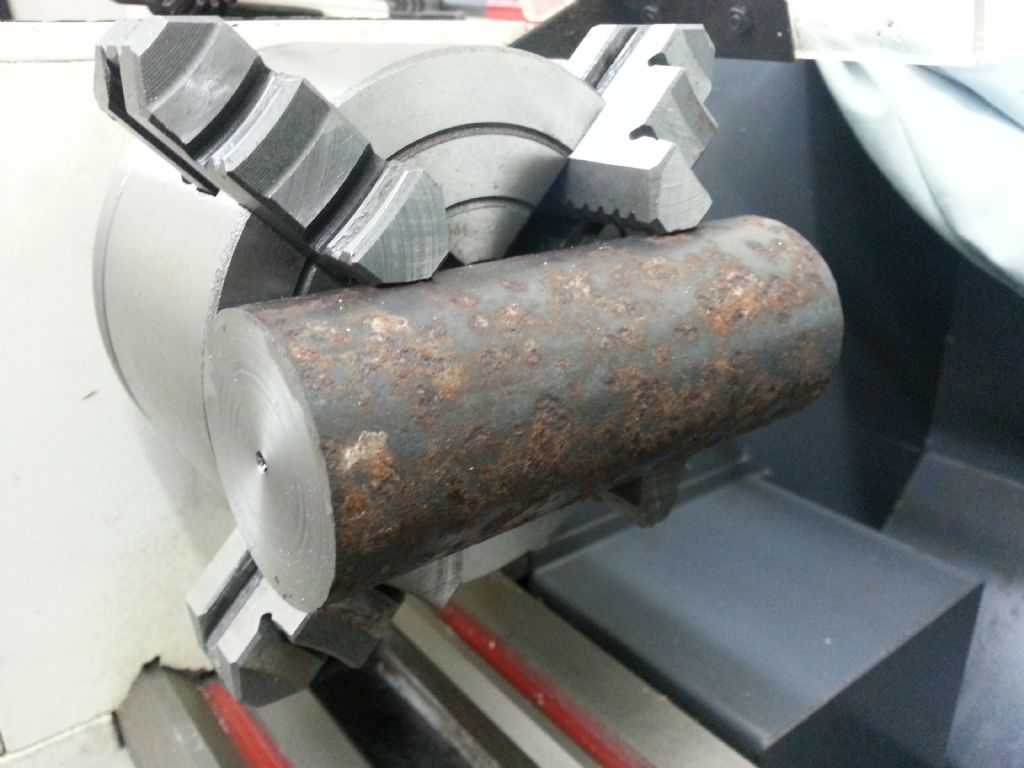

              Right, OK – looks like I'll have to clamp it to the crosslide and get a flycutter to put in the 3 jaw, means a bit more effort but it is a bit of a lump to turn into a projectile.
              It's 30mm diameter, I guess a bit smaller and I might be alright but I have no problem trying the other approach, and as I am learning it's hard to judge what is acceptable (or not!)

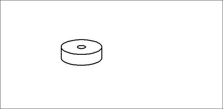

                Posted by Chris Parsons on 18/02/2013 09:16:22:
                Got my four jaw chuck out of the box for the first time on Sunday with the aim of cutting a short, round bar into a rectangle (to create a tapping block)
                why not make you blocks concentric like this….
                if not obvious,parallel faces,drilled and tapped square to faces
                about 5-10 leads thick and V' eed if you feel the need.
                or have I missed something?
                Edited By jason udall on 18/02/2013 23:54:30

                  Chris, when you go for bolts for your chuck, either black cap head screws, Allen head. Or hex head 8.8 or better, these are high tensile bolts, others of lower strength may be OK, but best to get the best.
                  If worst comes to worst, you can always attack the first side with a hacksaw and file, you can clean it up afterwards in the lathe. Ian S C

                    Do what I said earlier and saw down the length to make it a "D" section then it will go back far enough in the chuck to start turning.
                    J

                      the cap screws are wrong, you need bolts. (no space for allen key.
                      the cap screws are to bolt the chuck to a back plate

                            Chris, although your workpiece appears to currently be too far forward and thus not allowing the jaws to grip safely, you could simply measure the distance it need to be set back and file a flat with a coarse file. Leave a piece of the full diameter at the end so that you can easily measure the amount you have removed when machining. Simply placing the filed flat to the face of the chuck should do the job and allow you to get a full grip and carry on. Just make sure that the face of the workpiece is parallel with the face of the chuck if your filing skills have yet to be fully developed. Just mount a clock on the cross slide and adjust until it is parallel. HTH.

                                    Give the bar a bit of wellie with an angle grinder to create a flat sufficient to move the centre of the bar within the chuck jaws, put it on slow revs auto crossfead and go have a cup of tea.
                                    Simple's .

                                      Only to agree with all that's been said, you only need it to move backa few mm, so filing is OK, then when you have the machined flat on the other side, reverse it and create a second parallell surface. If you now turn it through 90 degrees and hold the machined surfaces with the jaws that's three sides, one more turn and its square (to a first approximation).
                                      I still think the best answer is to turn your screws into studs. They are high tensile steel but ordinary medium carbon steel nuts will do. As well as being easier to fit, the nuts will wear out and can be replaced at virtually no cost. repeatedly fitting and removing screws will gradually wear teh threads in teh chuck.
