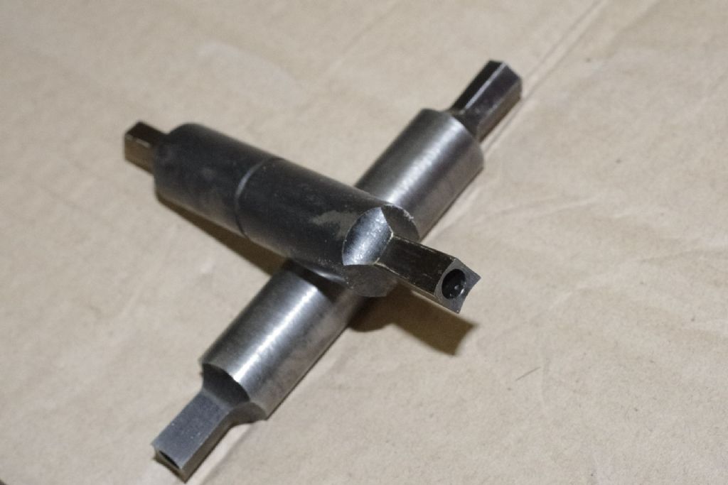

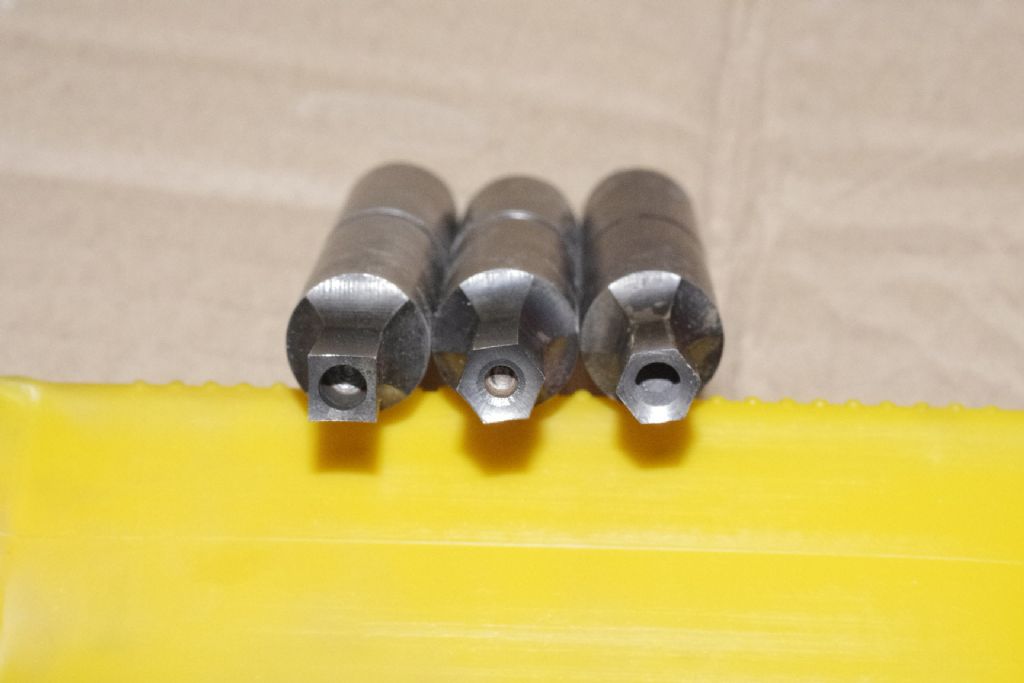

                            old mart
                              @oldmart
                              _igp2487.jpg_igp2486.jpg_igp2485.jpgI have taken some pictures of the rotary broach I made. The bearings are a double row deep groove and a thrust bearing, the er25 collet works for different size cutters. The number etched on the side is the length the cutters must project to have their tips at the null point. I made cutters for square and hexagonal holes.

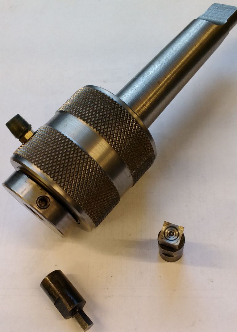

                              John MC
                                @johnmc39344
                                Here is my version of a rotary broach. To give an idea of size the taper is 3MT. I used a needle roller as the main support for the shaft, inner sleeve, if memory serves, is 1" diameter. location and thrust is taken by a ball race located with a circlip. Bearing choice was made by what was in the "junk" box. The shank of the cutter is 12mm diameter.
