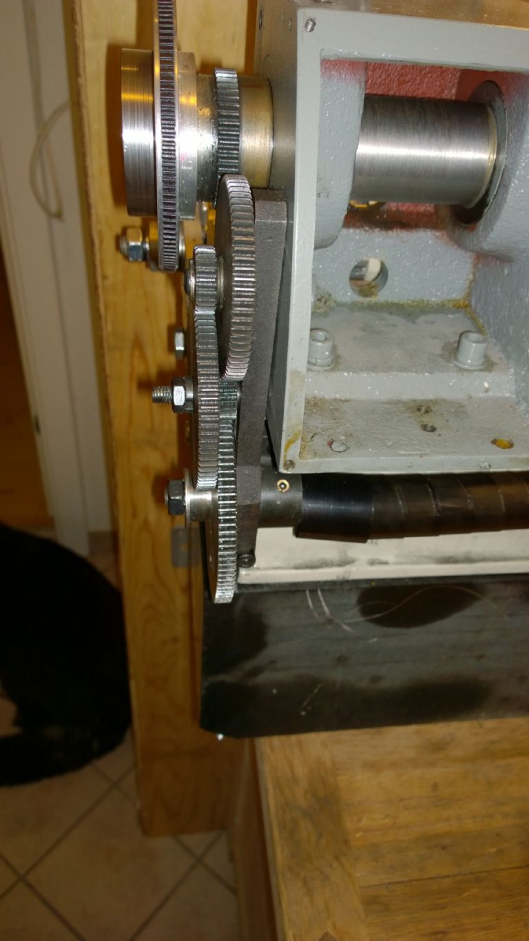

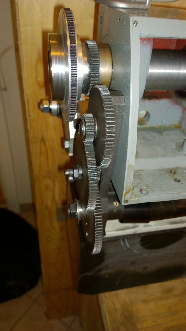

                        Niels Abildgaard
                          @nielsabildgaard33719
                          My modified Kaimac 180 lathe feed geatrain makes to much noise when feeding 0.083mm at 1000 rpm,but is not objectionable when thread-cutting at 60-90 rpm.
                          I would like to have finer feed for most jobs and I do not like the lubrication monkey buisness for first gear contact and the special stud that have been nessecary.
                          I is maybe worth asking You engraving for a quote on a solid say 76/20 compound gear in Delrin running on a special 12mm stud.
                          Not a lot lubrication close to belt and noise very much lower
                          What not to like?

                                    #503212
                                    Niels Abildgaard
                                      Posted by Bernard Reilly on 22/10/2020 14:10:14:
                                      Wm180 change gears further to my post I as advised contacted You- Engraving .com. He supplied all the gears required in Delrin at a fair price a few spares. My lathe is now running a lot noise free therefore no more infernal din from the metal gears supplied by Warco. I have have no connection with company only a satisfied customer.
                                      Bernard Glasgow.
                                      Please excuse my bad memory.
                                      ME had not confiscated a link to You Engraving
                                      It must have been something else.
                                      Bernard :How did You unite the 20 teeth Module One Delrin gear with the 80?
                                      The normal Bush/Key system is 12mm dia and key protudes 1.5mm that leaves ca 1.4 mm Delrin between key and bottom of tooth-gap.Has it stood test of time?
