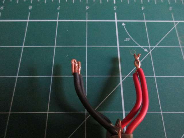

      Hi, I can’t see why a twisted single pair shouldn’t be done, the electricity won’t give a hoot about it, and there will be enough area between the two and the hole and screw to make it a good contact. I’ve done a trial today with a short piece of 2.5 mm twin & earth, with the two of the live ones twisted, and the two ends of the neutral ones folded back, the twisted pair went in quite easily, but the folded back pair were quite awkward to get in with the screw near to falling out. I screwed them both down as tight as I could. When I took them out, I could see good amount of contact on one of the live wires and about the same amount of contact spread over the top folded back one.
      001
      The pull and fallout of the wire over three and five years, doesn’t really prove anything without a regular record of temperature changes, vibrations that may have affected the installation, and knowing how tight the screw was in the first place, you have to remember that brass expands more than copper does at the same temperature, so that can have an effect also. I have changed many sockets in my time, and have hardly found any that have come loose enough to be a problem, let alone falling out, but workmanship in the first place can make all the difference.
      Regards Nick.

          Normally its better to double over the solid core and terminate that way. I wouldnt recommend twisting the cores together as it could lead to broken cores if the cores had to be separated for testing at any point.

              What I have done for many years is to fold the wire back if there is going to be enough room in the connection hole. Then I insert the doubled over connection(s) such that the clamp screw bears on the free end(s), which protects the active run of the wires from being partially severed if the screw is over-tightening or there is a subsequent tug on one of the wires.
              My experience is this avoids connection problems.
