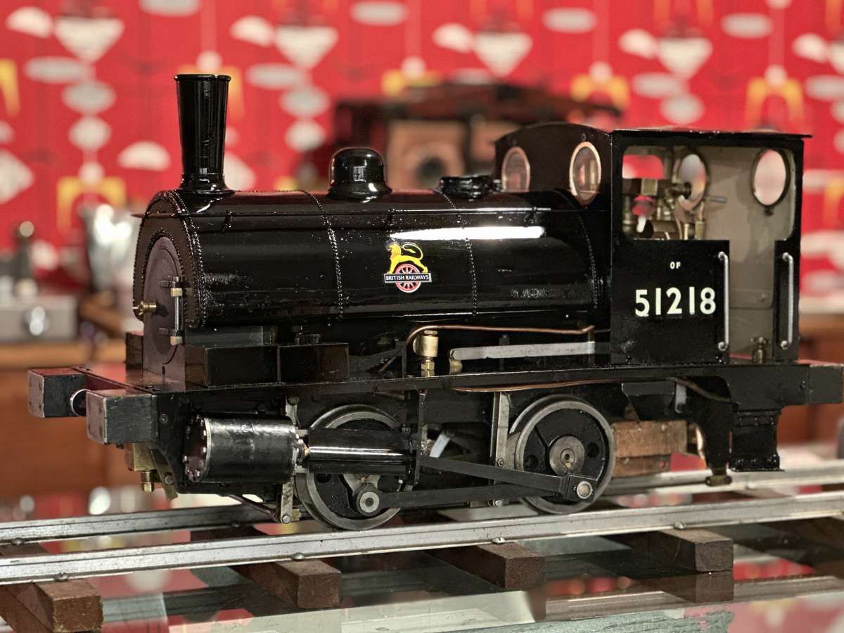

      Hi, I hav just bought a Winson pug that is in need of significant rebuilding. It would be very useful to get hold of any drawings or construction instructions for this kit. Does anyone have a set they could scan for me?
      Any other advice or suggestions would be well received 😃

      Kevan Shaw
        @kevanshaw32462
        IMG_2080
        Tghis is where I have got to with this project. Unfortunately it is still not running Valve gear problem I am still trying to track down!
        #816373
        Kevan Shaw
          @kevanshaw32462
          I fixed it😃 the problem seemed to be the valve was just wrong far too long to open the ports with the available travel. I made a new pair and now it runs! I have a minor problem with the safety valves that don’t want to reseat after blowing off. I bought a bunch of different springs to try.

          Weary
            @weary
            Congratulations on persevering and getting your ‘Pug’ running.  Despite being a commercial model it is exceptionally rare to see one running (or even at all); and you have found-out why!  And furthermore remedied the issue.
            It is a shame that the Winson model is faulty and that Silvercrest, for example, doesn’t supply a similarly small and characterful loco.  Whilst the Pacifics etc., are impressive, I’m sure that there would be demand for such a light-weight loco.
            Anyway.  You have done a very good job, your loco looks great, and now runs well too.
