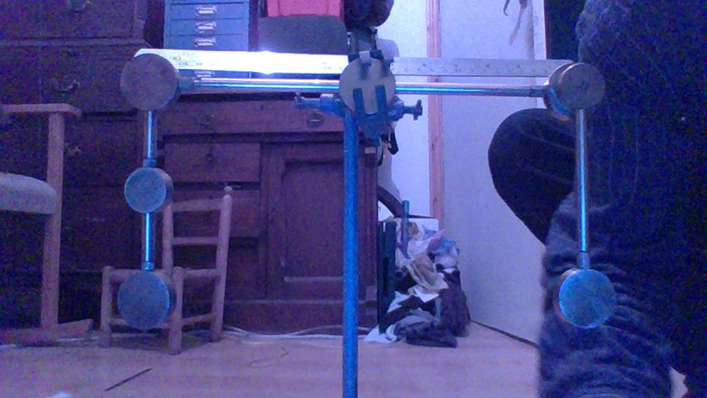

        I think the first thing I ever made when I got a lathe was a chaotic (aka double) pendulum. Partly as an excercise in basic turning, partly because they're fascinating things to watch, and partly because I was teaching at the time – actually seeing such a simple mechanism exhibiting chaotic behaviour is quite enlightening for some students.
        I found the thing again recently – apologies for crappiness of the pic below, I've just 'upgraded' to a laptop with Win10 which doesn't want to talk to anything else, so I used the laptop camera.
        The 'struts' are connected to the 'bobs' by screwthreads with knurled locking collars. It goes OKish, but eventually things work loose (even with threadlock) and it has to be readjusted. A friend was so entranced by seeing the thing going that he asked me to make one for him, but he's a total klutz with anything mechanical, so wouldn't be able to tune it up himself.
        So, finally, I get to my question – can I use some sort of glue (CA?} to fix it together with a reasonable lifespan? If so, what would be the best product, given it's brass?
        Rob.

          If the parts are all brass, just use rosin flux and soft solder it. Or if you're brave about the quality of the brass, use flux for silver solder and silver solder it. JD

            Red Loctite is forever.

                Your original choice [or usage] of threadlocker must have been wrong. Like Hopper, I would simply use one of the stong grades of Loctite anærobic retainers … 601 or 638 should be entireley adequate; they are, to most practical purposes permanent.
                Edit: This is a very useful guide to the use of Loctite 'Retainers'
                Edited By Michael Gilligan on 03/07/2016 09:27:15

                    Loctite wont be a good idea if it needs adjusting to get it to do what you want. Grub screws going into the side of the threads that hold it together should work out.
                    If no adjustment is not needed I would have thought that a loctite retainer and plain holes would be fine. Or drill through and knock in roll pins – they wont ever work loose or move around done that way.

                        Thanks all, seems like Loctite should be OK – I guess I must have used the wrong grade on my previous attempts. I had considered soldering, but it would take me as long to clean the thing up afterwards as to make it – and the chap I'm doing it for is more interested in the aesthetics than the physics, so it has to be shiny bright.

                                                Just to let you know how it panned out – I used Truloc Superfit 231, equivalent to Loctite 603 according to the Arc Euro website, with plain holes, around 0.05mm clearance on diameter, and it's rock solid. Don't know what went wrong first time round. I was probably trying to learn too many things at once.
                                                Thanks for the guidance, Rob.
