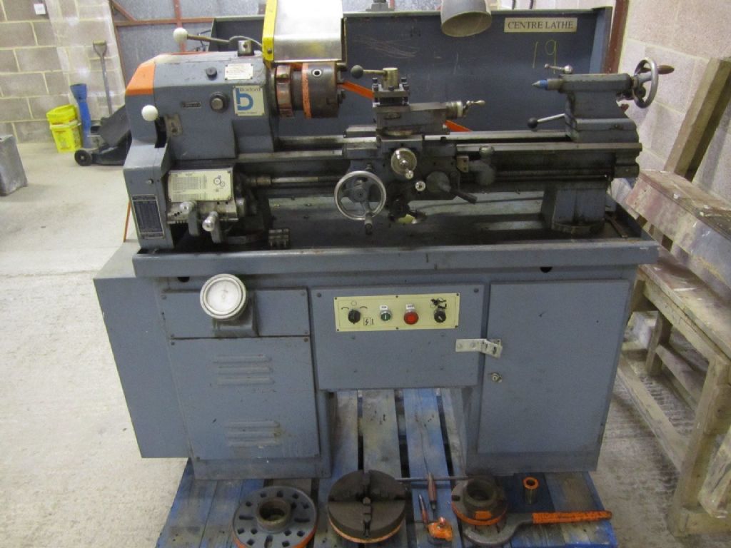

                        Just Spotted this on EBay and metric
                        Current Bid £850
                        eBay item number: 321550989305
