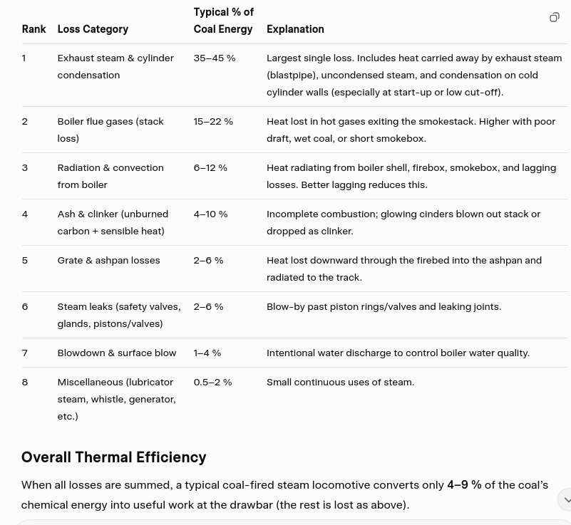

                                Well chaps, the aim of the competition is:
                                “The winner will be the driver of the locomotive returning the highest thermal efficiency“.
                                The organisers establish thermal efficiency by measuring distance, mass moved and mass of coal burnt.  No rivets  counted!
                                If Michael wants to win, a few extra % make the difference.  Insulation and hand-pumping pumping are two easy ways of improving efficiency.  Gets difficult after that, and then there’s no room for under-thinking.
                                Always best in engineering to put numbers on phenomena.  Anyone disagree with these full-size averages:

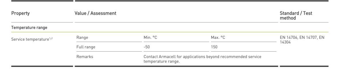

                                    According to the interweb, armaflex max service temperature is 110C, higher than expanded polystyrene, but not as hot as a boiler. Rockwool would be my choice, but work out the most efficient thickness, probably less than you’d guess.
                                    #826009
                                      On duncan webster 1 Said:
                                      According to the interweb, armaflex max service temperature is 110C, higher than expanded polystyrene, but not as hot as a boiler. […]
                                      They do offer an HT version
                                      https://www.armacell.com/en-GB/htarmaflex
                                      #826305
                                      duncan webster 1
                                        @duncanwebster1
                                        And max temp for that is 150C. a boiler at 100 psi will be at 170C.
