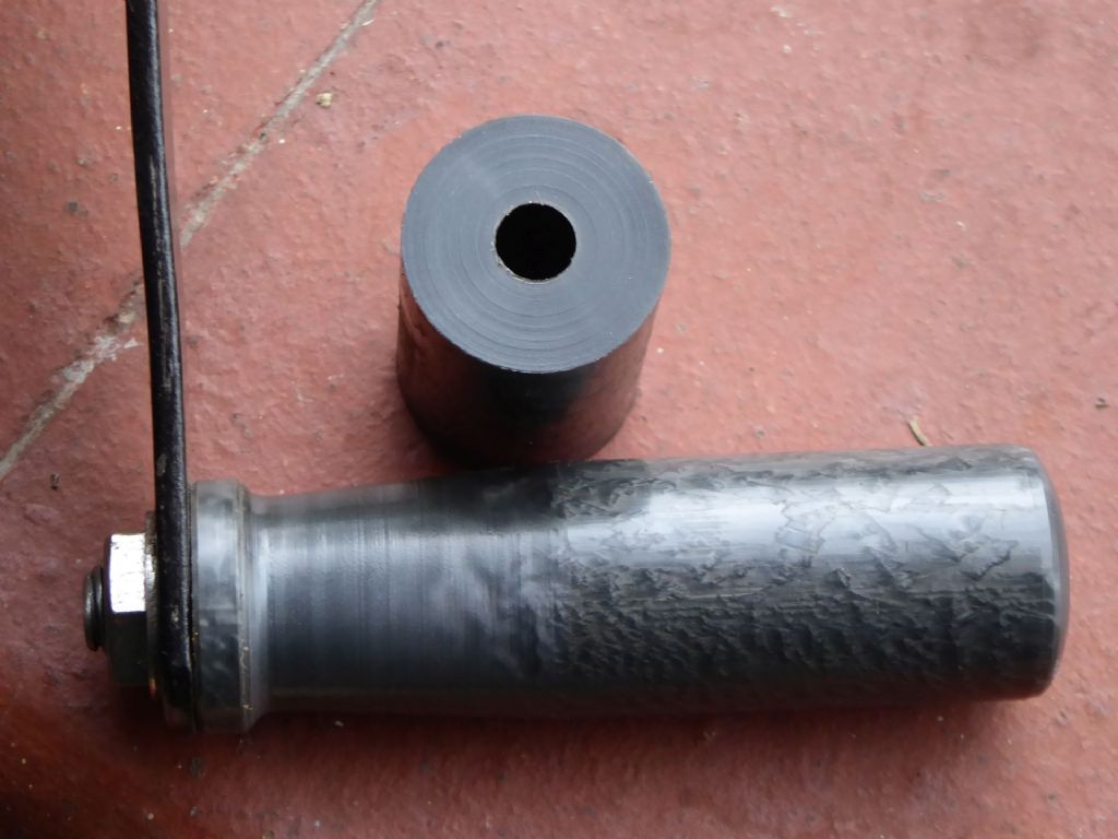

                                  Gary Wooding
                                    @garywooding25363
                                    Here's a photo of a handle I made from a piece of Nylatron rod. As can be seen in the short upright piece, the mottling is not very deep.
                                    #215194
                                    Douglas Johnston
                                      @douglasjohnston98463
                                      Hi Chris- I would love to post a picture of the delrin but I have recently installed windows 10 and my old card reader has stopped working with the computer. Just had a good look at the delrin and the mottled surface appears to be extrusion marks on the surface and looks a bit similar to the nylatron picture but more banded.
                                      Doug
