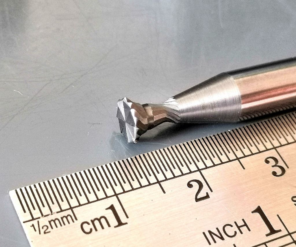

      Picked up this cutter in a joblot of other stuff. On first glance I thought it was just a small dovetail cutter. On second glance I can see it has a small step on the ramped part of the dovetail and also it has flutes on the bottom face. What would this be used for? Gear cutting perhaps? It is made from solid carbide and looks expensive.

          Revers sice chamfering tool on CNC. for deburring the far side?

            Posted by S.D.L. on 04/07/2020 17:19:04:
            steve
            Why the corner rads?
            Tony

                Again, why the corner rads?

                  Probably for interpolating this groove form on a CNC machine:- Dovetail Seal Groove
