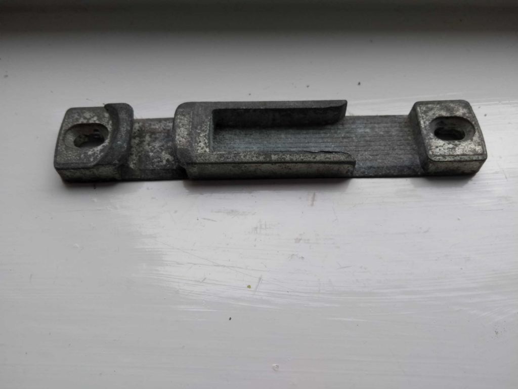

      And where can you buy them?
      #432929
      Iain Downs
        @iaindowns78295

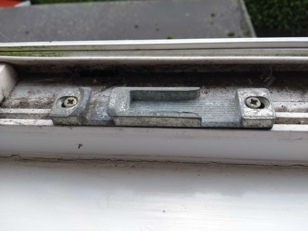

        I know what it does – it's part of the catch system for a double glazed window. However, google is not being my friend here (or amazon or ebay) as I don't know what they are called.
        And in place
        I'm sure you all think I should get out my calipers, draw up a plan and make one out to mild steel, but I have neither the patience (nor probably the skill) to hack up something which probably costs a pound to buy! If only I know where!
        Many thanks in anticipation.
        Iain

          Try searching for window keeps.
          Mike
          #432932
          Journeyman
            @journeyman
            Try a search on Espagnolette Bolts and the bit you are looking for is called a keep. Often referred to as espag locks.

              Hi, have at look at Window Furniture

                You could try somebody like handlesandhinges.co.uk

                  **LINK**
                  try here It’s a Fuhr item
                  Mike

                    You cant try ***HERE***
                    Withou looking further I found a variation.
                    For searching I used "window keeps GU" , being GU one maker of PVK keeps.

                          Oddly cheaper on ebay from the same source £9 inc P&P

                            That’s a good spot Bill, looks like Iain is sorted.

                              Especial Gold Stars for Mike and Bill for (astoundingly) finding just the right piece and then finding it cheaper! (Yes, Yorkshire).

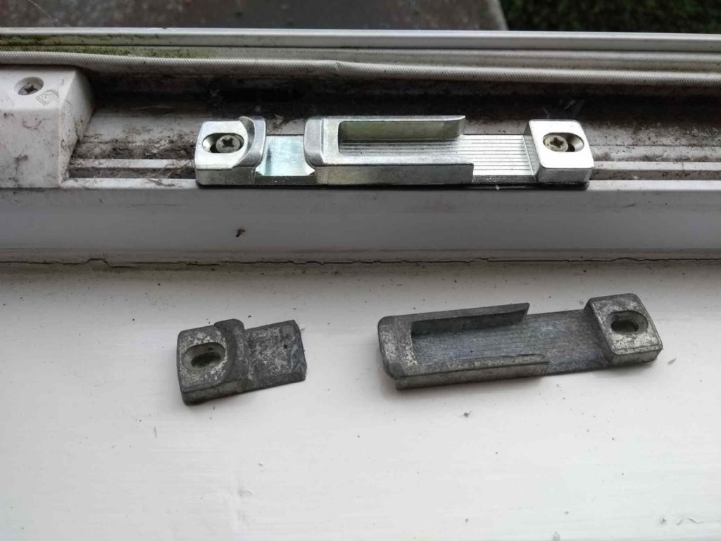

                              #434031
                              Iain Downs
                                @iaindowns78295
                                And just to complete the circle, here it is fitted in place.
                                The window still needs a little 'help' when opening, but it's much better than it was.
                                Thanks again to all who helped.
                                Iain
