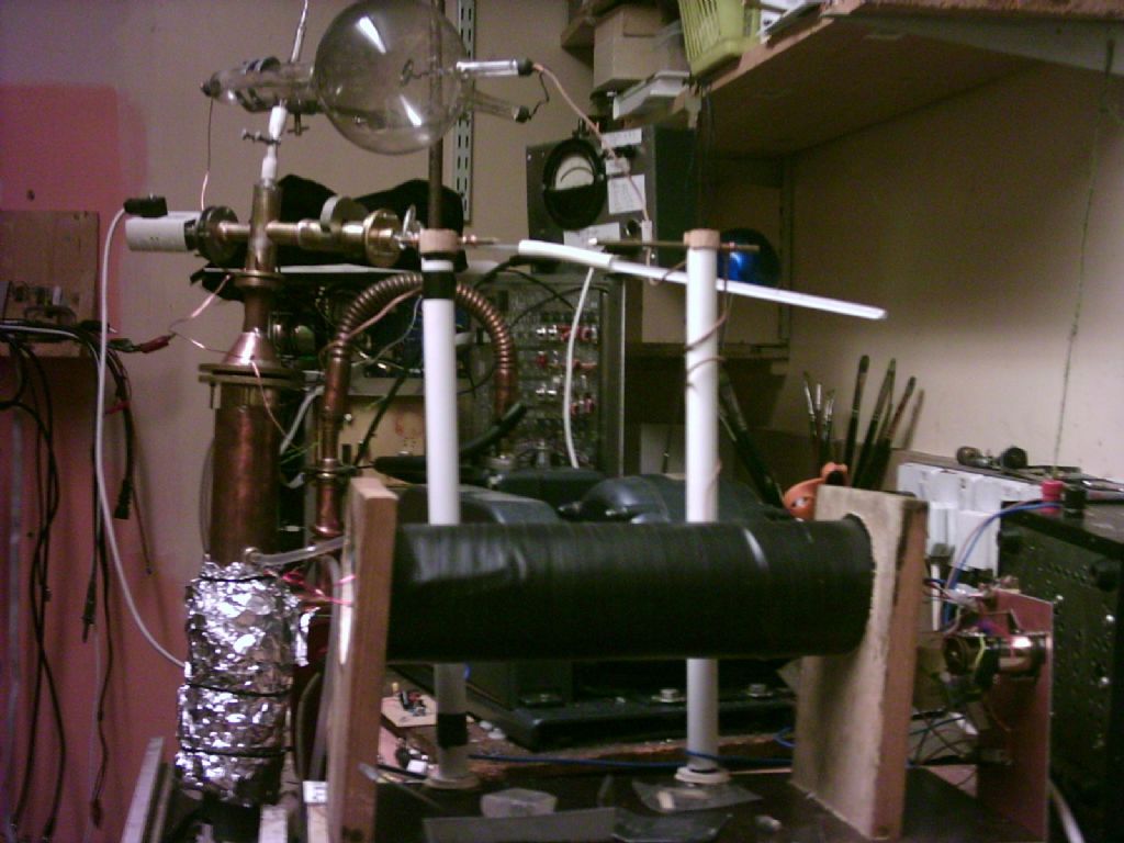

                    I do agree that my workshop is my own and my responsibility and I will do as I jolly well please in it. I have usually found the dangerous jobs go OK, it is the simple things that catch you out. Do what you like but try not to hurt anyone – the coroner or the lawyers may have harsh words to say.
                    Here is a picture to warm the cockles of your hearts – repumping an old Crookes Xray tube about 8 years back. The copper item is a single stage diffusion pump to a 1920s design, in the background is the homebrew vac gauge and the old Edwards mechanical vane pump lies rigth at the back. The white tube hanging out on the right is a capillary tube controlled leak – Crookes tubes need some air in them – a really good vacuum is no good. The spark coil is the big black object below with a motor interrupter to its right. The heater was a 2KWatt theatre lamp run on a variac and a water cooling pipe can be seen emerging from the diff pump. This was a bit Heath Robinson even for me but it did work and delivered the classic apple green glow. I did stand outside when running the tube…. and I am still kicking. Yes I know it was dangerous and I probably broke a few regs too.

                      Roger I am sure you are aware of all the hazards in the above setup.
                      Few would be…but …those who might follow your lead might be less well informed…
                      MadameCurie messed about with chemical radium pretty much all her life..yet voluntary work with one of those tubes during WW1 is probably the cause of the cancers that killed her at if I remember a venerable age.
                      I can see in that setup other things that would worry me first..before the X rays ..flying glass for one….but your workshop your risk..and good on you.

                                The X-ray equipment reminds me of an old (pre ww2) copy of Hobbies magazine, there was an article on how to build your own X-ray plant, the tube was adapted from an old vacuum incandescent light bulb. Dad had built it and got an X-ray of his hand on a photographic plate. If you thought that was a bit too dangerous, they also had articles on making your own fireworks. Alas the old magazines are long gone. Ian S C
