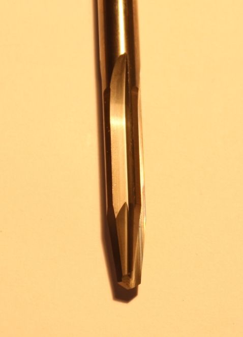

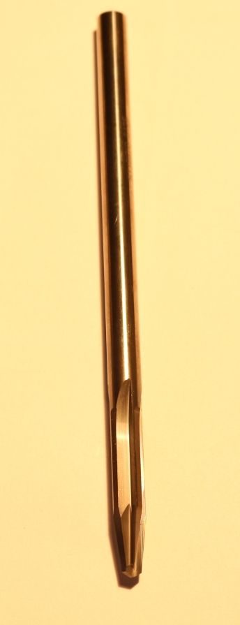

      reamer long.jpgreamer short.jpgHaving been out of touch with modern engineering techniques and tooling for a good number of years now I am frequently coming up against stuff I have no knowledge of.
      A good example is shown in the pics. I bought nine of these solid carbide drill/reamers of various sizes from the car boot for a few quid. All are brand new and the one shown is the largest at 8mm diameter. I have never seen anything like these cutters so I seek enlightenment.
      They are made by UK company Lomas and as far as I can make out are for use on exotic abrasive aircraft plastics – am I right? If they are unable to machine steel or brass they will not be a lot of use to me and may as well be moved on.
      Is there a particular reason why the shanks are so long? The one pictured is 150mm long and its part no. is ST1257B-3125-60-1. It is described as ""VHM drill reamer". What is VHM?

          I would guess that VHM = Very Hard Metal
          Whatever … that's a lot of useful-looking Carbide !!

            That number brings up a few results, including this page. One is for a different tool tech reamer which re-googled brings up an ebay seller who doesn't know what these are and a few links that suggest they are 'drill reamers'. I suggest spinning one up and pushing it into a small pilot hole and seeing what happens!
            Assuming you survive the experiment, please report back to us!

              Looks like they are the one shot drill/reamers designed for composites like glass & carbon reinforced plastics. The tapered drill end is probably less likely to snatch and lift the layers of reinforcement.
              **LINK**

                Neil, at risk to life and limb I pushed one of these through a piece of 1/4" steel plate (no pilot hole) and it was like cutting butter. Following this barbaric treatment I had a quick peak at the cutting edges under the microscope. There was no sign of any damage.
                By the way, I know the pics show that the tools have a gold coating — it's my light bulb that does that, they are the usual dark grey of carbide.
                I have twigged that the "3125" bit of the part number is the diameter in 'thou's of the reamer ie .3125" . The others are .166" and .201" all seemingly non standard but maybe not so in the aircraft industry.
                BAE might not buy their tooling on eb*y but if they do……………yes
                Rik
