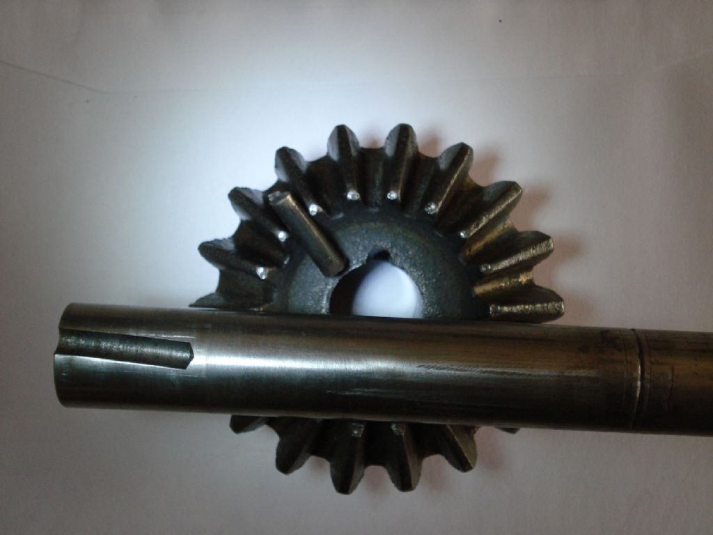

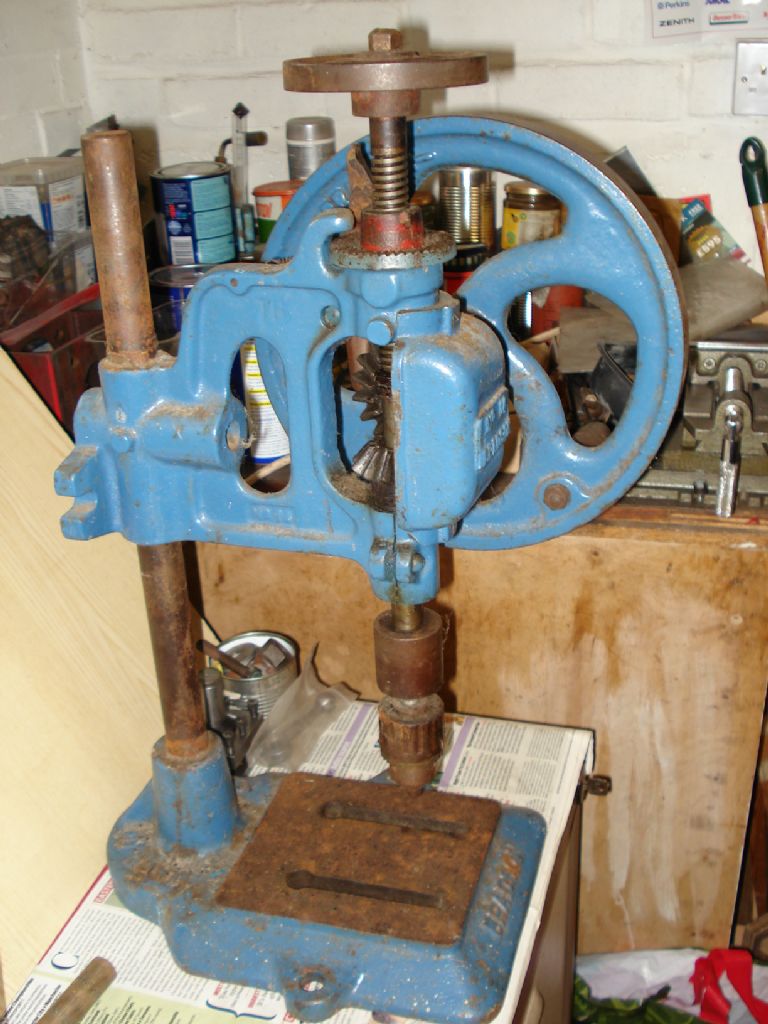

                        Assorted jobs done on the refurbishment of this Vintage English Manual Bench Drill-
                        fully stripped down to component parts.
                        Pressed out the worn/damaged Main Drive Shaft from the 'Pin Locked' Bevel Gear-
                        Prepping for making new shaft.

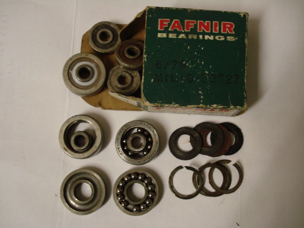

                        Pressed out Main Column from Base Plate and located some replacement 5/32" Ball Bearings from replaced 'End of Life' Civil Aircraft Bearing stock I have from back in the 70s-
                        Also replaced the 1/2" x 20 UNF Chuck mount on the end of the Main Spindle. Enjoying this little refurb.

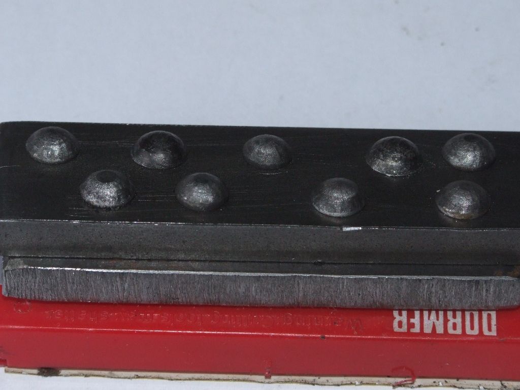

                              I've been experimenting with closing 3/16" steel rivets prior to riveting the spokes on my traction engine wheels. I am using a home made guide and snaps. I first tried closing by hand, with mixed results. This evening I unexpectedly had some time spare so I tried closing some rivets using my flypress. That was after I'd notched the shelving upright behind the flypress so I could swing the handle. embarrassed
                              Here are the results:
                              The bottom plate is 6mm, the upper is ¼". On the front row the rivet on the right was closed by hand. Success on the first trial! However the next two closed by hand (on the left) were a complete fudge up. In addition the snaps left marks on the plates. The middle, and one to the right, rivets in the front were closed with the flypress. Not perfect but not bad at all, at least to my eye. And no marks on the plate. On the slightly fuzzy back row the middle rivet was done with the flypress, the others were by hand. So three out of three for the flypress versus one out of seven by hand, ie, hitting it was a hammer. At the very least I think the flypress techique will be fine for the front wheels where the formed head will be on the inside.
                              An afterthought – for the rivets closed by the flypress the top snap didn't quite reach the top plate. The rivet is slightly (4 thou) under the theoretical length, but I wonder if I made it shorter by another few thou the head would be better formed? I'll try and give that a go ASAP. It shouldn't take long so I should be able to fit it in over the next week or two.
                              Andrew

                                  Andrew, I think the flypress does tend to help stop the rivit going off to one side better than a hand held snap so you do get a more consistent result and there is no chance of the snap tilting and marking the surface. Are you using a single snap to close the rivit or a conical one before the rounded one? You can grind the end of the hand snaps back at a shallow angle and round the edge to help stop them marking the surface.
                                  Good thing with the press is the neighbors won't need ear defenders.
                                  I do tend to find that the theoretical length is a good starting point but you need to adjust to suit your own snaps and it will also depend on what size the holes have ended up at and how heavily they have been deburred as the rivit will expand into these spaces which leaves less metal to form the head. By the time you have a few coats of paint on them I doubt a thou will be noticable.
                                  #346433
                                  Anonymous
                                    Jason: Thanks for the notes. Both hand and flypress use the same jig that keeps the snaps aligned, alhough of course there's nothing to stop the work being off. I ground the ends of the snaps some while back, which significantly lessened the marking with the hand method but didn't completely eliminate it. I'm using a single hemispherical snap. I have read the book by Edward George. But I simply don't see how a conical snap would form a nice cone, whereas a concave one wouldn't form a hemisphere? The flypress forms the rivet head quite easily up to a point. Then no matter how hard I swing the handle no more forming takes place. I take that to indicate that the head is fully formed as far as the snap is concerned so there is nowhere left for the metal to flow. So if I take a tad off the end of the rivet the same thing will happen, but slightly lower. The holes are close to size, the rivets need a slight tap to fit, and are lightly deburred. I think my issue is too much metal, not too little.
                                    The lack of noise from the flypress is major plus for me. Although the houses are fairly well spaced on my road the area is very quiet. My neighbours are pretty tolerant, but there are limits! I thought my work bench was pretty solid, but really swinging the flypress has shattered that illusion.
                                    The rivets need to be perfect; you know what some people at SCMTEG are like; they don't feel satisfied unless they can point out the errors in ones work. wink 2
                                    Andrew

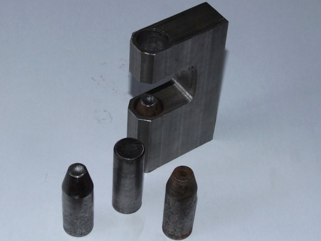

                                      Anonymous
                                        Flying has been cancelled this afternoon on the wishy-washy grounds that there are snow showers, and the rather more serious issue of the airfield being waterlogged. So I've grabbed a couple of hours to do some more riveting trials (in one sense, if not both).

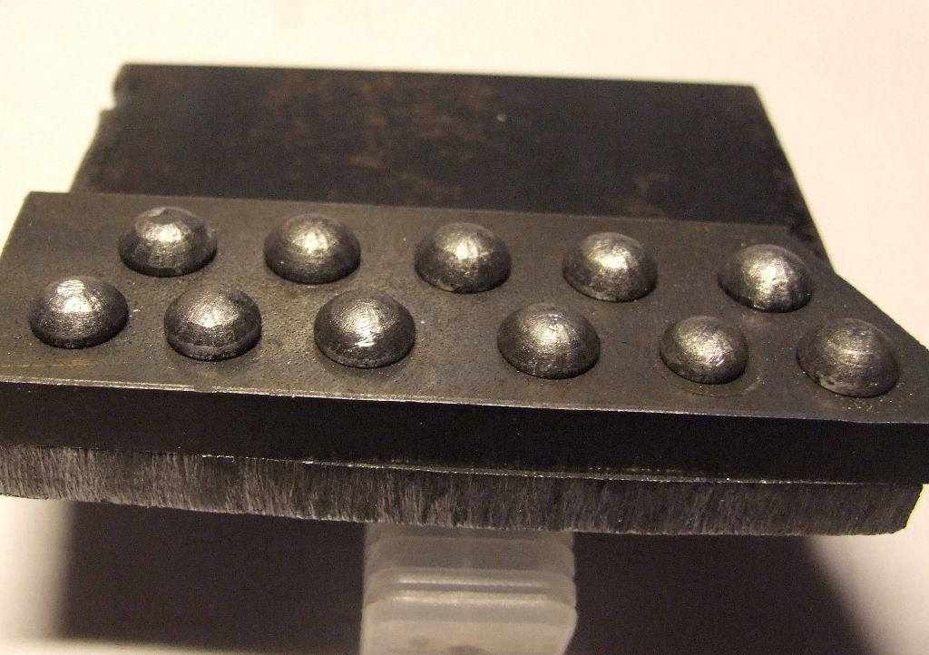

                                        As an aside here is the jig I am using:
                                        And the results of the riveting:
                                        The results are not bad, but not perfect. There are a couple of outliers that aren't really acceptable. I experimented by shorting some rivets, ranging from a couple of strokes of the file to about 20 thou. It didn't seem to make that much difference. I suspect more experimentation is required.
                                        Andrew

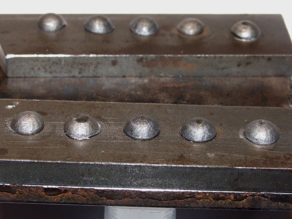

                                            Another riveting episode:
                                            Starting from the front row on the right the first rivet is full length. Clearly there is too much metal for the snap to close the rivet flush. The next rivet left is about 60 thou shorter; here there is not enough metal to form a proper head. So at least that sets limits on the length. The rest of the rivets going left and then to the right along the back row are experimenting with lengths. The rivets start about 0.890". Running down the back row I started at 0.870" and removed a few more thou each time, ending up at 0.855". This seems about the right length. In due course I'll add another two rows of rivets to the back of the plate above, to see what consistency I can achieve rivet to rivet.
                                            If that looks good I'll set up the Britan to knock out a batch of shortened rivets, after I've finished the rivet bolts for the smokebox.
                                            Andrew

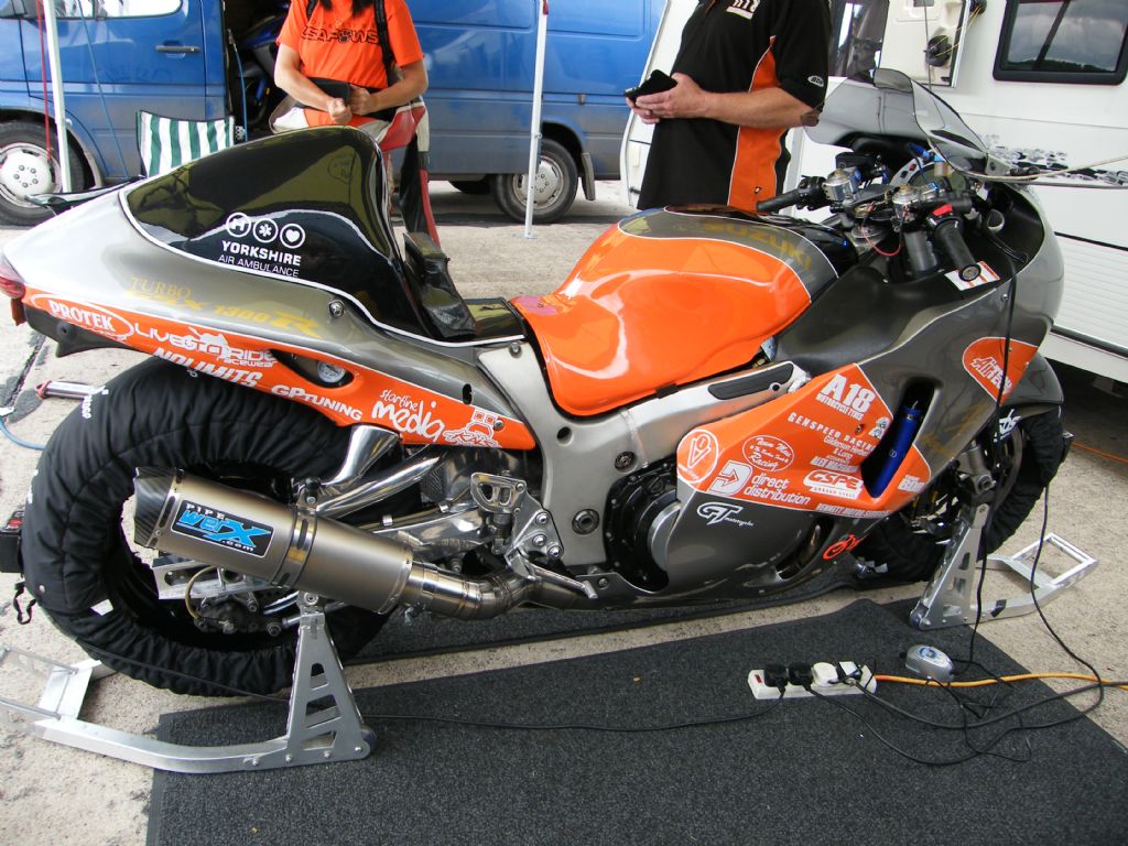

                                              Tomorrow Elvington calls the Straightliners team have been setting the timed American mile course and conditions look good.
                                              Will see if the fastest Granny can better her record of 264 mph on her bike the air should be denser but wind has to be the deciding factor for runs at that speed.
                                              This machine is her new one after crashing the record one a few years ago.

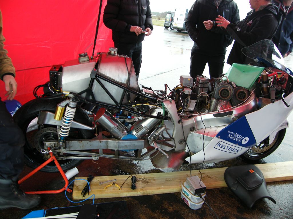

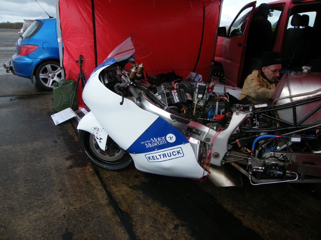

                                                A lousy wet start to Elvington top speed meeting but what a surprise I had.
                                                A team from the Isle of Man was there with a steam bike that had only run around an industrial site.
                                                First run was over 49mph the next run over 72mpf the last run something went wrong so could not run.
                                                It had data logger and many electronic control systems the engine was fairly conventional with a flash type generator.
                                                .Engine
                                                Steam bike
                                                #346882
                                                Old School
                                                  @oldschool
                                                  Thats really interesting and it shows some promise for a first time out. A bet that's inspired you Paul.
