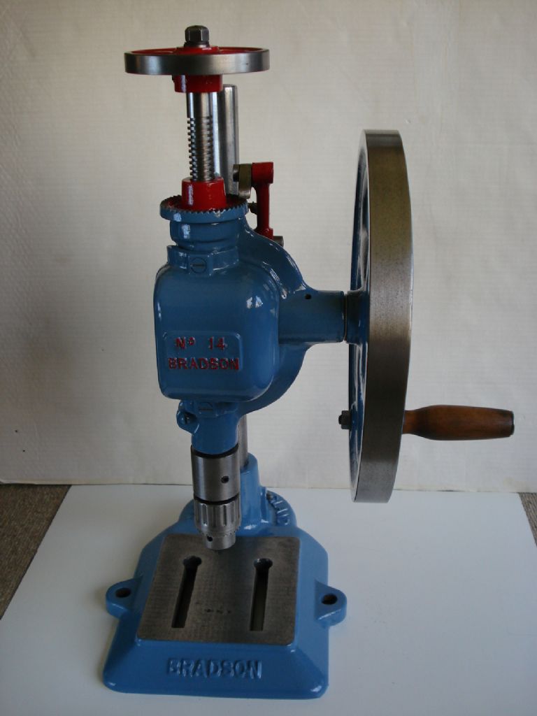

                                  Finished the refurbishment of a free Vintage Manual Bench Drill. Heavy duty version. Only felt the need to replace the Drive shaft and the Chuck mounting –
                                  Looking forward to using it (more pics in album).

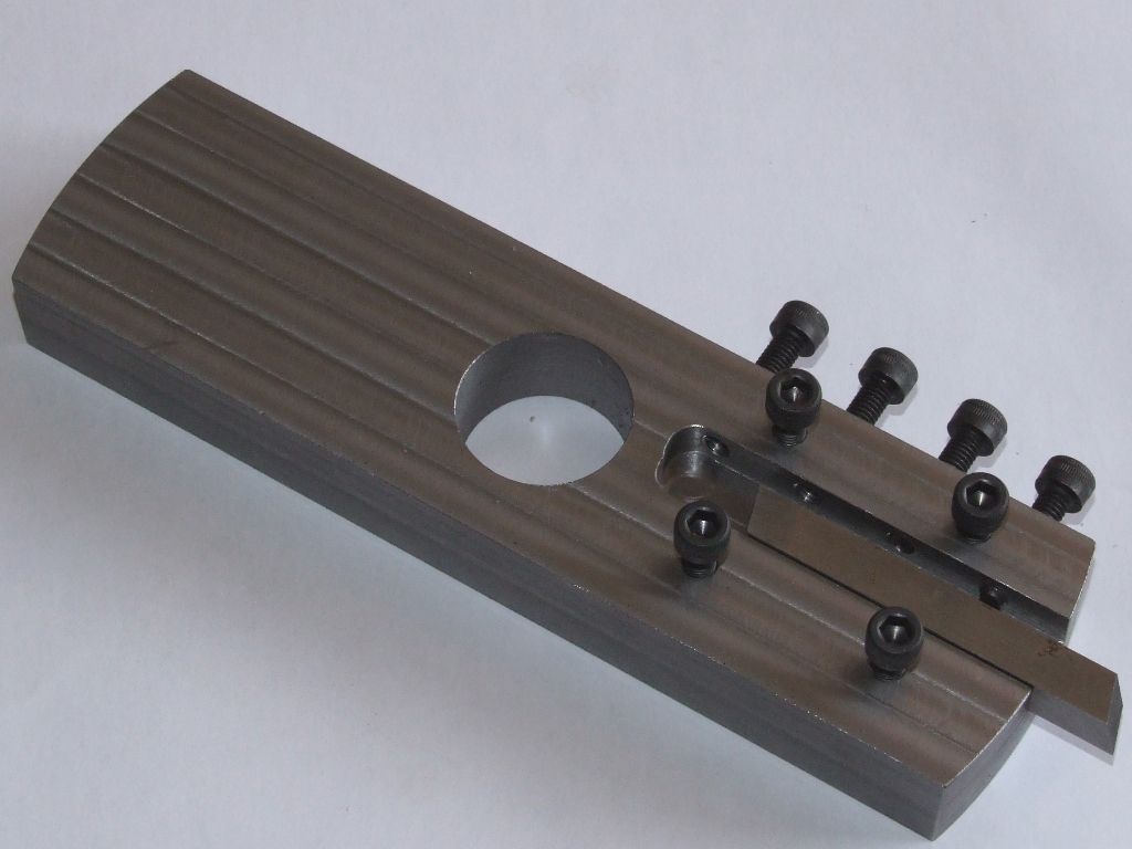

                                    Made a flycutter this morning:
                                    I just need to add a keyway and make a cover plate for the toolbit and then I can flycut the chimney bases, perch brackets and ultimately the cylinder blocks for my traction engines. The outer diameter of the flycutter is exactly 8" and is concentric with the centre hole, which should help with the tool setting.

                                      Nice one Andrew… looking at the pic shouldn't the HSS tool tip be below the holders bottom plane, or am I reading wrong, is it for machining large dia.bores, ( cylinder blocks ) ? … thinking

                                        Posted by Andrew Johnston on 27/03/2018 13:30:09:
                                        Andrew
                                        George -should have gone to Specsavers wink
