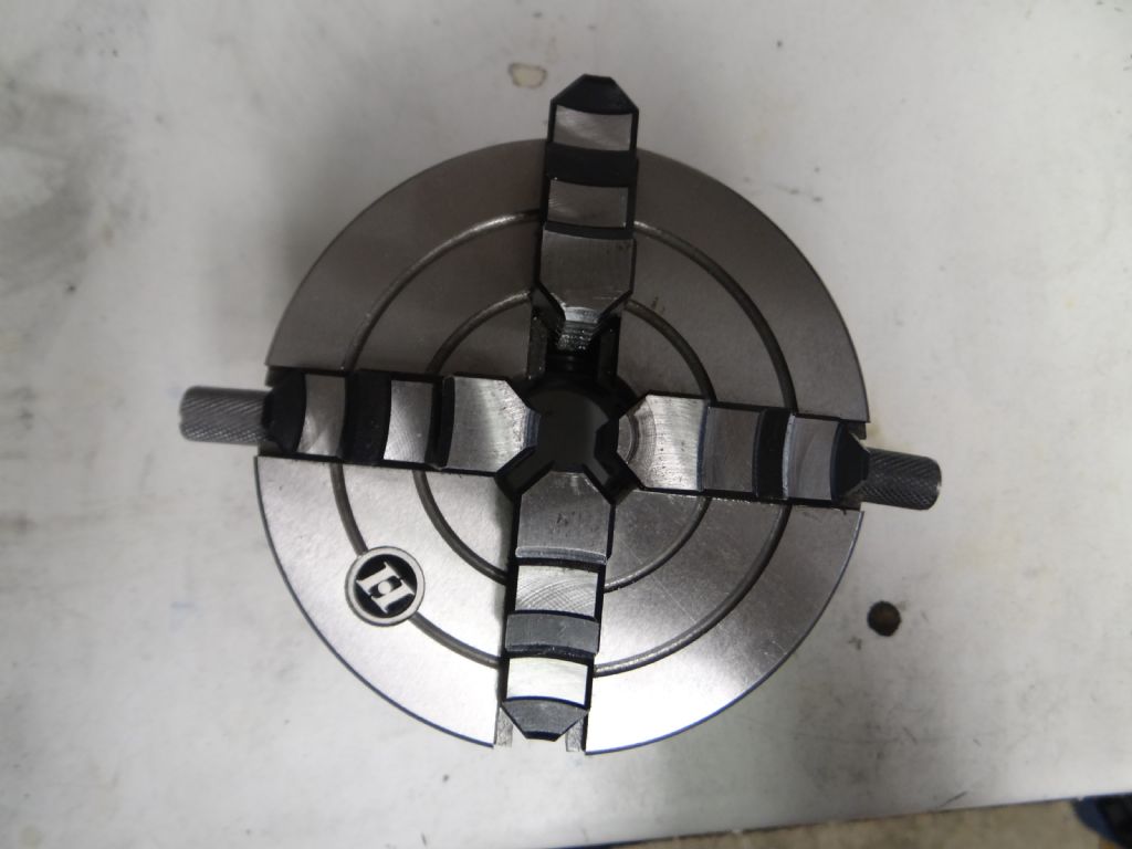

                                            Today I have been punished for being a smart-ass. Yesterday I made a pair of adjusting knobs to simplify setting up a 4-jaw chuck. The ideas is to turn both at the same time to zero in on the centre. As the knobs are short there's plenty of elbow room, and the width provides leverage.
                                            Apart from the bad knurling what could possibly go wrong? The idea is brilliant; my fortune is made.
                                            After squaring off the shaft to fit the chuck, I realise that the s*dding things foul as soon as the jaws clear the body of the chuck. This is a serious design error.
                                            The quick cure was to turn the knobs down so that the jaws will clear them. Hurrah, it works.
                                            Alas, although the adjusters are quite useful for centring in the early stages while the jaws are loose there's not enough leverage to completely tighten them up. Even though the new knurling is much better, the reduced diameter version isn't quite successful either. Now I'm asking why I didn't think this through.
                                            Maybe I should just take up metal detecting as a hobby. It will be a success – there's tons of scrap in my garage.
                                                Hi Dave
                                                Can this disaster be saved by cross drilling the knob, to accept a very short 3mm diameter tommy bar, to provide a bit more leverage; or will a tommy bar get in the way and be inconvenient. Maybe cross drill a couple of times, so that the tommy bar can be re-positioned if it fouls the jaws?
                                                Closely following all your ups and downs laugh. Lol.
                                                Steve

                                                  Posted by SillyOldDuffer on 23/05/2017 18:32:19:
                                                  Nothing wrong with the general principle, Dave, but … as you have discovered; the optimum proportions need to be found.
                                                  • Make the squares a fairly snug fit in the sockets, and then longer shanks won't feel so cumbersome
                                                  • Make the devices out of hex socket screws, or put hexagons on the end; and then you can tighten with an Allen key, or a socket wrench, as appropriate.

                                                      Regarding the pair of stubby chuck keys, I can't find the picture at the moment but I saw a pair on MEM forum that had the shank (your knurled part) long enough to clear the jaw when it was fully would out and then a plastic handle/knob about 2" dia. This gives you enough to grip and you can apply a good amount of pressure when the other two jaws ate getting tight on teh work to move it against them.
                                                      Once you start having to juggle extra tommy bars or allen keys it all starts to get a bit of a fiddle. Though I would suggest the twin keys are used to get things close and then the normal key used to finally tighten and fine tune.
