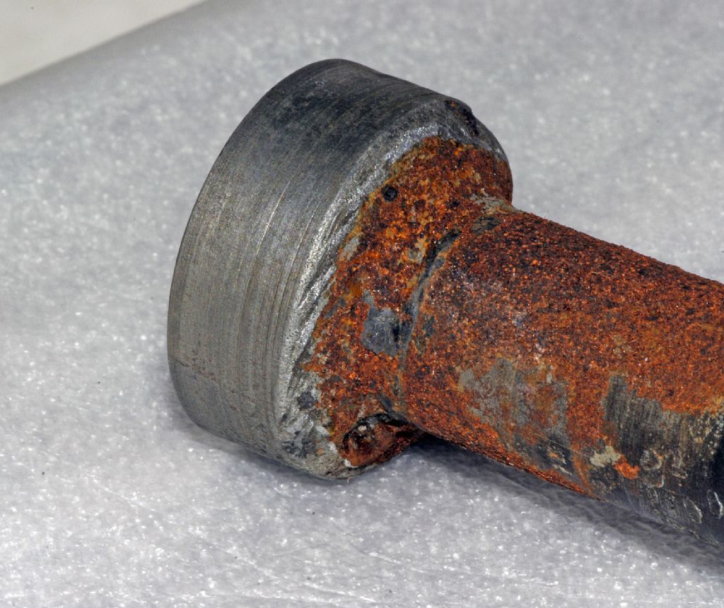

      Tried a little experiment over night using double strength Orange Barley Water as a rust remover. Quite surprised by the result. This part had the same rust amount all over and just the clean end shown in the photo was immersed in squash over night.
      Ed.    Edit: Forgot to add, it was used neat, not diluted.

        Probably the citric acid content of the orange ingredient did the work.

          There's a challenge -who can find the most unlikely rust remover? – If there is something less likely than orange barley water…

            Either of the popular cola drinks on the market work well, look at what they do to a coin after a couple minutes immersed in either of the main brands on the marked.

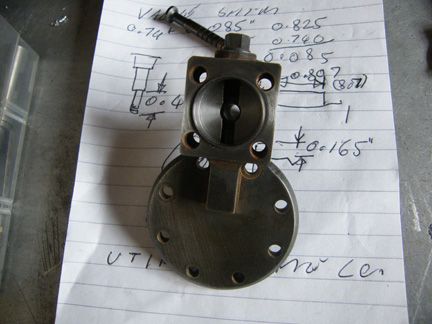

                          Apart from PC problems managed to get back to the flash steamer to repair cylinder head and make new valve seat and guide not too hard but so many other things to do.
                          Will make a separate seat then press into the head shown.
                          Generator to weld up then all the various settings to alter its aerodynamics.
                          Have to decide what to do put the canards back on and alter prop skeg angle or put the big wing on the front.
                          Did 127mph with the wing on but found out later steam pressure was down due to the cracked valve seat but drag must have been great.
                          Hope to be ready for Kingsbury on Sunday but time is in short supply then the following Tuesday will be at Elvington with the top speed brigade.
