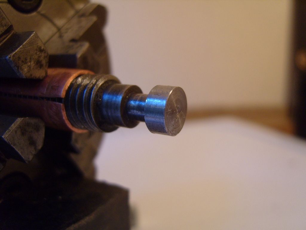

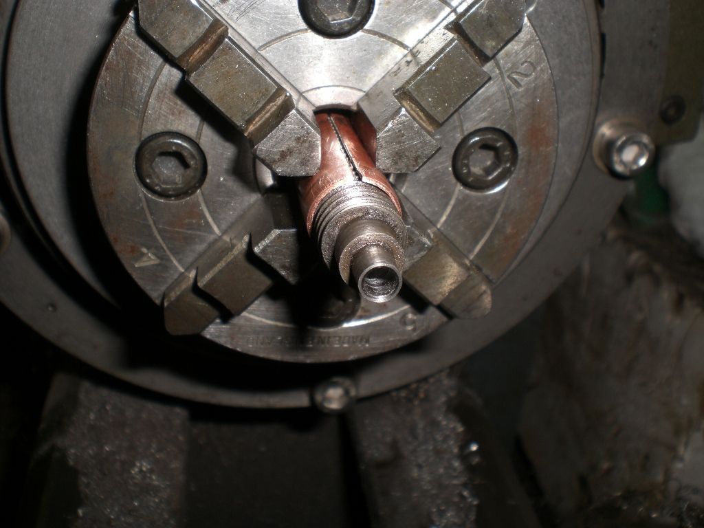

            Hi, today I finished making a special backplate four my Boxford lathe **LINK** This was to hold a small four jaw chuck to hold this broken table adjusting screw from my Yankee bench drill.
            Yankee Drill Press 1005
            The first stage of facing off the broken end and drilling a 4mm hole 20mm deep was achieved with success using my completed special backplate.
            This backplate may seem to be a bit OTT, but I have no other way of holding the adjusting screw true without risking unrepairable damage to it.
            Regards Nick.

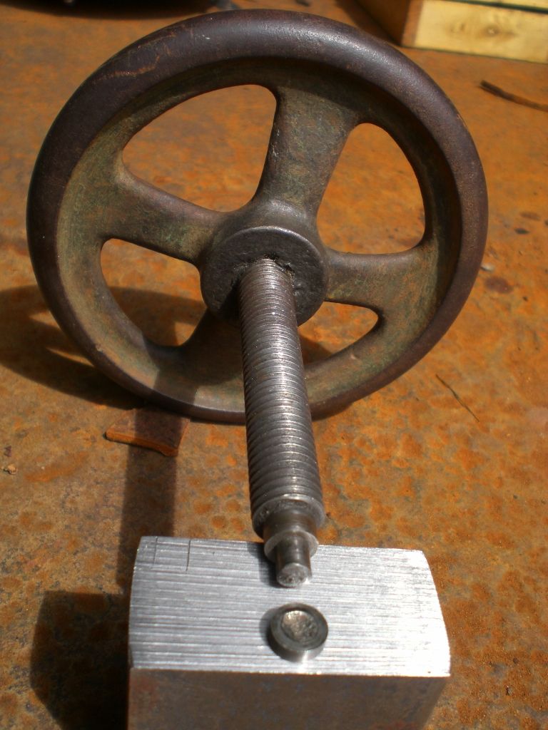

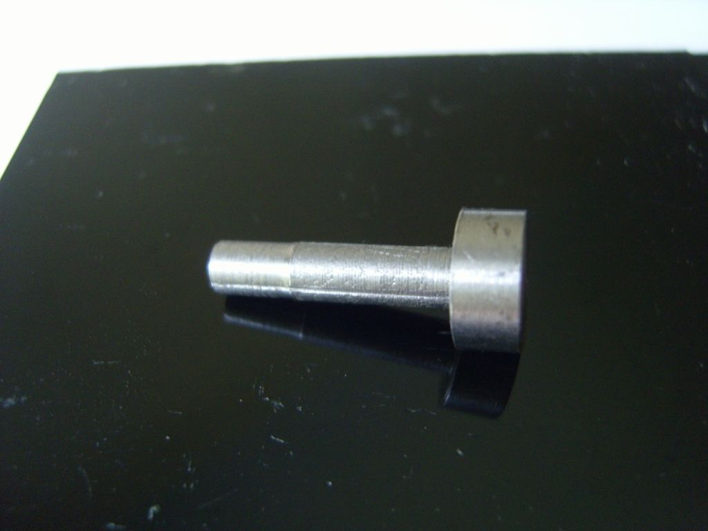

                                    Hi, this evening I made a new part to fit the table adjusting screw for my Yankee 1005 bench drill. It has been made with a piece of silver steel.
                                    The new part has also been Loctited into 4mm hole drilled into the end of the screw thread, note one of three grooves cut into the pin to allow the air to escape without forcing all the Loctite out of the joint.
                                    Tomorrow evening when the Loctite should have had plenty of time to be fully cured, I will turn it to finish size.
                                    Regards Nick.

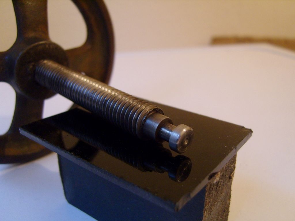

                                              Hi, this evening I successfully turned the new part to size which I Loctited into my Yankee bench drill table adjusting screw yesterday evening.
                                              Regards Nick.

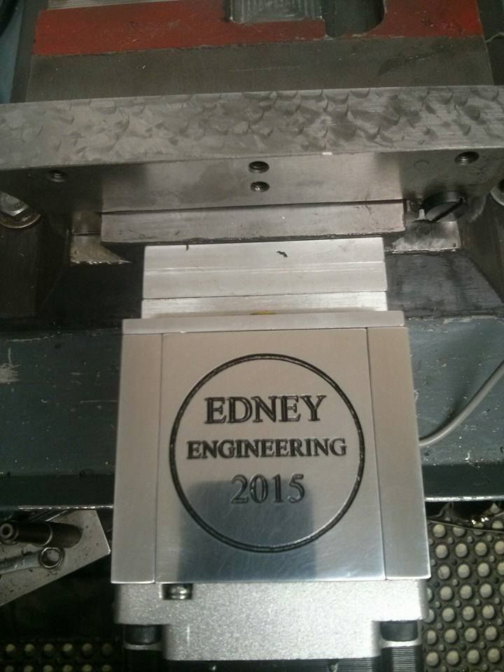

                                                      Made some progress on my CNC conversion –
                                                      E-Stop switch all mounted
                                                      11826014_10154139225066040_8795492809269154117_n.jpgWas surprise by my friend Murray yesterday when I picked up the spacer plate he had milled for me. Very nice engraving
