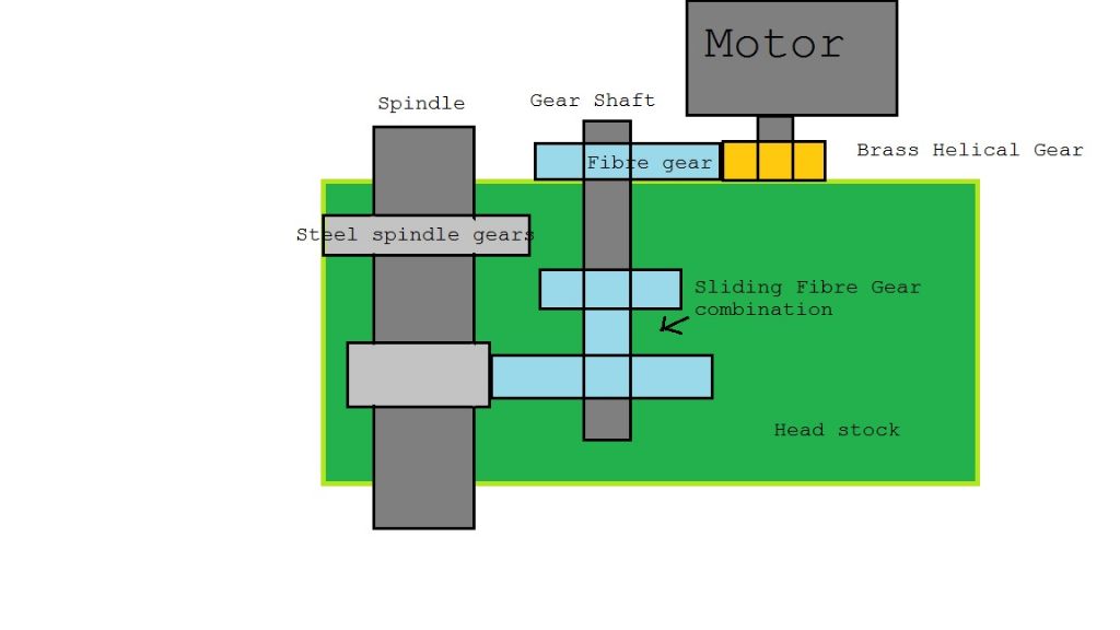

                                My WM 16 has only had 2-3 hours very light use on plastic & a bit of drilling. I have just started machining steel with it. Not had much luck but that is another story. However when milling a piece of free turning mild steel 12 mm wide * 2.8mm deep at 650 RPM with a 12mm end mill feeding very slow the machine suddenly stopped. Cannot recall if it was motor or just drive.
                                When I backed off from the work I re started & it ran very noisily & only about 150 RPM. I changed from H speed gear to low & it then ran Ok. went back to H again & it ran ok but slightly noisier.
                                If I wanted to have a look at this offending plastic gear some have mentioned, to check for meshing, can someone fill me in on how to find it before I rush in blindly in please.
                                It may be that it just jumped out of the main gear change( as suggested by an earlier post above) but I am not sure if that would explain the low RPM afterwards – or would it?-I only ran it like that for a couple of seconds & thinking back it may have been simple friction rotating the spindle
                                I would like to look inside first just for self satisfaction but where to look first would be useful

                                  I've been an owner of your model for a couple of years now, and seen off a fair few jobs under it's belt. I think it's capable with it's 750watt DC motor, however, mine eventually broke, after replacing fuse after fuse, i either blew the circuit box or the motor, either way i ended up taking one of my AC induction motors (with a VFD too) and basically bolting it a base and securing it with some angle iron.
                                  I don't have any running problems with this now, and i've heard alot of other users say it was the best modification they did to it. I'm not recommending you do this, if i had a working one i would've stuck with it, it could certainly handle steel but maybe not such a deep cut with that size of end mill.(You could probably afford to ramp up the speed a bit, i'd go for full power on low gear, about 1000 rpm, to get the best of the motors abilities, on low speed you're limiting the current)
                                  If you halved that depth it would probably be okay. End mills can take facing cuts much better than plunging ones, as i'm sure you know, slot drills are more suited to that.
                                  Have you checked with a torch in the oil sight to see if the engagement on the train is good? If it is i would leave it alone, but if you really want to get in there. You need to open a hatch, secured by 4 screws, that sits behind the headstock, you can get to this by rotating the head round, i would'nt recommend taking the whole head off as it would be a pain to get back on again. Don't worry about aligning it up again as there is a "positive stop screw" to ensure it sits vertical, only a feature on the newer models i think?
                                  You can get at all the gubbins that way, i have taken this gear train to pieces before so any questions don't hesitate to ask. should be an acronym for that. DHTA.

                                    I've made a basic picture of what the setup is like inside, it's fairly self explanatory but basically the sliding fibre gear part moves up and down as you twist between high and low, and sets up the right gear combination. How far it moves is down to the space on the shaft and a steel fork that moves the gear, which is connected to the switch.

                                              I removed the grease cover & shone the torch in & saw the 2 gears. Glad I did this as you suggested because although it is not the cause of the graunching noise it did highlight that in high gear the gear was only just engaging & that I have to turn the gear knob far more than indicated on the dial. So thanks for that bit of info
                                              However, i sometimes turn the mill on in low gear & the machine fails to rotate properly making a horrible sound .
                                              If I turn the gear to high & then start it again it goes. Then if I stop it & go back to low it starts Ok. This has happened about 3 times so far. I have been away sailing so have not tried it much in the last few days.
                                              No idea what it is but it could be something major building.
