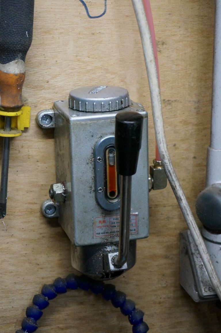

                    the oiling system is a pump from arc some pipe a 3 way connector and fittings into each nut…the pipes are a bit of a pain to route so they dont get trapped on the travelling of the ways

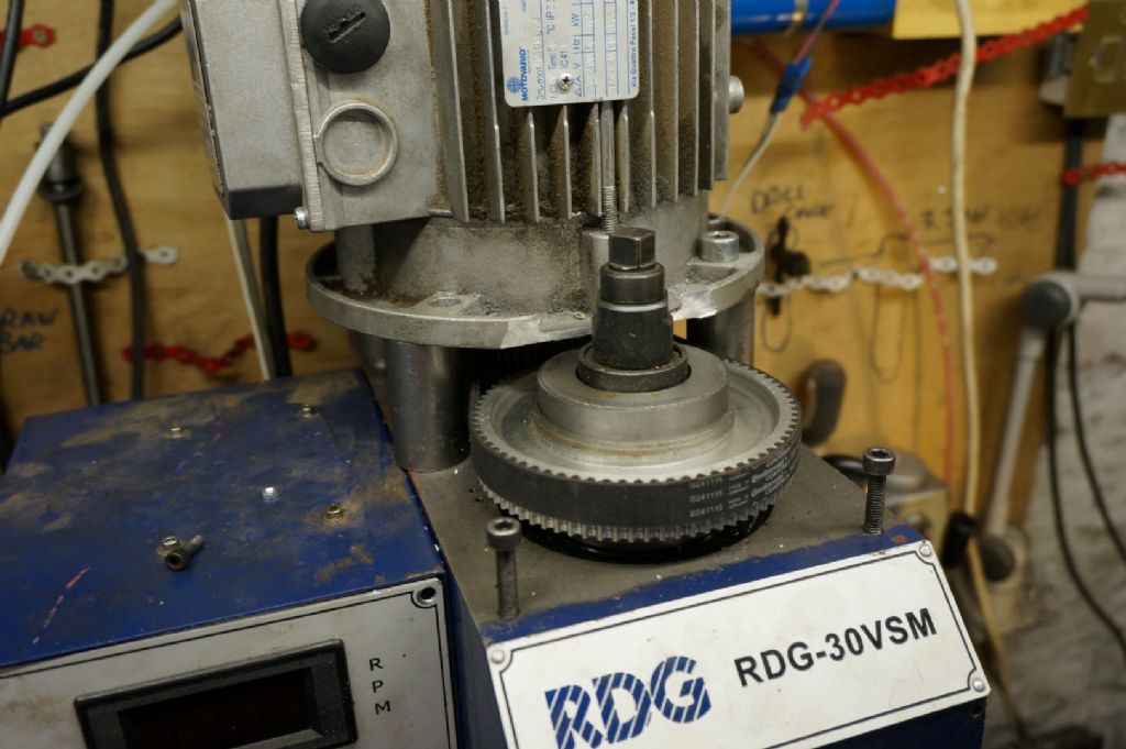

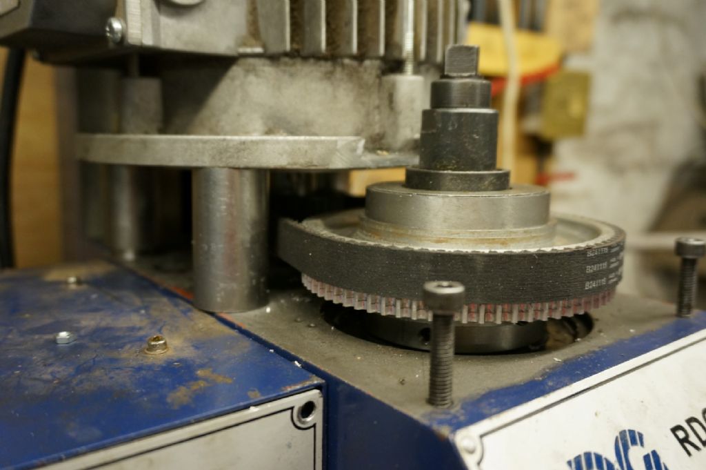

                    The motor and belt drive is here its a 1440 rpm 1.5kw 3 phase motor with a 35 tooth 15mm wide 5 mm pitch htd belt and the pulley on the spindle is a 72 tooth
                    the gearbox is removed completely
                    the tacho drive is relocated to between the 2 gears left on the spindle
                    Guard removed for photo held on with the screws visible in front of the front  pulley

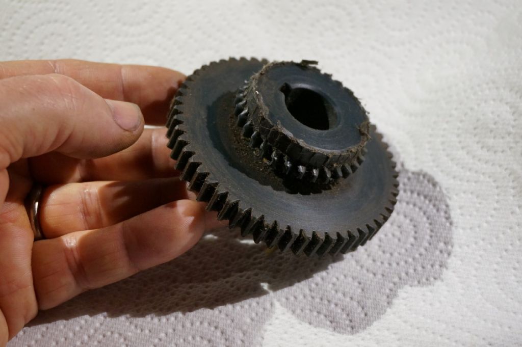

                              I did take some photos of this messed up gear but they are far too blurry being so dark to be of any worth. Its an extremely lightweight plastic, not like peek or delrin but fairly flimsy feeling. I dont dare mess around with taking the head off and the normal running gear looks to be in good order so i've put the mill back together for now and packed it out with some molislip grease and hope and pray that it'll hold out on normal running mode.

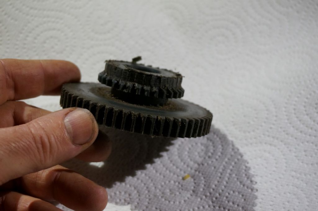

                                is this the same as your gear?
                                this is how mine wore out as the teeth were not fully in mesh
                                Having said that the one that i have spare which has been in 3 years or so is like new after solving the engagement problem

                                  That wear pattern is precisely the same as mine, theres only a little bit at the top left holding it all together, i take it you bought another gear from parts service? it seems as though that the "lifting" mechanism on the side is not seated fully when selected and causes the gear to wear out because its only half engaged. Its promising that after 3 years its still in good order

                                                      Just to clarify why my gear broke
                                                      as above i felt the gears into mesh by hand
                                                      the only trouble was that the detent ball on the engagement switch held the gears only half in mesh
                                                      I was doing a job after only having had it 4 weeks and it started hesitating and within minutes had lost all drive
                                                      on stripping down it was apparent what the problem was
                                                      RDG did send me a new gear FOC and listened to my concerns about the crappy assembly of the gear chain
                                                      since fitting new gear and adjusting mesh correctly it was fine
