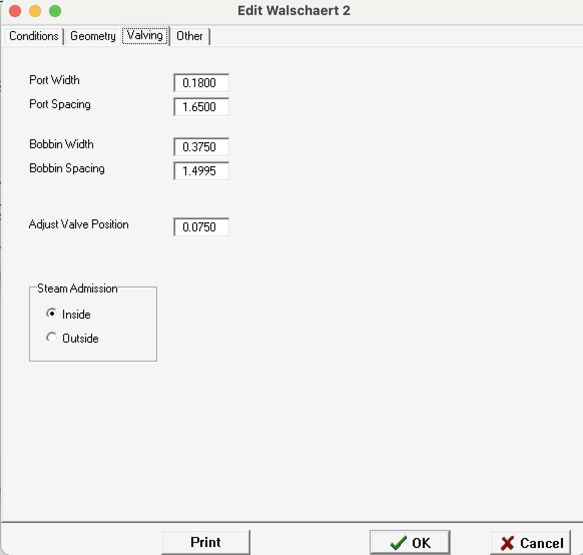

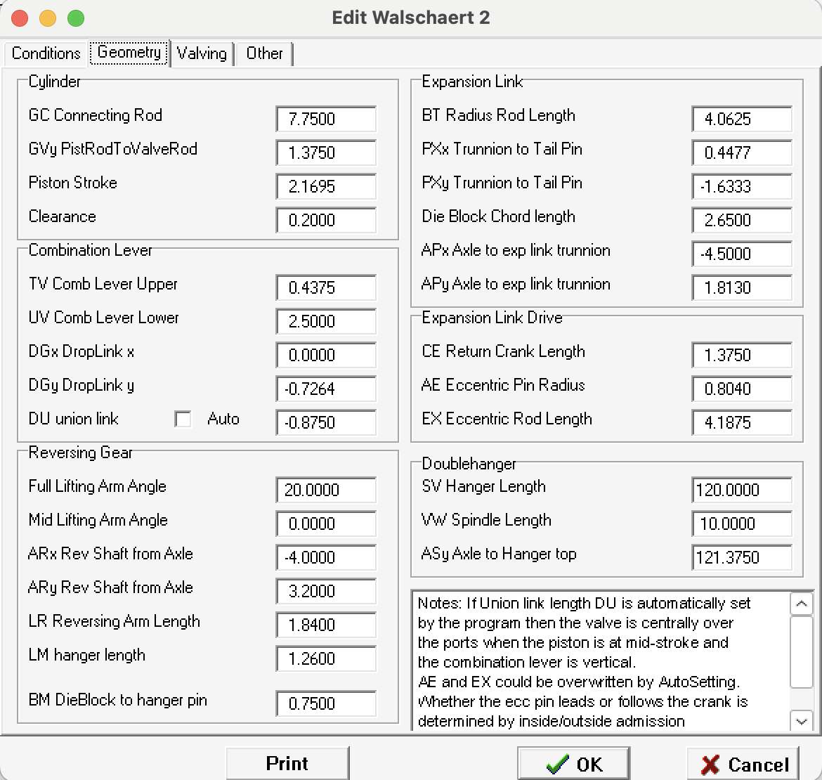

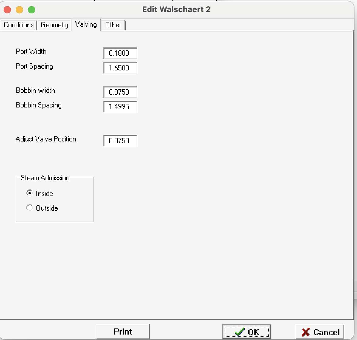

      Kevan, I have found it sometimes takes a lot of trial and error to optimize the valve events. If you e-mail me screen shots of the 4 sections of the “Edit” tab with your dimensions filled in (Conditions, Geometry, Valving, and Other), I will see what I can do with it.
      #852964
      Kevan Shaw
        @kevanshaw32462
        John,

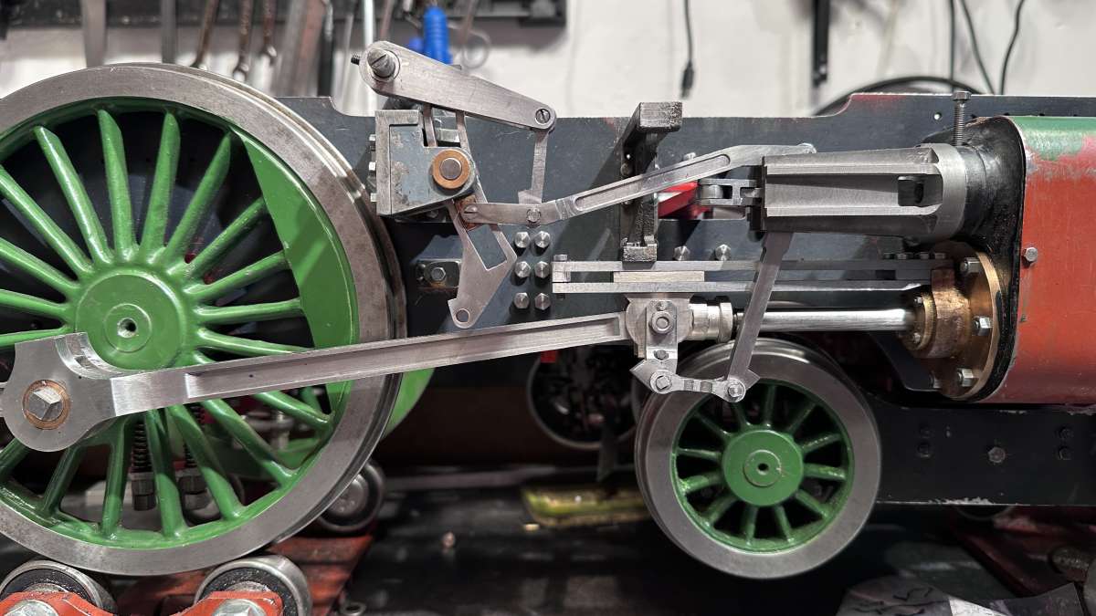

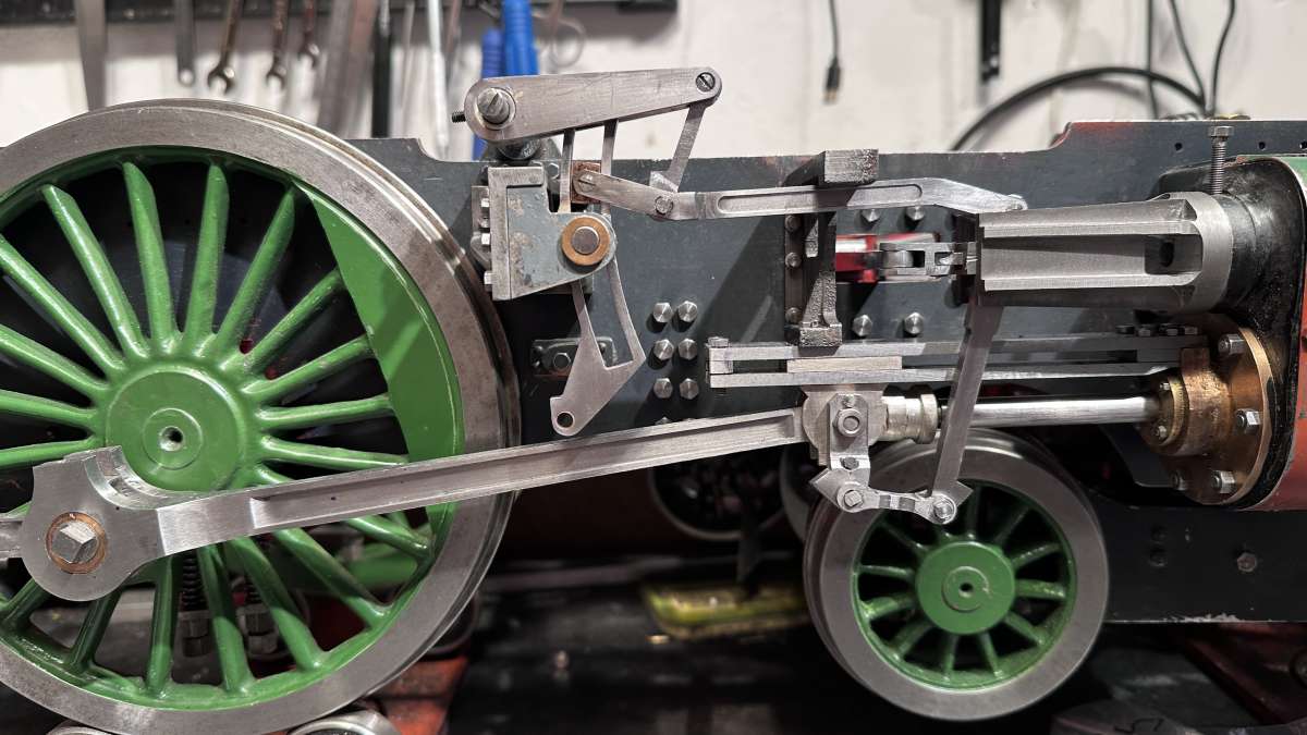

        Here are the settings using dimensions from the engine and the modified valve gear from an actual working engine.Screenshot 2026-06-21 at 21.11.31Screenshot 2026-06-21 at 21.11.45Screenshot 2026-06-21 at 21.12.05
        Here are a couple of photos of the gear as installed. There seem to be some issues that limit the movement of the radius rod. in forward the radius rod hits the conjugating gear link in reverse it is constrained by the bracket for the slide bars that I have already cut back as far as I can to make more clearance.
        I think that the return crank radius in the calc will also cause a clash between the expansion link with its mounting bracket!
        IMG_4277IMG_4278
        Thanks for helping with this:)
