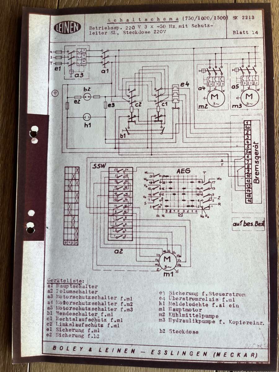

      Hello Hans
      Yes, please do send a copy of the wiring diagram. I know it’s hard to take a picture of the nameplate … on my lathe there is a hatch at the back that provided the best access, but it still took a few tries with my phone to get a photo I could use. I haven’t tried pulling the motor out of its cabinet, and would rather not, or at least not yet.
      Thanks in advance
      Jim
      Hello Jim
      here the page from my Leinen manual. Perhaps it is helpful. Unfortumately I can’t take a pictore of the motor. The access door is blocked by a heavy table.
      Leinenschema
      Leinenschema2
      Kind regards,
      Hans

                                    IMG_0943
                                    #853294
                                    Andrew Kett
                                      @andrewkett50664
                                      Jim, If the drawing you have is correct, the outlet socket would have 400V across it on a 400V 3ph supply. That presents a serious danger.
                                      Hans’ drawing shows it (poorly) as a phase to neutral connection giving 220V.
                                      The Transformer in the drawing Hans has supplies the coil voltage to C1 and C2. (probably 220v but maybe 110v or 24v)
                                      If the motor really is 220v 3ph it will need a 220v 3 phase supply,
