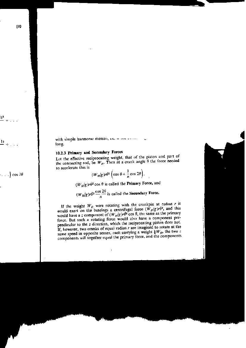

                                              @howardlewis46836
                                              A most interesting engine, very well changed from drawing to hardware.
                                              A two cylinder version should settle any problems with balance.
                                              180 degree opposed, or primary balanced 90 degree to eliminate any secondaries?

                                              #853107
                                              duncan webster 1
                                                @duncanwebster1
                                                Howard
                                                Sorry to be a Cassandra, but vee twin is not in secondary balance. Straight 6 is, as is a radial.
                                                Might be a definition issue, secondary forces are the result of conrod angularity and vary at twice the rotational speed. For further info see Engineering Dynamics, SAVSwanson page 135 et seq
                                                #853134
                                                Howard Lewis
                                                  @howardlewis46836
                                                  Duncan, a 90 degree V twin is in secondary balance.
                                                  The secondaries act at right angles to the forces produced by the primary balance weights (Hence hammer blow on railtrack from partially primary balanced conventional reciprocating steam locomotives),
                                                  Brough always used 90 degree twins. And they were known as the Rolls Royce of motor cycles.
                                                  A straight six is not perfect. It is effectively two three cylinders, back to back, where the unbalanced forces from one half are equalled and opposed by the other half, so likely to “wriggle”.
                                                  90 Degree V 8s squirm, because the forces from one end of the engine, do not absolutely match the timing of those from the other. (And if a V8 sheds a primary balance weight, you need to be elsewhere before it happens!)
                                                  The Lanchester harmonic balancer improved four cylinder in line engines by rotating separate balance weights, in opposite directions,  at twice engine speed.
                                                  (We used them on the Rolls Royce C4 and on the Perkins 4.236 family, and on other engines, as well)
                                                  Howard
                                                  #853135
                                                  duncan webster 1
                                                    @duncanwebster1
                                                    Duncan, a 90 degree V twin is in secondary  balance…..
                                                    If you want to disagree with the likes of Imperial College  thats up to you. Swanson was a lecturer there, I doubt he’s got it wrong.
                                                    #853139
                                                    duncan webster 1
                                                      @duncanwebster1
                                                      Here’s a rather poor scan of the relevant page, it does go on a bit…balance
