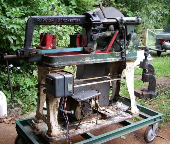

      Here is a photo pre- restoration of the Rapidor Saw.
      Regards NickRapidor 3XM pre-restoration

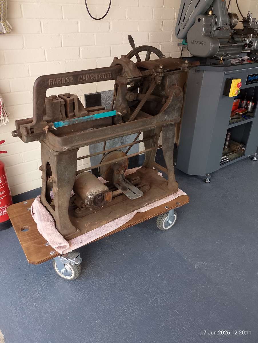

        Hi, this is my one, bought it from a chap in Ipswich 21 years ago roughly, and cost £41.00. No idea of the number, as I’ve never looked for one. I had to change the 3 phase motor  for a single phase one, the start/stop unit came off, as that was also 3 phase, and also that plate affair over the motor also came off, and wasn’t put back, apart from them, it looks much the same, as I haven’t found any need to repaint it, and I probably never will.
        Rapidor
        I also got that No. 2 Fly press on the same day from Birmingham, which cost£57.00
        Regards Nick.

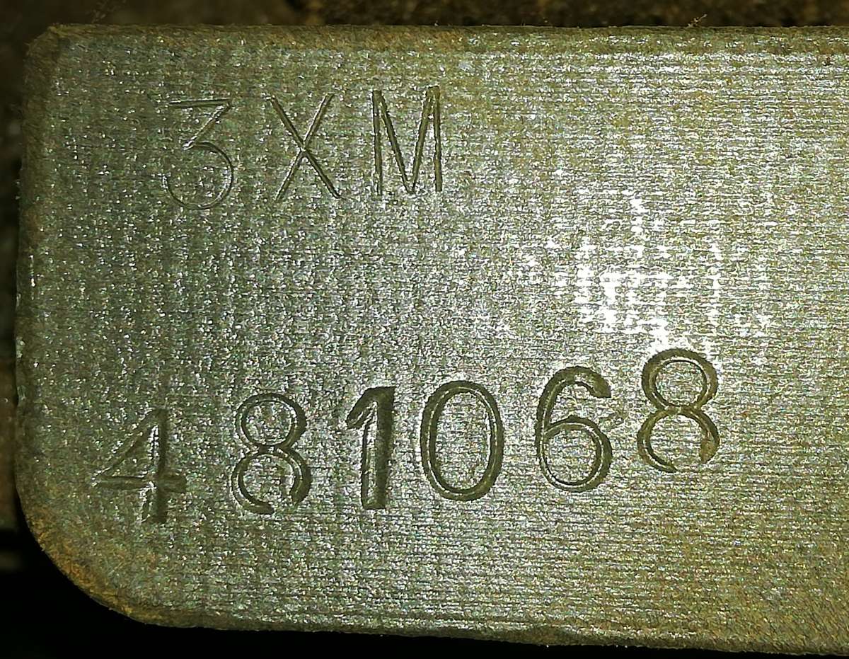

          Nick, yes it certainly looks original! there is some discussion on which way the blade cuts, and on the reverse stroke seems to be the correct way? The serial/model number is on the top of the far left end of the nearest vice way when viewed from the other side of your photo. It would be great if you could find this number as I am compiling a list of serial numbers to try and work out the man. code with regards year and the numbers made – this is the sort of thing you do when you are retired! The Fly press is certainly a useful thing to have – I have seen modern copies of this  – all from chine of course so the castings are prob nowhere near as strong. I do try and buy old school stuff as much as possible although it is getting difficult.

            Hi Nick, had to give it a bit of wire brushing to find it.
            IMG_20260624_091556
            As regards to which way it should cut, the write-up says the automatic relief is on the back stroke, and therefore the cutting is done on the forward stroke, but the crank that drives the coupling rod to the saw frame, should be rotating anti-clockwise, when looking at the side of the one in my photo.
            Regards Nick.

              Serial number on the one I bought to sort out mumble-mumble years ago is 3XM 431661. Stamping font is slightly different to Nick Farrs picture.
