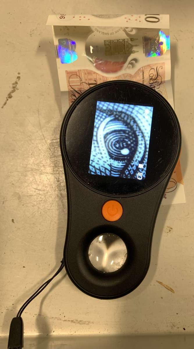

                              #853153
                                I can’t personally vouch for its performance, but this looks a very handy little magnifier:
                                product image grabbed from a Manchester Microscopical Society ‘meeting report’
                                a ‘Google Lens’ search will locate plenty of adverts

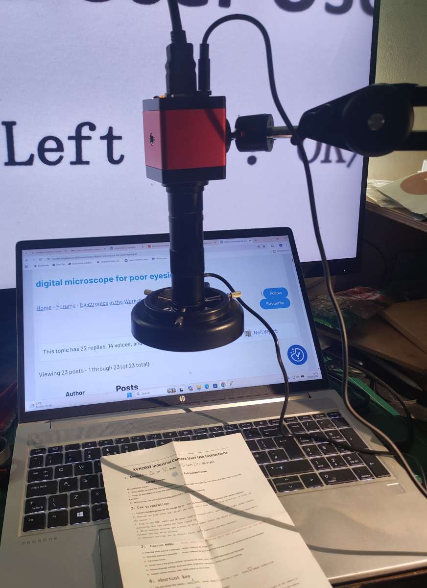

                                                  #853825
                                                  jaCK Hobson
                                                    @jackhobson50760
                                                    Neil’s Cmount suggestion got me interested. I was looking for separate camera and lens but I found a complete kit on amazon https://www.amazon.co.uk/dp/B0DZHM79XP
                                                    I took a punt, as Amazon are really good about returns if you change your mind.
                                                    The thing works much better than the USB solution I have or the stand-alone scope+display which both lack colour quality.
                                                    This works in low light which allows more lighting options. It comes with a LED but that isn’t great for colour either.
                                                    The stand setup would be OK if mounted independently of whatever surface you are observing. It isn’t ‘great’ – particularly if you have to adjust the view angle etc, but OK and I’m glad I have it.
                                                    This lens is fixed, not zoom, so you have to adjust magnification by adjusting height away from subject. Cmount lens. Cmount lens adaptor included. I think the chosen lens is about right for fixed focal length for me.
                                                    Wires are annoying, and you need 2 plug sockets if you use the light… so 3 includind a monitor!
                                                    It plugs direct into an hdmi monitor which I like – no need for a computer. Errr… I don’t know how to plug this into a computer if I ever wanted to?
                                                    So far,so good, but I think I’d like a zoom lens and maybe mount this high up.
                                                    Most annouing is that the remote control has one of those battery-saving tabs for transport… but no battery?!
                                                    I’m keeping it.IMG_20260628_111602
