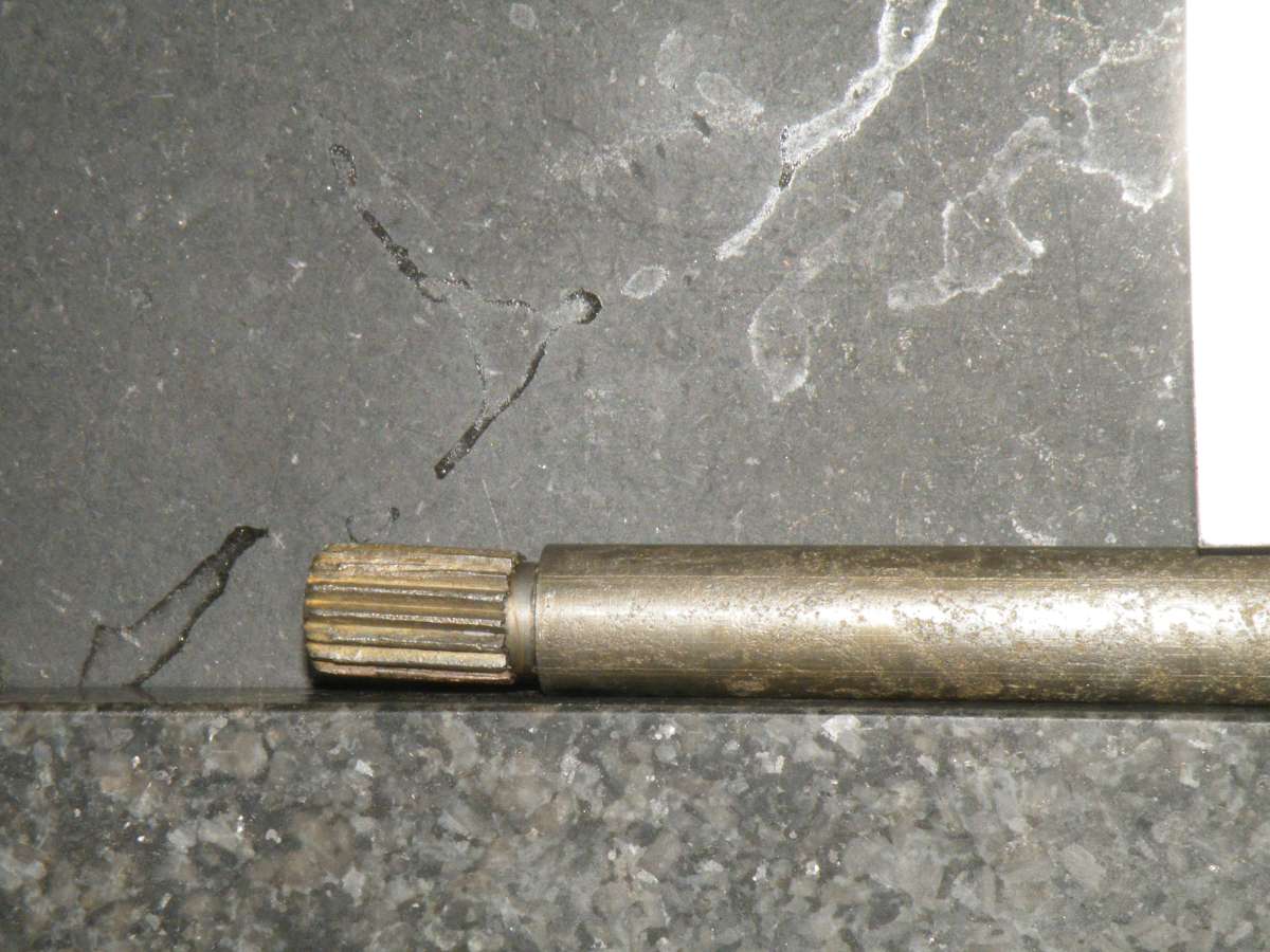

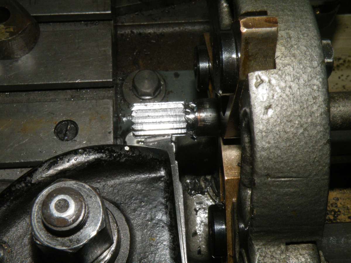

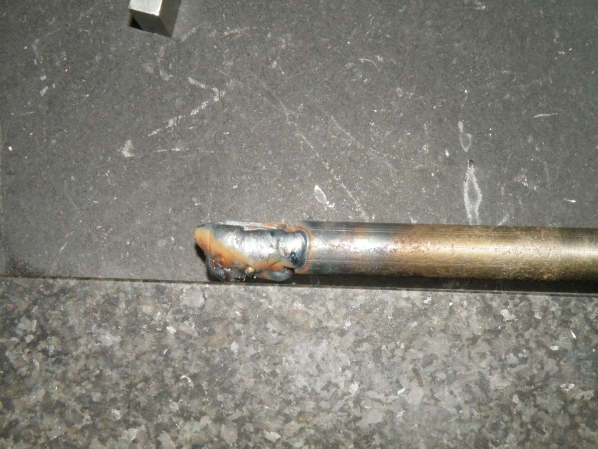

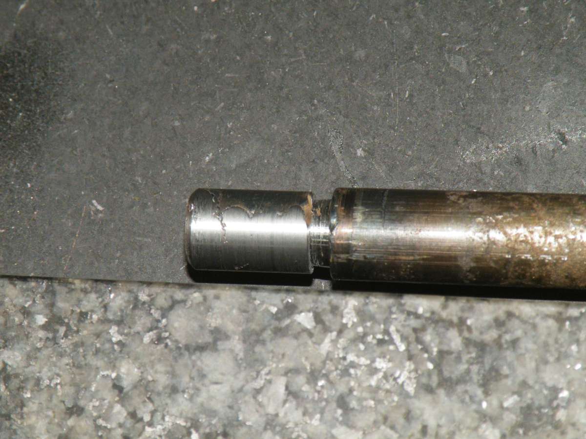

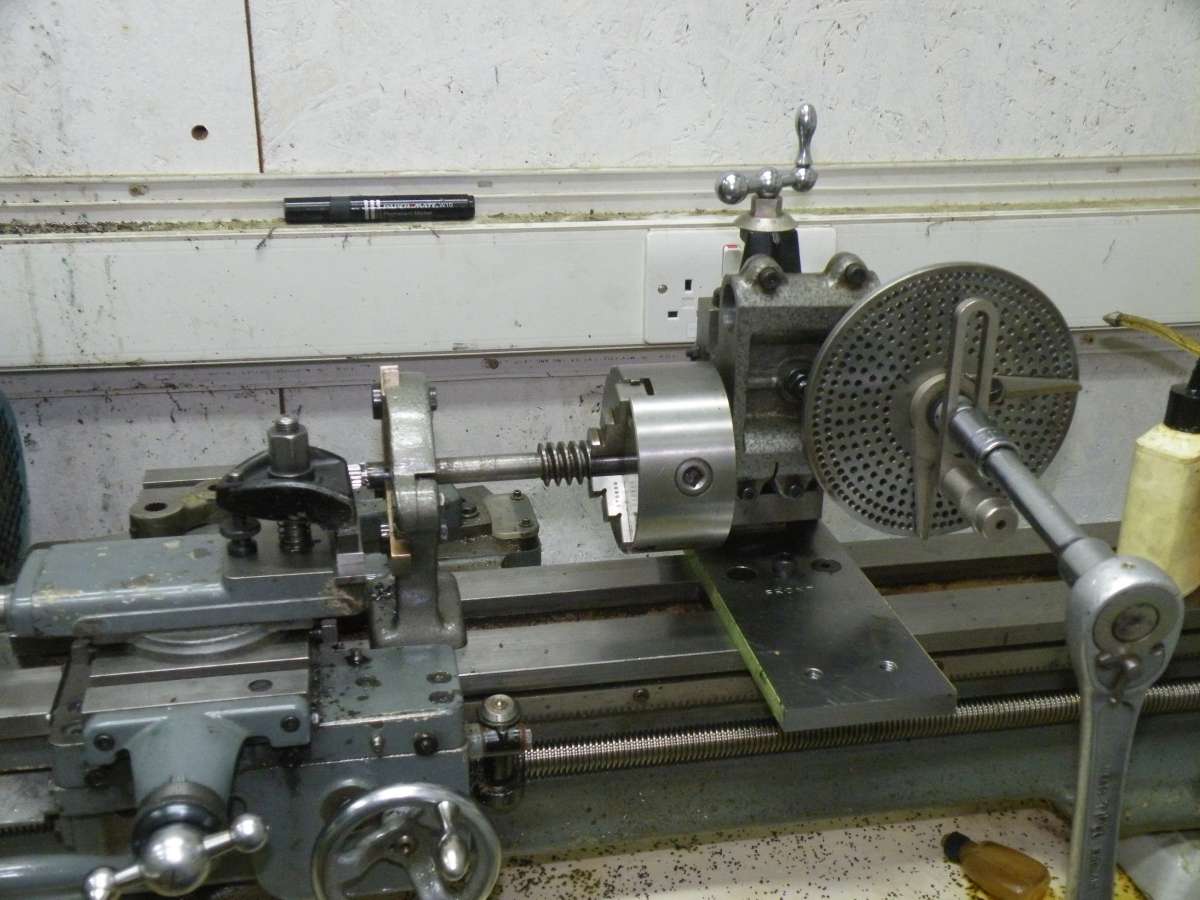

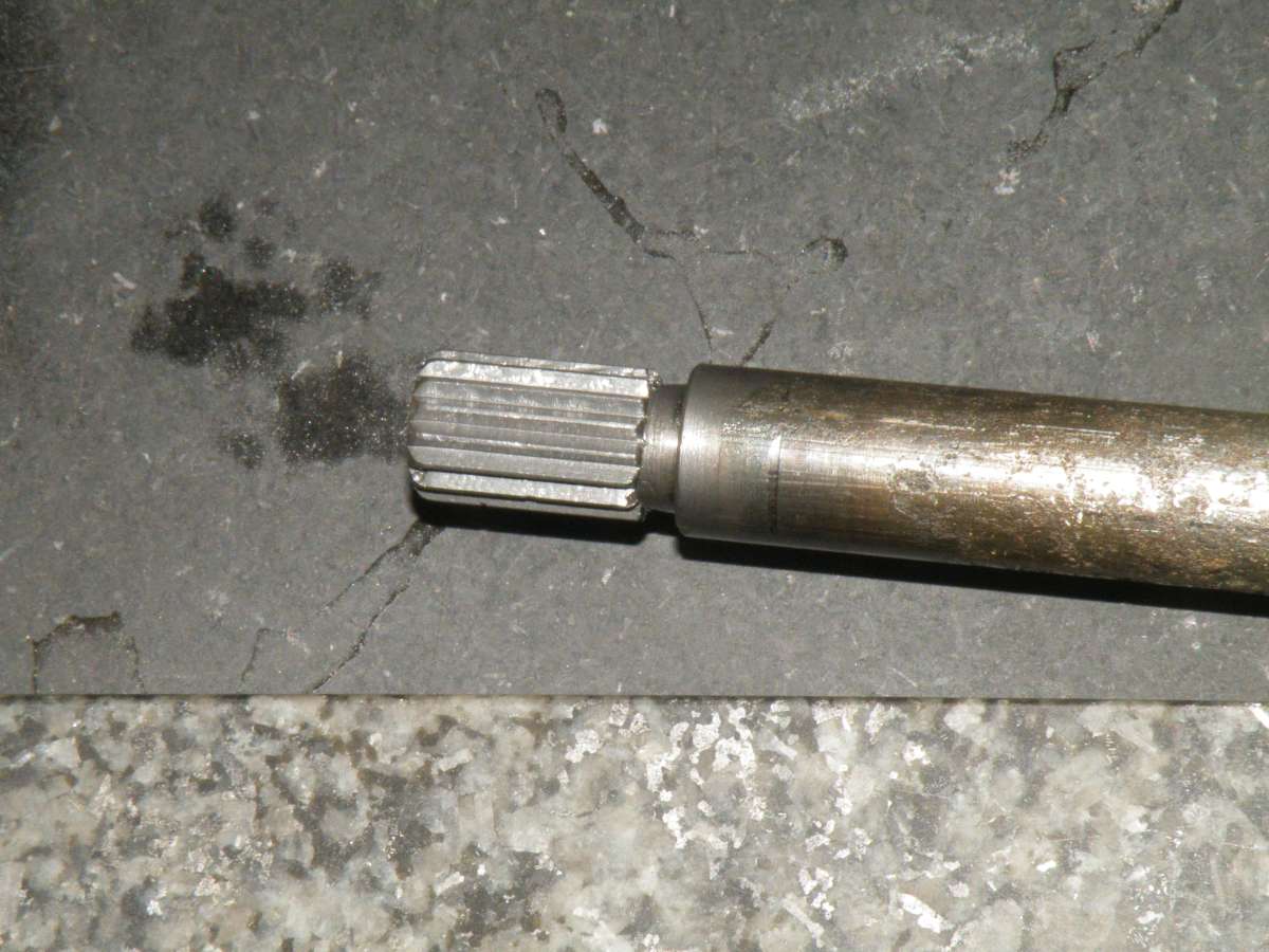

I’ve just found the pictures of my fix for the first of the five splines I restored. No commentary, the pictures tell the story:-
My next job will be to fit these.

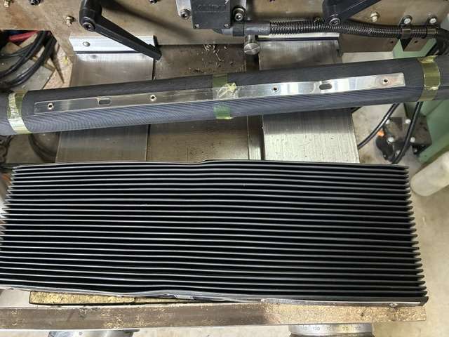

Those look good. I used silicone baking mats from Amazon, which aren’t concertina’ed but are readily available and cheap.

On 12 June 2026 at 21:50 Mark Rand Said: I’ve just found the pictures of my fix for the first of the five splines I restored. No commentary, the pictures tell the story:-
Just looked at my post above and the pictures seem to be missing. Trying again:-
Hopefully that worked.
