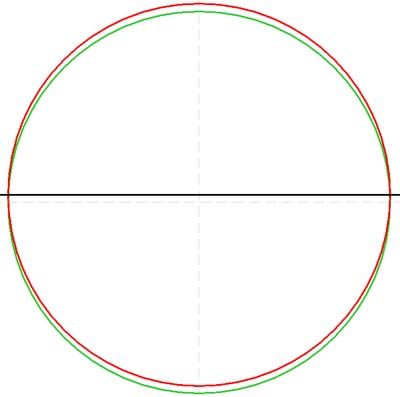

                The error is very much dependant on the dia being turned
                eg on a 3mm shaft a 0.1mm height error gives about the same diameter error but a 0.2mm height error gives a 0.3mm diameter error, almost 10% which is maybe a bit more than negligable and it gets progressively worse. In practical terms this would be 10thou play in the fit of an IC engine valves which would have a big effect
                on a 30mm shaft 0.1mm height error gives only 0.001mm on dia and .003mm for the 0.2mm height so these would be considered negligable

                                  I then drew myself a diagram to figure out what difference does 0.1mm vertical error mean to turning a 5mm diameter. The black line represents centre height. The red line represents the bar at the headstock end, the green line represents the bar at the tailstock end and displaced down by 0.1mm. Much to my surprise, but kind of obvious when you draw it, the 0.1 mm height difference at the vertical extremes accounts for a 0.002 mm difference at the horizontal extremes (where the cutting tool is). In short, unless anyone thinks I’ve missed something (entirely possible!), then I’m inclined not to give it any more thought ?
                                  David
                                  David

                                      It looks good enough for 'real world' machining !
                                      Your thorough inspection has highlighted the fact [well known to Dr Schlesinger] that a solid bar sags considerably under its own weight. Schlesinger used test bars cored-out in steps, to reduce the effect.
