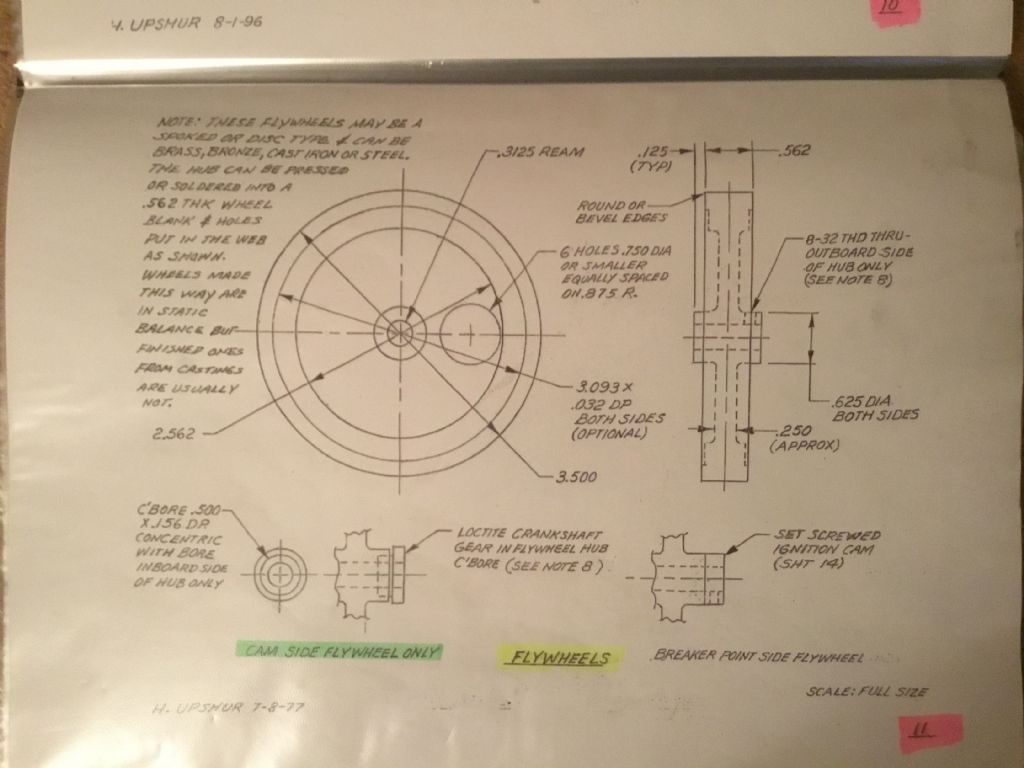

      Hello,
      I once again find myself looking for some advice.
      I am now at the point where I am about to turn the the two flywheels for my little Upshur IC Engine. The plans call for me to turn my cast iron blanks down to 3 1/2” diameter. Each flywheel has to be 0.562” wide with a 0.625” diameter hub protruding 0.125” on each side. My question is, What would be the best method of removing the material between the hub and the outer edge of the flywheel (this has to be reduced to 0.250". The flywheel should end up looking like the flywheel on a Lister D Type
      A friend suggested that I mount each flywheel in a chuck and mill the required material out using a rotary table and an End Mill.
      Any advice would be gratefully appreciated.
      Regards
      Tom

              Hello,
              Sorry Jeff…. I'm a Driving Examiner not an engineer. I thought I'd given enough information. Thank you for your input, here's the plans I'm working from.
              Regards
              Tom

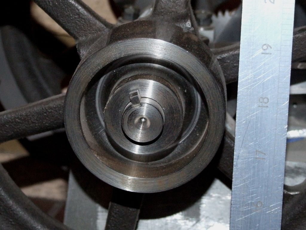

              #314752
                Can be done as I said, that's a 100mm bit of cast iron in the photo much the same as you have to start with. Drill the six holes last.
                This is a pic of a boring bar being used to cut the step in teh rim, move the tool outwards to make the cut.
                Edited By JasonB on 31/08/2017 21:03:32
