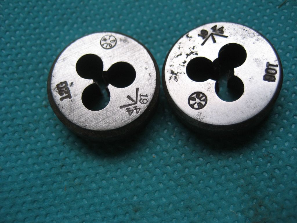

        I inherited a small set of these dies from an old ship engineer's toolbox. I have not seen this type before and suspect the 10G and 12G may have something to do with gas????. What is the significance of the arrow and 1944? Just year of manufacture?
        I'd appreciate any opinions or info from the more experienced members if any can help please.

          That looks like an MOD mark and probably the year?

            Definitely looks like the broad arrow signifying what was then called the War Department'. My Dad was in REME during the war years, so I'm rather familiar with the WD arrow/year stamp.

              Could they be for spokes?

                Very definitely what we called a "Crows Foot" ie WD or now MoD marking & the year of manufacture. Not to sure about the 10G or 12G marking though but dont think it has anything to do with gas. More likely used to cleanup/repair a damaged thread possibly on weapons.

                    The 10G anf 12G are the threads the dies cut., the g means gauge, so they are a 10 gauge and a 12 gauge die.

                                As has been said I think they are for motor cycle or bicyle spoke threads,if they are the very old cut rather than rolled spoke thread they might be 62 teeth per inch which was CEI cycle engineering intertute alternatively they may be the later BSCbritish standard cyle thread and used for cleaning rather than cutting(they would be rolled given a lot stonger thread)and would be 56TPI teeth per inch,

                                      Just to finish out the thread, I checked out the dies and as far as I can see the 8G seems to be 36tpi. It was not easy to see it accurately.
                                      There is a full range of sizes from 8G to 13G in the set with the size decreasing from 8G at c.3mm down to 13G at c.1.5mm.
                                      I compared the thread with that on some old m/cycle spokes. The spokes had a finer 48tpi thread, so it does not look that they were for spokes either.

                                        From Ian Bradley's "Screw Threads and Twist Drills"
                                        British Standard Cycle Threads, for cycle spokes (would be rolled these days with screw OD larger  than the spoke)
                                        SWG TPI Tap Drill No. (Metric Eqv.)
                                        13 56 48 1.95
                                        12 56 44 2.20
                                        11 44 42 2.40
                                        10 40 37 2.65
                                        9 40 31 3.00
                                        8 32 30 3.30
                                        Do these fit?

                                          I checked the dies out properly this time and your specs seem to fit them.
                                          They won't be getting a lot of use I feel, even if I decided to do up another old bike. Most go for new stainless spokes in renovations. So I'm not sure what they could be useful for.
