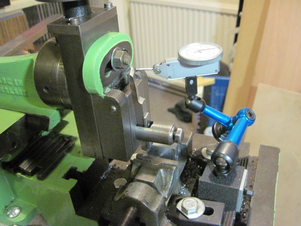

                          Hi all, some 60 years ago during my turning apprenticeship I took my turn through the toolroom working on a shaping machine of truly Victorian style! All of the turners, millers & shaping machine operators had a box of out of calibration gauge blocks & I still have & use mine to this day. A quick check reveals 1 off 3" 20 off 0.2" – 0.95" 50 off 0.05"-0.2" despite having a hard life over all these years a quick random check with a Mitutoyo 0-1" micrometer could not reveal any error as great as 1 tenth of a thou! On a shaper (I have an Acorntools 7&quot if machining a surface with shoulders steps & troughs they are very handy even if it becomes necessary to alter the angle of the tool itself to reestablish tool height with a gentle touch on the appropriate block, I have a shaper gauge which came with the machine.
                          Another useful adjunct (is that a word?) is a 2" length off HSS ground with a chisel edge to stand on block(s) if you still mark out workpieces, ie mark out, clamp in vice, machine down to line, jobs a good un'. It is not necessary to do any of these tasks to a tenth of a thou but more to save that most precious commodity of all, time.

                              Interesting Bob – I also use a "Shaper" Gauge (although I call mine a Transfer gauge). They are certainly very useful for some Shaper operations (I also have an Acorntools 7" ).
                              They can also be handy for other (non Shaper) work but don't seem to be very well known by home machinists. (e.g. gauging gaps, setting up temporary reference points/levels etc). I guess you actually have to have one to find other uses for it? However, I must admit that I try not to use my gauge blocks directly with sharp tooling (perhaps I'm being over cautious? ). I generally prefer to set the gauge from an existing reference point or surface plate ('off-work' ) using a height gauge or mic. I guess that since I've 'calibrated' my larger mics using the blocks – that is an indirect use of them though. smiley
                              Of course, provided the tool isn't disturbed, any finish cut(s) on a sharper can be set very simply just using an indicator and one of those movable arms with a mag base. However, it is sometimes awkward to measure work (without removing it) and the transfer gauge is often handy then (as can also be a depth mic). But maybe I should find more uses for my 'precious' blocks too….

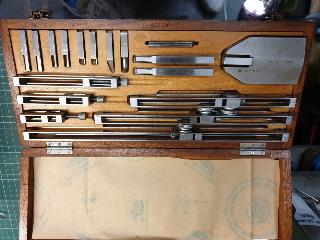

                                                      A slight aside, I have been given a lovely set of imperial slips but a couple are missing. Does anyone know if Is there are folks that breaks sets to sell the individual ones?
