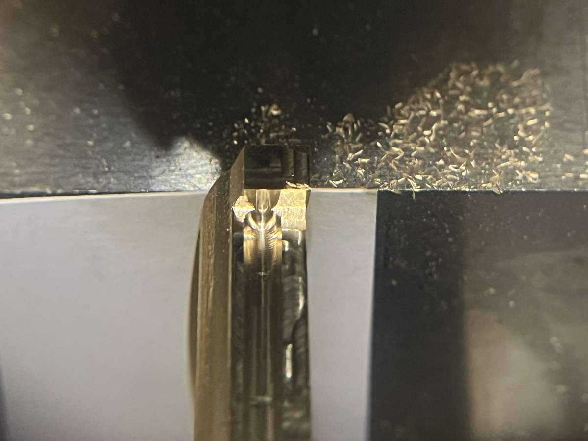

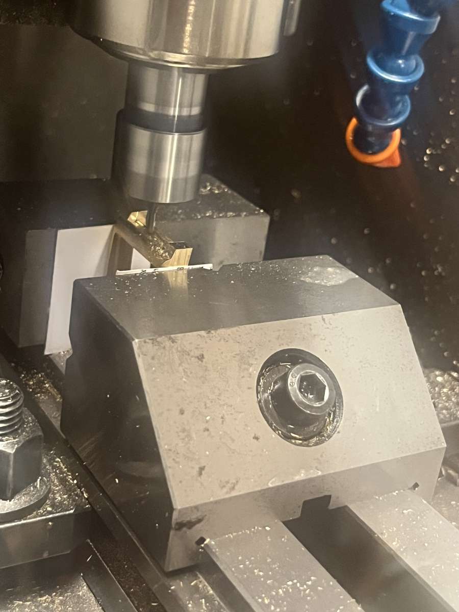

        This video:
        https://youtube.com/shorts/FqcsI3eQcUE?feature=shared
        shows the cutting of the round bottom groove that the 3D print helped me spot was not machinable.
        And this shows how hard it is to take a pic of a shiny hemispherical hole:
        IMG_7776

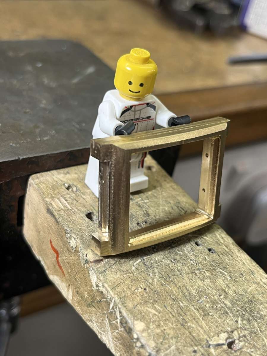

        and then there were a couple of holes to drill:
        https://youtube.com/shorts/ywIbX4VPhe4?feature=shared
        Ive written code to generate peck cycles in a previous job, but this is my first go with fusion. seemed to work ok – no drills were broken 🙂
        That’s pretty much the case done.
        IMG_7787
        It needs a cleanup and a bit of deburring, then no doubt countless hours to obtain a mirror polish.

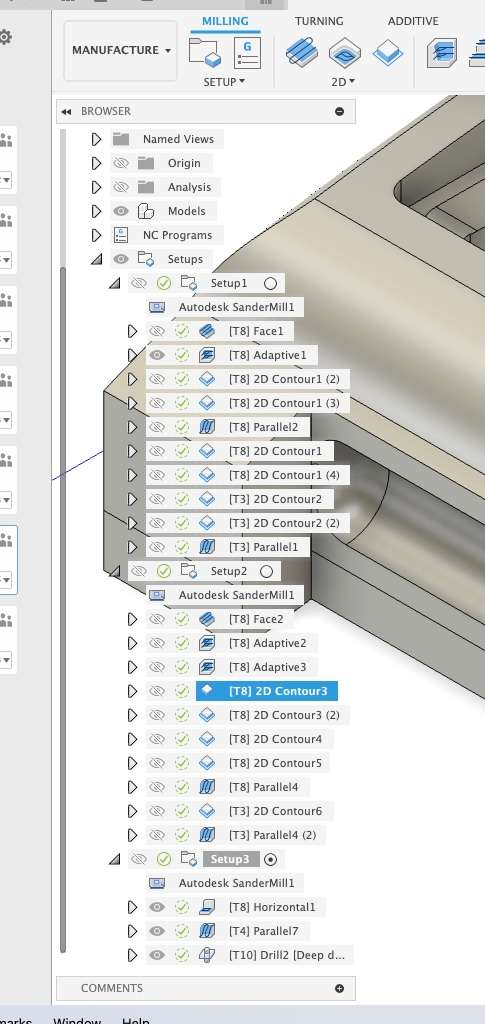

          Dave – as you are using the free version of F360 (as I understand it), are you having any issues with the restrictions in it? I’m thinking of only one tool per setup, and loss of rapid feeds within a toolpath. The first one is not too difficult to work around but the second one I found very frustrating as it can add quite a lot of time to a cut. I actually use a free add-in which pretty much gets round these. I have an automatic tool height gauge so use manual toolchange but automatic tool-length calibration on each tool change. The add-in also fiddles with various G0/G1 lines of code to speed up tool-return movements. Just interested in comparing notes.

            Although I often use the top of the stock as my Datum if a job needs that to be removed I will try and find another point or you can even measure the height of the stock above say the vice and then set your tool to the vice but enter that difference rather than zero. Another option with a lot of spare stock would have been to leave a small “post” in the waste material and use that for height setting, easily added as part of the design by just drawing and extruding a circle.
            Regarding using free F360 I tend to do as much metal removal as possible using adaptive cuts. With those you can set the “non engaged” speed higher than the feed so if I’m feeding at 500mm/min I will set the non engaged to 1000mm/min and the tool moves back to the start of the next cut at 1000mm which is similar to what the rapids are set at. You can also play with stay down distance and percentages which reduces the amount of time the tool has to lift and drop back down. Two way cutting also reduces rapid moves but I find the machine sounds a lot better climb cutting so tend to just select that.
            For things like drilling then reducing the feed height from the default 5mm and setting a faster retract speed will save run time as the tool is not moving as much when not cutting so less time at the slower feed rate.

                Ive not (yet?) had any problems with the hobbbiest restrictions. Im not sure why you think you can only put one tool in a setup:
                Screenshot 2025-09-25 at 12.03.17
                I only post 1 tool per file, but that’s part of how my machine process is – I don’t have a changer, so tool changes are manual. I prefer the machine not to be halfway through a file when I do that.
                As fo rapids – as Jason said my clearing is using the Adaptive tool path, so the tool mostly stays down anyway. I don’t think rapids loses me much time – the size of the parts is small, so the travel time difference from one end to the other isn’t huge.
