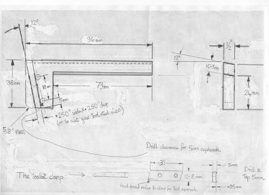

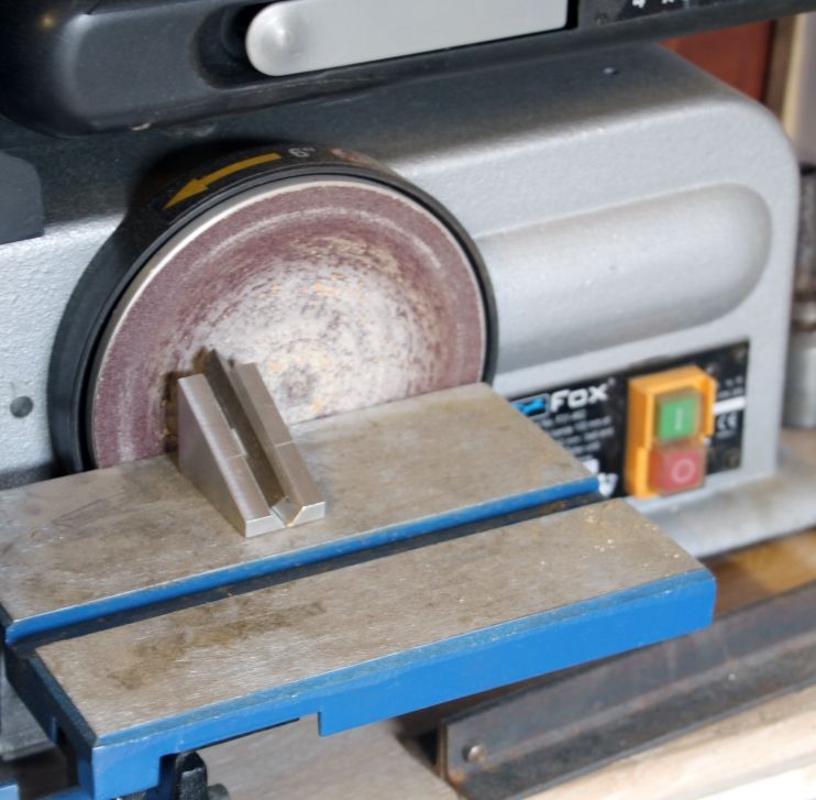

                              Kenneth and Alan have asked me for more details about my version of the diamond tangential tool. Please bear in mind that this version of the tool has been made for MY lathe – a WARCO 250 family fitted with a WARCO QCTP.
                              I have just been up the workshop and offered it up to the standard tool post that WARCO supply. It may work on this but it is so close that a combination of a little more clamp thinning (the curvy bits at the end nearest the tool bit) and a reduction of the shank thickness (the underneath bit) may be necessary. Sorry I cannot be more specific but as I have no intention of using it with the fixed tool post further investigtions have come hard up against the buffers. (I can't be bovverd!).
                              Have included a not very special pic showing how I determine if I have enough clearance to prevent "clamp rubbing" something to be avoided (even talcum powder won't help you here!setup tan tool.jpgtipex delight.jpg

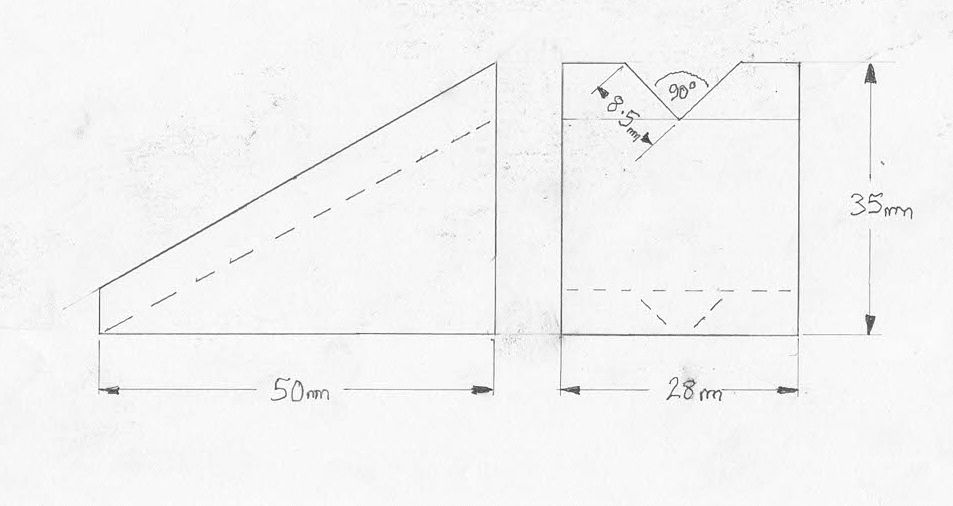

                                Thanks, Give me a couple of days and I will draw a nice CAD drawing and upload it. Can you make a sketch of the sharpening fixture.

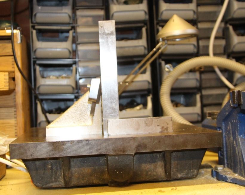

                                  Hello Kenneth – Sketch as requested.sharpening fixture.jpgand I use this to sharpen. I don't find a guide necessary.sharpen fixture.jpg
                                  #125393
                                  Rik Shaw
                                    @rikshaw
                                    Kenneth – Sorry but I left an angle of the sharpening fixture. The "v" shaped groove that holds the tool is 30 degrees from the horizontal. — Rik

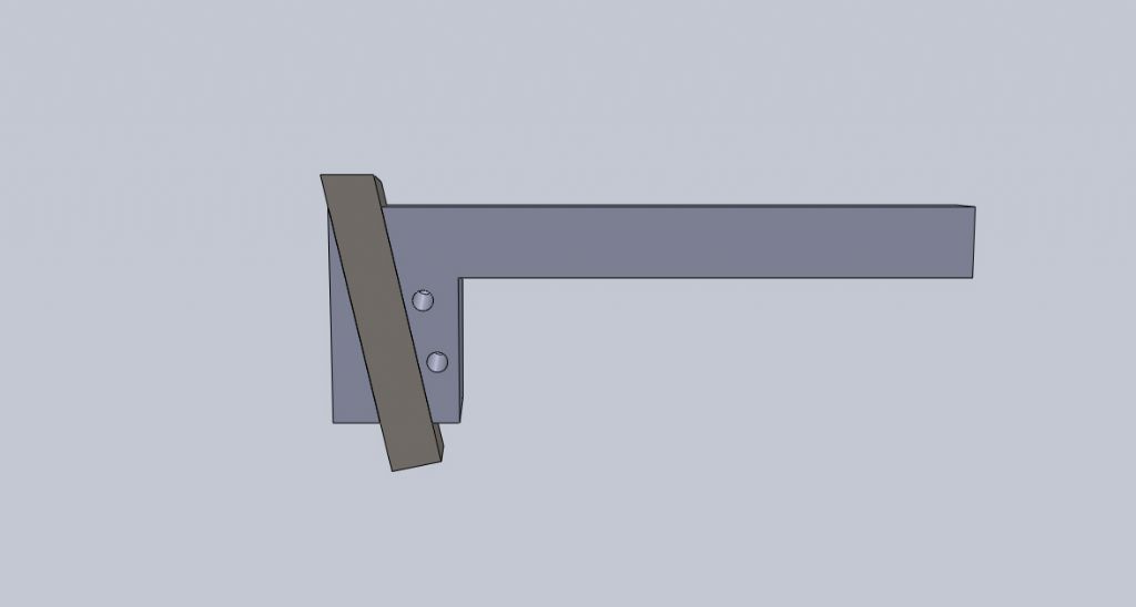

                                      This is how the holder come out. I am using Solidworks

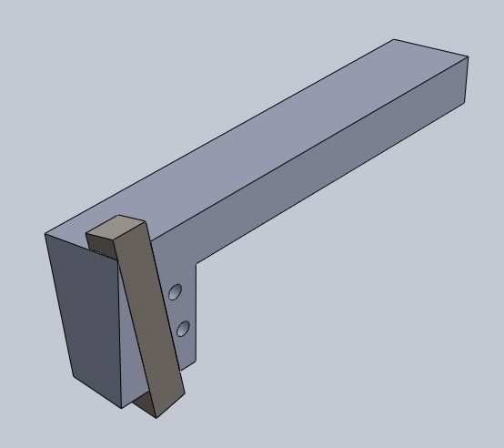

                                      Kenneth Lindeman
                                        @kennethlindeman32408
                                        Front and left view. If the design looks ok I will upload drawings with dimensions

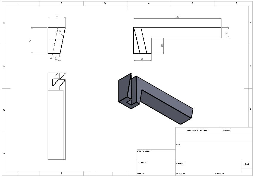

                                            #125400
                                            Kenneth Lindeman
                                              Please have a look and see if there are any mistakes. I will add the clamp and screw details tonight. Any ideas as to what would be the easiest way to make this holder. I was thinking with starting with a piece os 30x20x100mm (1 1/4 x 3/4 x 4 inch) bar material to start with

                                                    Kenneth – I sawed the blank for the original from a length of 1.5" x 0.5" bar. The 0.5" thickness was not reduced in any way unlike your drawing which shows one side machined at an angle. I chain drilled the basic elongated "L" shape and then hack sawed the shape out.
                                                    If you look at my second post on this thread have a gander at the third photo. This clearly shows that the shank is machined as a parallelogram. It is the 12 degree angles incorporated in this parallelogram that cants the tool over to give the tool bit its sideways 12 degree attack angle unlike your drawing.
                                                    Aside from that, your 20mm should be 23mm and your 30mm should be 38mm. The latter dimension is particularly critical given the clamp dimensions which I have detailed.
                                                    And nit picking here, your drawing shows the clamp screw holes to far away from the tool bit slot. These need to be as near to the slot as possible without breaking through to allow the clamp to bite on the tool bit as near to the longitudinal centre line of the tool bit as is possible.
                                                    Hope this helps.
