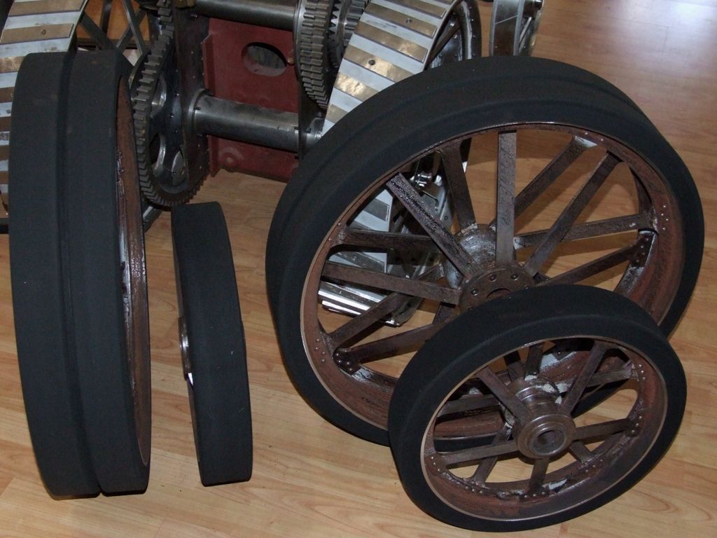

            Regarding the tasks mentioned above I now have the wheels for my traction engine complete with rubber tyres:
            I'm very pleased with the rubber tyres, less so with the rust from the vulcanisation process. I've got rid of a lot of it with wire wheels and a drill. But I've also bought a cheap blast gun and some garnet grit to get rid of the rest.

                              Hi Andrew, your rubber tyres look really good and the wheels are good also.
